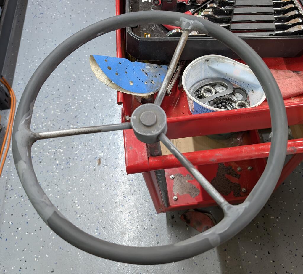

Dave D.

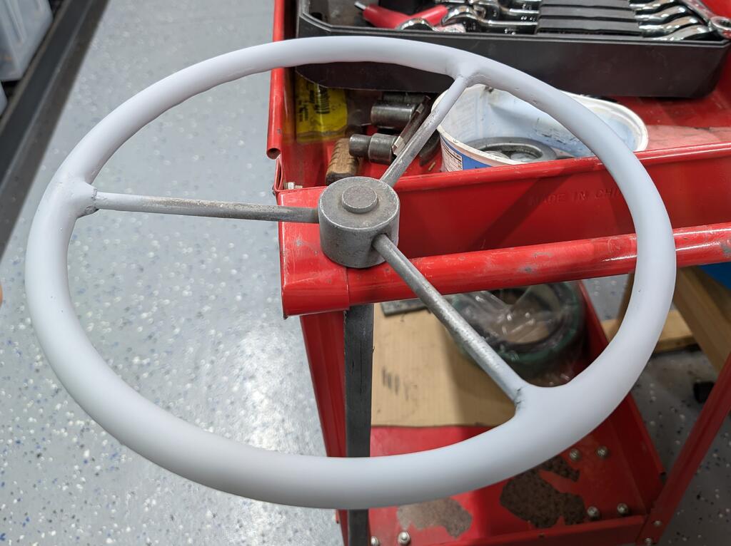

A little work this evening. Worked on the steering wheel. Bed liner all stripped off. More PC-7 and sanded. Now it's primed in and just need spot putty in a few places.
Now primed in. Just a little more finessing, then painting.

wallfish
VERY nice!  Steering wheel restoration like that takes a lot of work and time and it looks real nice..
Since you are going through all that work to make it perfect, you should trim off, or grind off that protruding shaft above the collar in the center of the wheel before painting it. I've never seen a factory steering wheel with the 3/4" shaft protruding above that collar. They set them ALL flat
Just  my :twocents-02cents:
  • Like 1

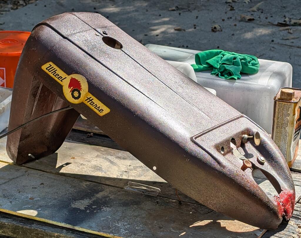

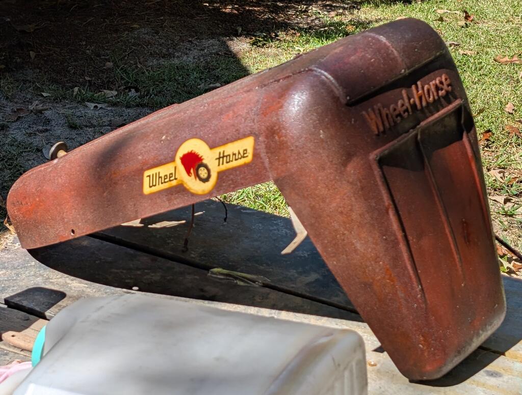

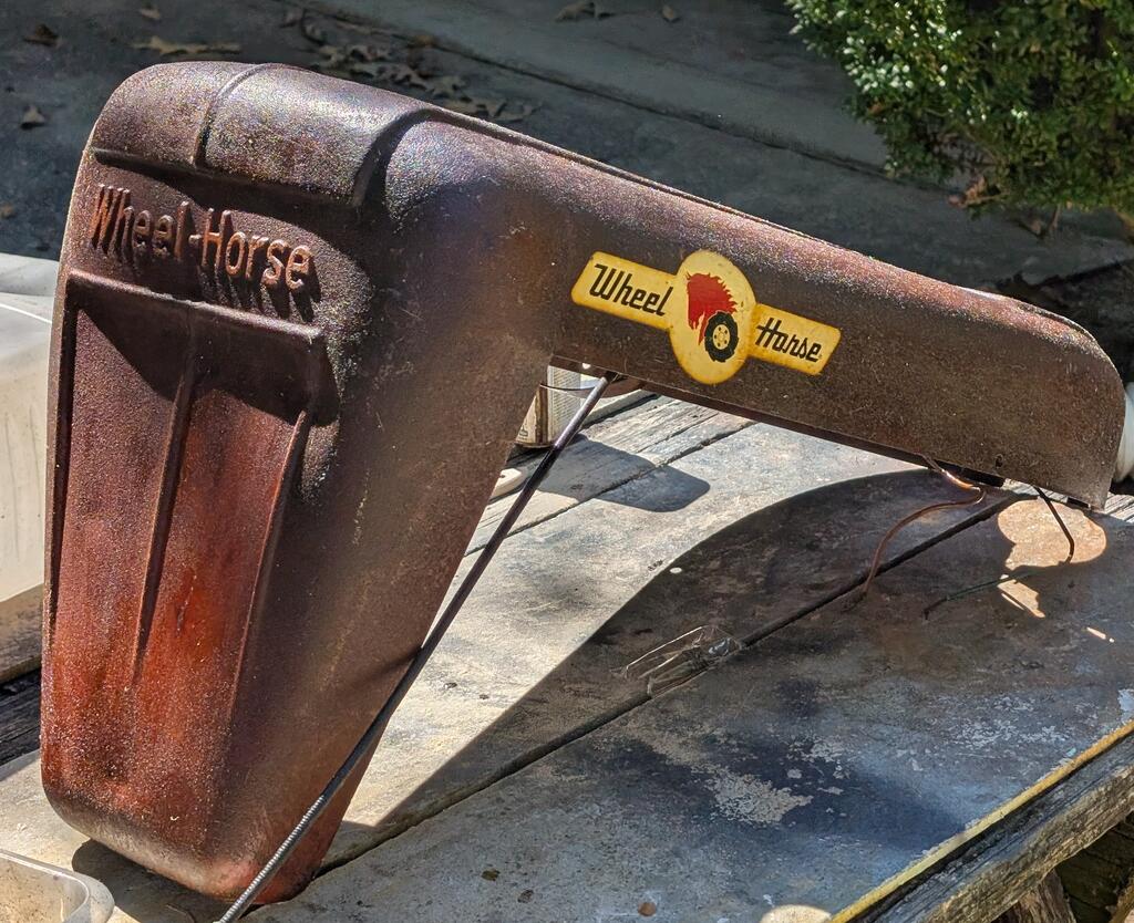

Dave D.
Worked on the hood today. Coated it with Penetrol. Starting to look better.
Got to add some metal where they cut it to get the hood off, but looking better.

Dave D.
Worked some this week on the 551 among other projects.
963169564_SteeringWheelDone.jpg.a52db4a14075978305930ab04d1838dd.jpgSteering wheel is done.

702854boy
Very well done on that steering wheel
  • Like 1
Dave D.
Added on to the shop last Fall. Got the wood shop and one side is my wife's side for doing crafts.
She would be working on her stuff, and I'd be sanding the steering wheel. She would say, "You still sanding on that steering wheel?" Now she says, "That looks Good!" I spent a lot of hours making it round again. Ended up using SEM Color Coat Satin Black flexible paint on the steering wheel. Also used Rustoleum filler primer and Rustoleum adhesion promoter, so I hope the paint will stay on the steering wheel. Trying to get something that will last. Cleaning off an old table to start on the transmission. Going to make a stand with 4X4 leftovers to hold the transmission for disassembly. Got to get a replacement pump for my parts washer. I'm making good progress. The old Ariens tractor is back together, and I need to change the transmission oil and filter and fix the wiring. Then I can move that tractor out and work on this one. For now, I'll just take the transmission out and leave the tractor in the shipping container. Spending a lot of time researching old posts and getting information. Project is coming along.
