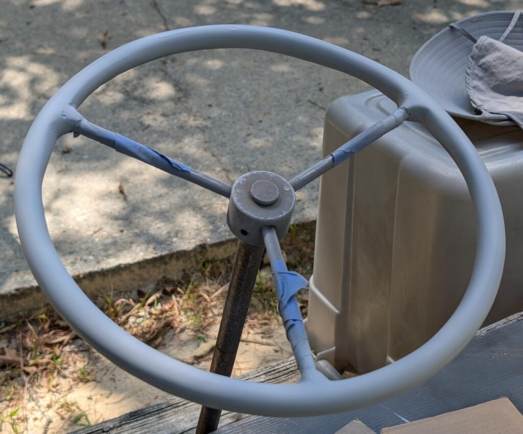

Worked on the Suburban 551 steering wheel today. All sanded and now primed in. Next will be the bed liner spayed on it.
Looking better all the time.
Tomorrow, I'll put on the Rust Oleum bed liner.

Tractor in storage has had the diesel fuel in the trans for a week now. Steering wheel bed liner spray experiment didn't work so well. It clumped up and looked cracked. Sanding it back down and will use automotive urethane paint on it. got the steering bevel gear and the dog point screws. Getting cooler, now to get more done on this tractor. Need to get the steering box back in on the Ariens S16H and then back on this Suburban.

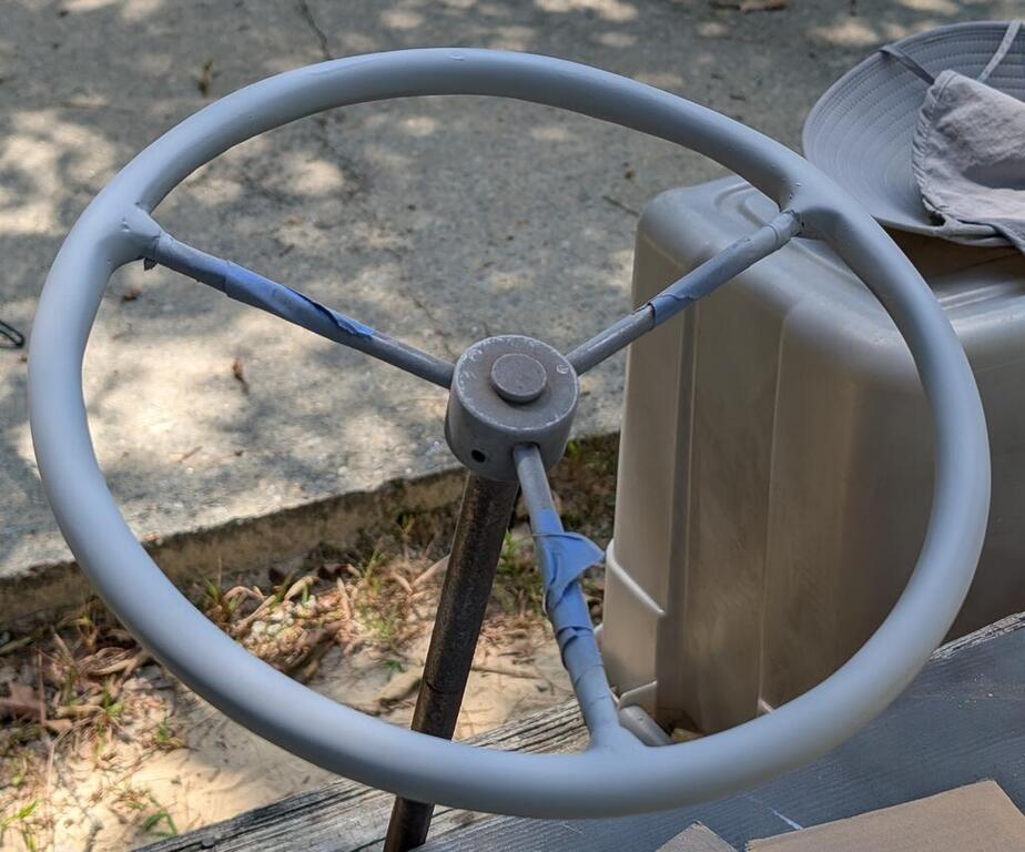

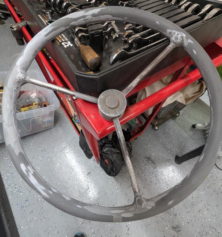

Worked today on removing the bed liner from the steering wheel. The parts that went on right were fine, but some of it was clumpy and cracked up. Looking better now. Needs another coat of primer.
I wish I was paid by the hour for all the sanding on this old steering wheel.
Lots of time spent re-shaping it.

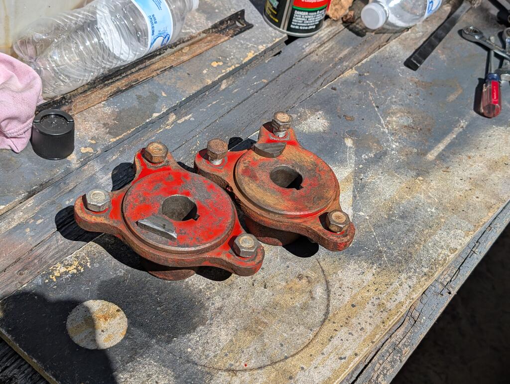

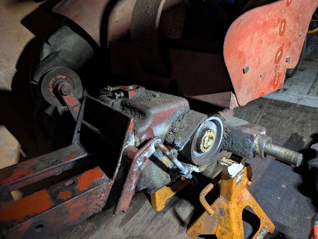

Took a little time to get the transmission ready for tear down today.
Pulled wheel hubs and cleaned them up and chased all the threads. Soaking the brake lever and bolts in some PB Blast.
Getting this little tractor ready to get out of the container and start the rebuild.
Hubs came off pretty easily. Used the puller on one, the other just slid off with a prybar after removing the retaining bolt.

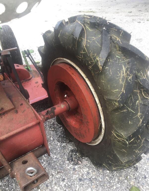

Blaine
Great project. I’d love to add a 551 to my collection.

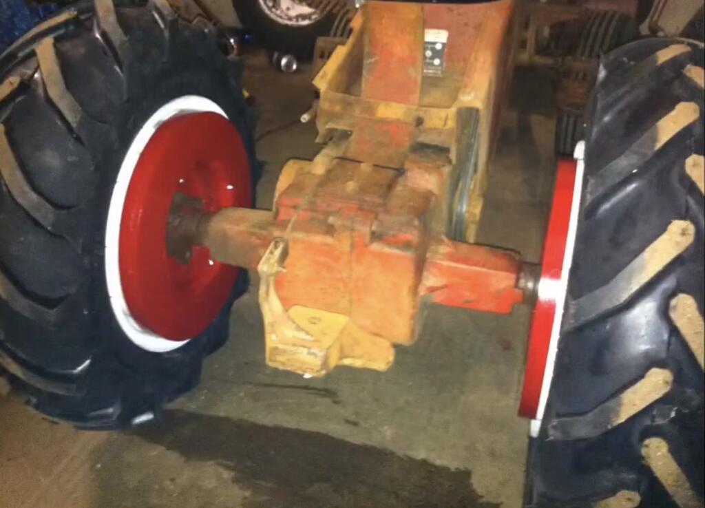

 I made a pair of weights similar to those for my 401. Ford Taurus rotors with the vents filled with molten lead, then machined the outer edge smooth on the brake lathe for a finished look. Bolted to the wheel with 2 bolts, then sandwiched between the hub and wheel. They’re around 25 pounds each.
  • Like 1
  • Excellent 3
Blaine
Back when they were minty fresh on my 702, tires are “foam” filled also, so traction is never an issue.
  • Like 2
  • Excellent 1

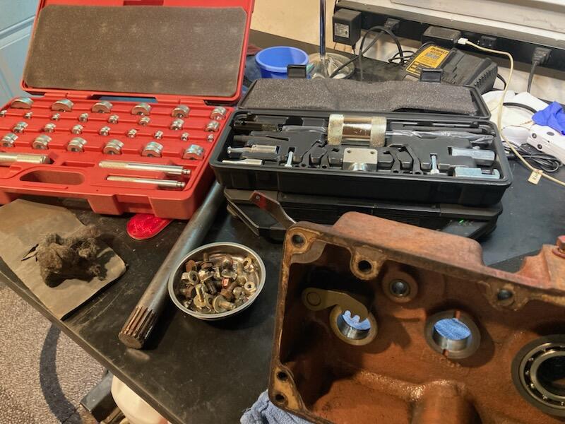

I get by with this slide hammer and bushing driver set. If I had a bigger shop I would prefer to have a press but that isn't happening.
  • Like 2
