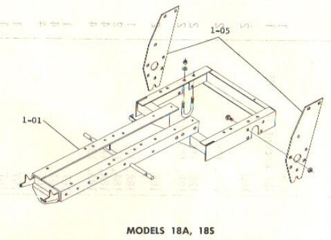

gwest_ca-(File Mod) 12,508 #6 Posted September 5 I think using the tractor frame is what was intended. Posting this so others see what you are dealing with. The blades at the time came in two packages. The blade model 6-9622 and the completing package 6-4113. Both manuals make no mention of this application. 1 Share this post Link to post Share on other sites

larryk1 5 #9 Posted September 5 Yes I have been over the manuals for the blade and you're right nobody mentions the 800 special. I guess it's too much of an odd duck. I'm gonna put the lock levers right on the tractor frame and I'm sure the blade acquired will work. Too many blades and too many tractors. But hey that's what makes the world go round. Ha ha Share this post Link to post Share on other sites
