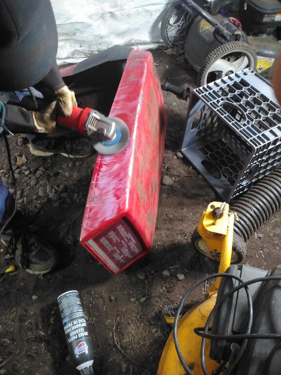

Jeremy J 7 #7 Posted September 4 I'm going to find the serial numbers. I'm working with my 2 teenage boys on it. 15 &17 years old. They are pretty good welders and already fixed the lift arm assembly that was broken off. And they wire wheeled the thing down and repaired the foot rest that was broken into 3 pieces. It still needs a lot of help, but it's been a nice project. 2 1 2 Share this post Link to post Share on other sites
