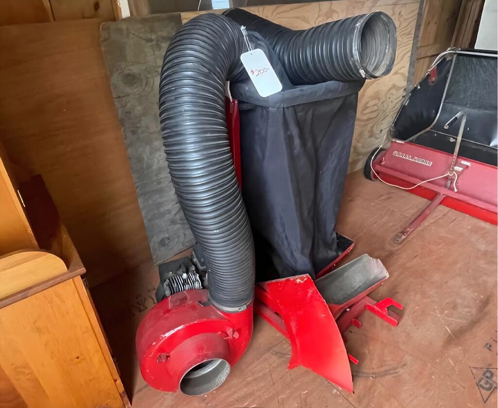

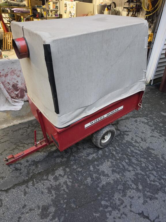

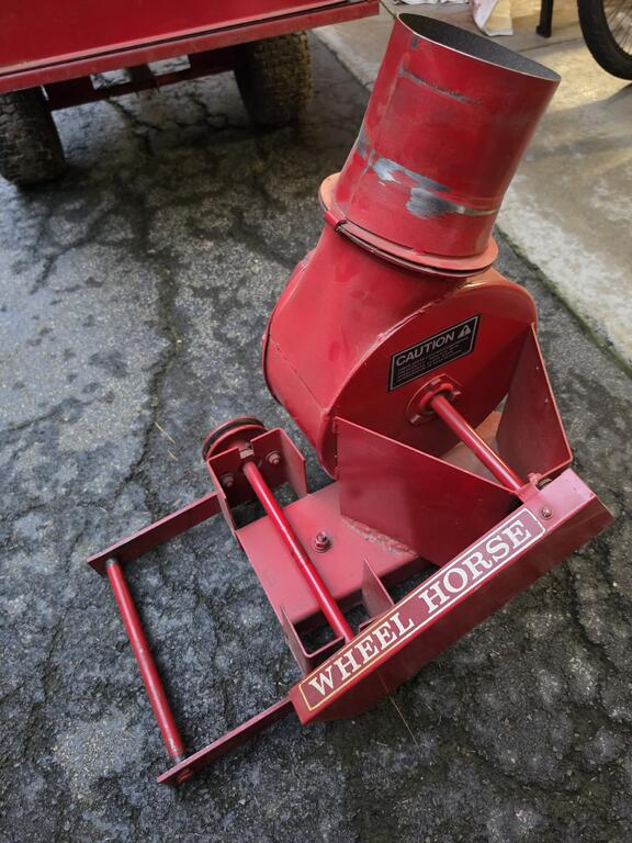

Brooklyn581 30 #1 Posted 7 hours ago How can I attach this to my Electro Charger 12? Found on Market Place and it seems to be complete and well maintained. No model numbers. Might be for a later model Horse but Im trying to adapt it. At the same time I also bought the wheelhorse cart with canvas and rear mounted blower that is belt driven all like new that I may want to take the motor from the 1st mulcher and adapt to that trailer. Open to suggestions. If I could find the front mount blower for my older style long frame that would be a big win too but leaf season is close and I now need to make something from what I have. Share this post Link to post Share on other sites

c-series don 12,334 #4 Posted 5 hours ago The first unit is made by Peco. You may find more information online about the mounting system for a WH. The second on is obviously WH but you will need the rear axle bracket and the pulleys that bolt under the fender pan. Also to be on the safe side, the proper belt guard and foot rest. All of this is probably covered in the manual that @gwest_ca posted for you. I’m just going by memory. Share this post Link to post Share on other sites
