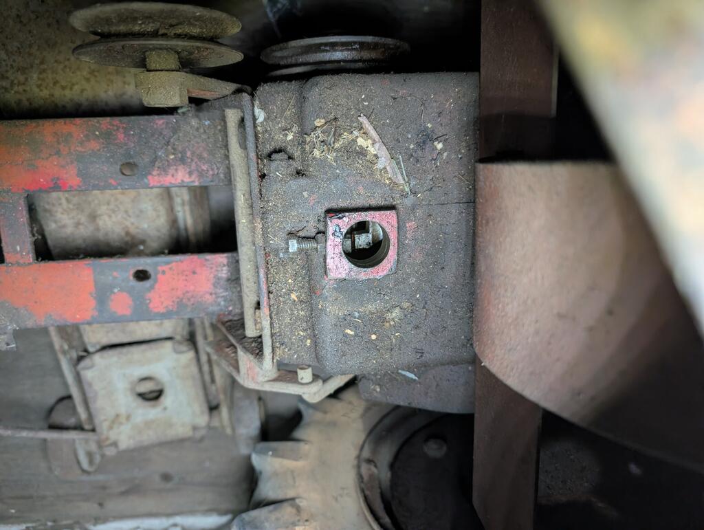

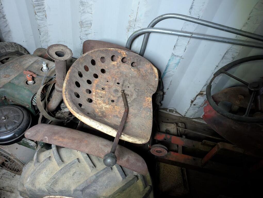

On the Suburban 551 I saved, the gear stick just comes out.
Missing the shift collar. Looks to be part number 3514 maybe with a roll pin?
Are these available?
The 551 has a 2 piece 3007 trans. Is there a kit available for the refresh?
Thanks.
Dave
rmaynard
It may have come off in the tranny. Take picture down into the shifter hole, and let's see what's in there. Is the dog-point set screw still there?

Retaining screw appears to still be there. I don't see any evidence of it being welded in the past. From the parts manual it looks like it used a roll pin to hold it in.
Thanks,
Dave

Your trans is a 5007...not a 3007 !!  Any Wheel Horse shifter will work...yours has a bend about 2 or 3" up.  Contact on of our vendors for a replacement...like A to Z.  :occasion-xmas:  One of our members may even have one and offer it here.  :orcs-cheers:
Looking at the above picture, I would guess you are in 1st gear.:confusion-confused:
