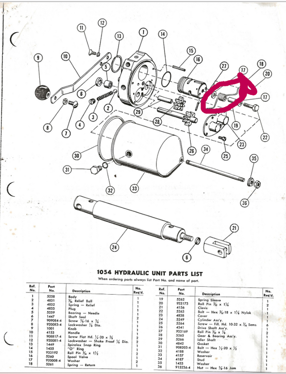

For some time now I have needed to manually move the hydraulic lift lever back to neutral. I know there are rebuild kits available. So now that I have the unit on the bench (for a different issue) would you recommend diving into the pump? Is it a complicated process? Should I leave well-enough-alone?988904407_WheelHorse1054withModelA4CCWHHydraulicPump02.PNG.ff7f3fc3740fe62dfab59d848634e4aa.PNG
ri702bill
It is not a big deal to change. I believe Lowell has the Spring & gaskets...

Achto
Advise when pulling the pump apart.
1 - The cylinder "#16 in the diagram" has a slight taper to it and has to slide in to be removed.
2 - If you need to remove the belt pulley, DO NOT tap on the shaft with a hammer. You WILL damage the pump gears.
If you note these two things, a rebuild is pretty easy.

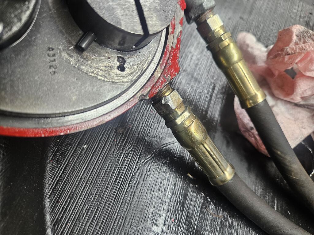

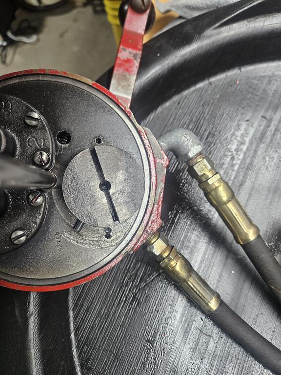

OK...I definitely have the 953 style (horseshoe shaped spring) pump on my 1054. Although there is some gouging of the head I am more concerned about the second "mystery" hole on one side of the spool valve.

This is the exact type of damage I was referring to.
The "mystery hole" looks like the spring broke some time ago, the owner at the time was unable to remove the broken section of spring, and and just made a new hole.

1054 Project
Would you advise "filling in" the unwanted hole? If I put the new spring in will I have to be worried that it will migrate over to the adjacent hole?
adsm08
I'm not really sure on that one.
I have had no luck filling them in because the metal becomes so saturated with the hydraulic fluid nothing will stick to it, and welding will warp it. I've also never worked with one that has been redrilled like that.
WHX??
I had one where the spring was broke off flush with the hole and there was no getting it out so yes just a new hole next to it. Just make sure the holes are clean and the new spring legs seat down to the bottom.
1054 Project
New spring on order. Question...is that roll pin supposed to be extended like it is in the picture? Could that have broken the spring?
WHX??
I do believe it is supposed to be like that. If I remember right it's the stop for the lever motion. It hits  the leg of the spring  Guessing if a guy really lays on the lever it can break the spring. possibly shearing it off at the hole.
adsm08
Yes.
8 hours ago, WHX?? said:
I do believe it is supposed to be like that.If I remember right it's the stop for the lever motion. It hits  the leg of the spring  Guessing if a guy really lays on the lever it can break the spring. possibly shearing it off at the hole.
Yes, yes, and yes.
