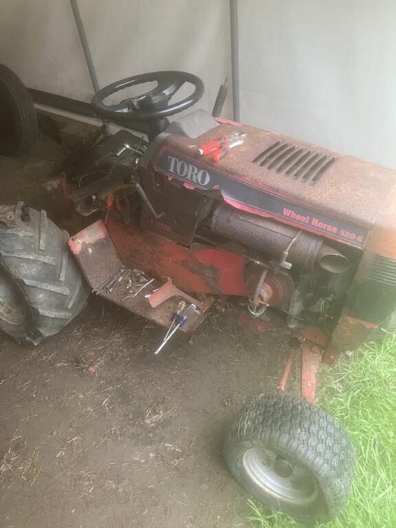

after flushing the tank a new filter and cleaning carb 5 times and finding no vacuum leakes . I started the tractor and it ran smooth, i then took the tractor for a test ride and then it started surging. What else could cause this?

On my 520H it was the 2 piece intake manifold. It was leaking where it goes together causing it to suck air and would surge. You have to take manifold off to fix right, not too bad of a job but isn't to fun either. May as well decarb, adjust valves, etc etc. why you have it tore apart that far also.

You cleaned the carb 5 times to stop the surging and it ran smooth.   I suspect a speck of dirt found its way to the carb again.    Replace all old fuel lines and clean the carb again.

I didn't see this when I replied earlier about the 2 piece manifold :D. Mine was easy to diagnose because when I removed manifold then took carb off to rebuild the manifold came apart in my hands.:bitch:

Your carburetor has a weich plug just above the idle mixture screw, if you remove it you may find dirt in the tiny passages in there.  To remove the plug, drill a small hole in the center being careful to not go in beyond the plug, then pry it out.  Use an aluminum 3/8" plug to reseal.

Tanks guys, after cleaning the carb for the seventh time I must have finally got it clean. This ugly girl runs good now.

She ain't ugly. She's just well seasoned. :lol: Looks to have been rode hard and put up wet a few times.
Glad you got it figured out. Those Onan engines can get quirky until you get used to them.
