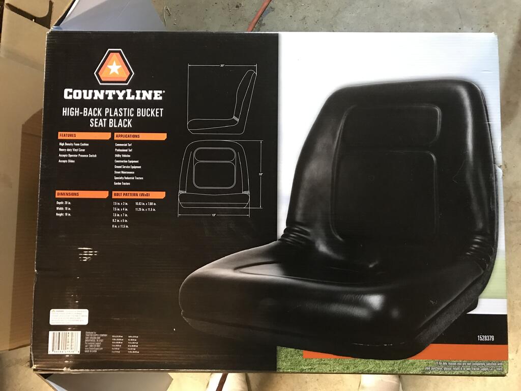

hotajax 283 #1 Posted 3 hours ago I remember one of you gents told me you bot a seat from TS, and it bolted right on. I can't remember who the member was, but the dealer was definitely Tractor Supply. If you can remember some details about the seat, I'd be appreciative. Thanks. Share this post Link to post Share on other sites

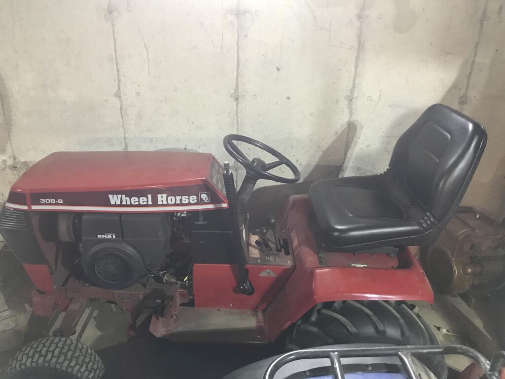

MainelyWheelhorse 3,017 #2 Posted 2 hours ago (edited) I have a TS seat on my 308 it was a direct bolt on affair. One of the pre drilled bolt patterns in the seat bottom is the 7.5 x 7 Wheel Horse seat bolt pattern. I’d assume the others in that brand have the same pattern built in. It’s a bit expensive but I haven’t had an issue with the seat. Edited 2 hours ago by MainelyWheelhorse 1 Share this post Link to post Share on other sites
hotajax 283 #3 Posted 11 minutes ago 2 hours ago, MainelyWheelhorse said: I have a TS seat on my 308 it was a direct bolt on affair. One of the pre drilled bolt patterns in the seat bottom is the 7.5 x 7 Wheel Horse seat bolt pattern. I’d assume the others in that brand have the same pattern built in. It’s a bit expensive but I haven’t had an issue with the seat. Thanks for putting this up there. Do you have any issues swinging your leg over the higher back? Share this post Link to post Share on other sites
