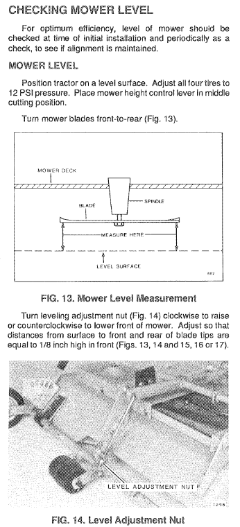

An interesting thing about the 42" is the 1/8" high in front per the manual.  I make mine level.  Here is the manual:

sqrlgtr
@lynnmor thanks for posting that manual I knew I had seen that somewhere before but forgot where and thought I was going crazy.:wacko:
