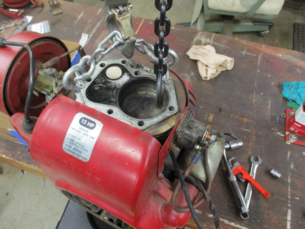

pfrederi 21,342 #1 Posted August 25 Loaned a Charger 12 to my nephew a year and half ago. Came home yesterday piston does not go up and down any more. He didn't hear anything. Guess I have a new project. Got the engine off the tractor draining, it no glittery stuff in the oil. Will be interesting to see inside. 1 8 Share this post Link to post Share on other sites

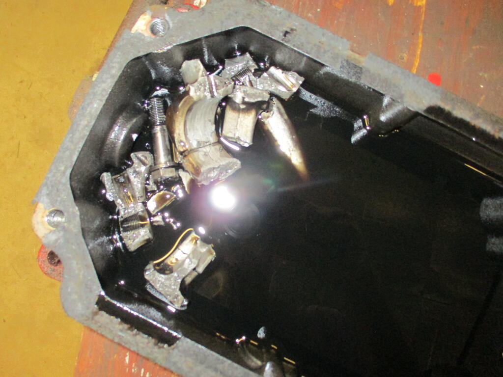

squonk 48,427 #2 Posted August 25 (edited) Rod broke about an inch under the wrist pin. Edited August 25 by squonk 2 Share this post Link to post Share on other sites
ebinmaine 81,278 #3 Posted August 25 1 hour ago, pfrederi said: piston does not go up and down any more. Can you push it by hand or hammer? Share this post Link to post Share on other sites

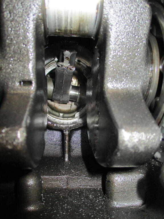

pfrederi 21,342 #7 Posted August 26 Piston was TDC when I opened it and engine spun freely. I pushed it down now things don't move. No vents in the block tonight should be able to flip it over take the oil pan off and look at the damage Valves are working 1 Share this post Link to post Share on other sites

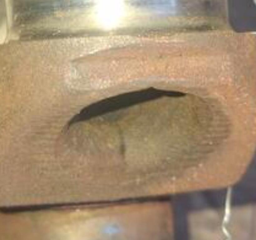

pfrederi 21,342 #8 Posted August 27 Good news no holes in the block Small chunk chipped out of cylinder end Obviously oil related failure. Now do I blame nephew?? How long would an engine have to run to get this bad. I got her in 2016 and she was on snow plow duty then went to my brother also some snow pow duty (2019). Came home to me after 4 years when my brother went to long term care. He didn't use it much and I used to make sure there was oil in it when I visited...But don't think it was changed very often. Nephew got it in spring 2025 mowed half acre that year and this year up until late June. He say he didn't hear anything. Sorry but I don't like it when a machine breaks because of an oil issue... 2 5 Share this post Link to post Share on other sites
Handy Don 17,735 #9 Posted August 27 I’ve seen two B&S engines with oil pumps fail from low oil. Years apart, but both were mowing sideways on sloped lawns so probably the oil intakes lost contact with the low oil in the sump. My guess in both cases is that from the point where the oil level stopped providing adequate lubrication until part seizure was a minute or so. In both cases I saw, the engines had been running around 10 minutes from startup but had transitioned from level to slope only a minute or so before seizing. 3 Share this post Link to post Share on other sites

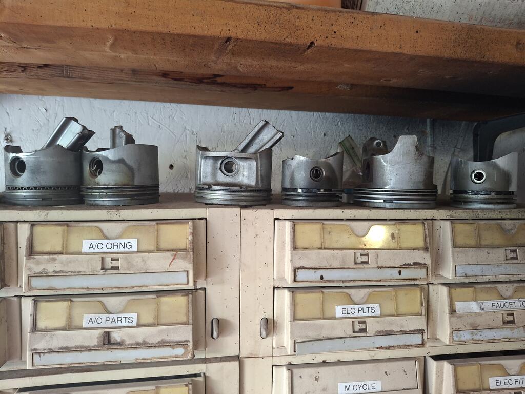

squonk 48,427 #10 Posted August 27 My "Shelf of Shame." 4 1 2 Share this post Link to post Share on other sites
adsm08 5,247 #11 Posted August 28 8 hours ago, pfrederi said: Good news no holes in the block Small chunk chipped out of cylinder end Obviously oil related failure. Now do I blame nephew?? How long would an engine have to run to get this bad. I got her in 2016 and she was on snow plow duty then went to my brother also some snow pow duty (2019). Came home to me after 4 years when my brother went to long term care. He didn't use it much and I used to make sure there was oil in it when I visited...But don't think it was changed very often. Nephew got it in spring 2025 mowed half acre that year and this year up until late June. He say he didn't hear anything. Sorry but I don't like it when a machine breaks because of an oil issue... My first k181 did this. I knew it used oil, but it had been about 1/4 qt across the whole of the summer. It apparently got much worse very quickly. I had it running to warm the oil before a change and had to go deal with some kid thing. It sounded 100% normal when I walked away. The guy across the street said he heard a loud pop, and then it shut off. 2 Share this post Link to post Share on other sites

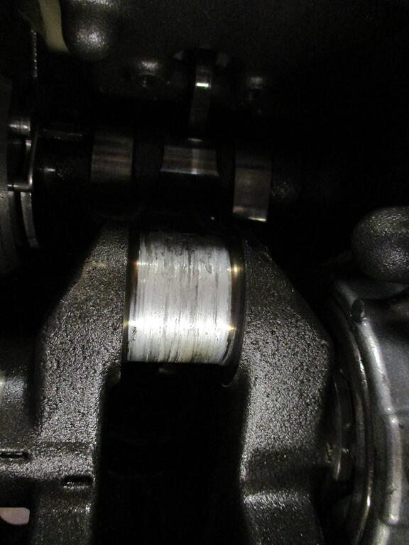

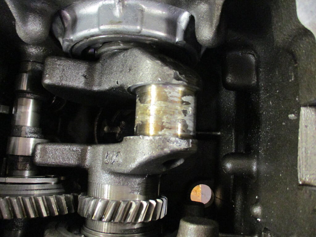

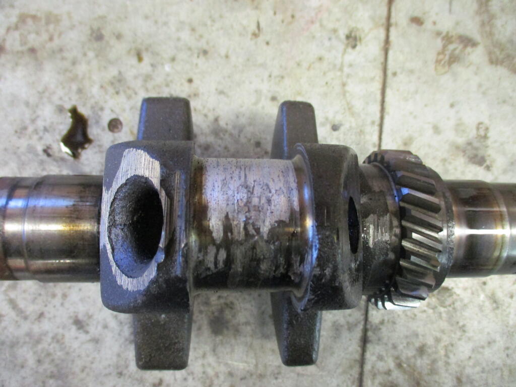

pfrederi 21,342 #15 Posted October 18 Finally got back to this engine. Looks to me like the crank has some damage next to the journal . Thoughts ??? Think it is reusable or will balance be off?? 1 1 Share this post Link to post Share on other sites
ebinmaine 81,278 #16 Posted October 18 40 minutes ago, pfrederi said: Finally got back to this engine. Looks to me like the crank has some damage next to the journal . Thoughts ??? Think it is reusable or will balance be off?? The grinding marks facing us in this picture may be from initial production and balancing. IF the bearing surfaces clean up OK- it could be just fine. 2 Share this post Link to post Share on other sites
squonk 48,427 #17 Posted October 18 (edited) Never seen balance marks like that. Clean up the journal. Check it good for run out. I would see if a local shop could magnaflux it. I have my doubts it's still usable. I have a couple 321 cranks from broken engines that looked better I saved. Edited October 18 by squonk 3 Share this post Link to post Share on other sites
squonk 48,427 #18 Posted October 18 All of that crank grinding happened right next to a bearing. I would be inspecting/replacing that for sure! Share this post Link to post Share on other sites
Easton Rich 1,290 #19 Posted October 19 I had this happen on a B-80 I bought about 3 months ago, the exact same thing. Piston was at TDC when I pulled the head and I pushed it down by hand. Share this post Link to post Share on other sites
ebinmaine 81,278 #20 Posted October 19 15 hours ago, squonk said: All of that crank grinding happened right next to a bearing The grinding marks on the end of the crankshaft aren't in line with rotation. They are horizontal or even in a slightly upward & opposite line. 16 hours ago, squonk said: Never seen balance marks like that. Here's a zoom & crop of your pic above. Notice similar straight lines in the same place. 16 hours ago, squonk said: Clean up the journal. Check it good for run out. I would see if a local shop could magnaflux it. I have my doubts it's still usable DEFINITELY AGREED. There's a LOT of damage on the journal. 2 1 Share this post Link to post Share on other sites
pfrederi 21,342 #21 Posted October 19 I am going to take it to my machine shop at some point. If it is not useable i think the engine is done. Overhaul Machine shop work plus parts kit $375 add a used crank which seems to run around 100 not sure it is worth it 1 Share this post Link to post Share on other sites
ebinmaine 81,278 #22 Posted October 20 12 hours ago, pfrederi said: I am going to take it to my machine shop at some point. If it is not useable i think the engine is done. Overhaul Machine shop work plus parts kit $375 add a used crank which seems to run around 100 not sure it is worth it Situationally dependant. If I wanted that tractor to last another 50 years and I didn't already have a spare engine - I'd spend $500 (or more) on a Kohler > in a heartbeat < before using a cheapo replacement. But with extra engines or whole machines available? It'd get shelved... 2 Share this post Link to post Share on other sites

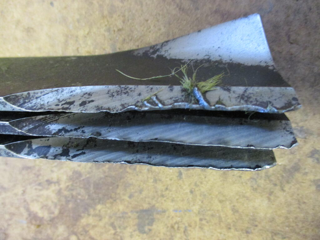

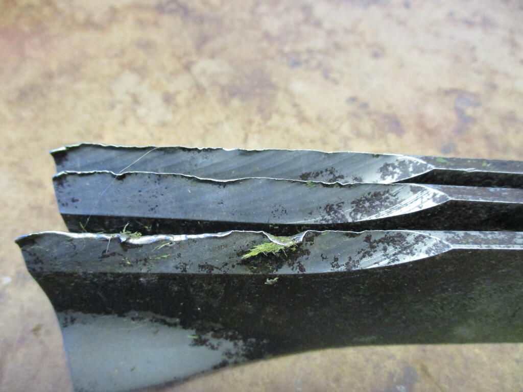

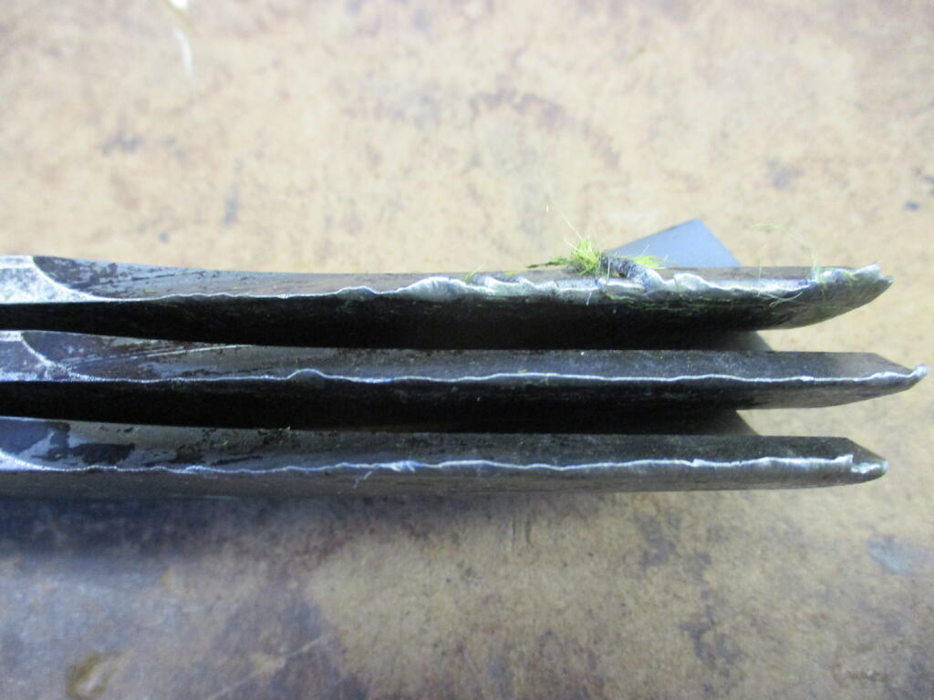

pfrederi 21,342 #23 Posted October 25 New chapter in the Charger 12 I loaned my nephew for about 14 months...She threw a rod see previous posts in this thread. So I put on another K301. Took it out to mow some. Did a terrible job. When I loaned my nephew the tractor I had gone over the deck painted under side with POR and put on a NEW set of blades, so I was surprised how poorly it mowed. I guess my nephew decided to mow his rock garden. I think no more loans to family!!!! 2 4 Share this post Link to post Share on other sites
Retired Wrencher 7,042 #24 Posted October 26 On 8/25/2026 at 2:45 PM, pfrederi said: Loaned a Charger 12 to my nephew a year and half ago. Came home yesterday piston does not go up and down any more. He didn't hear anything. Guess I have a new project. Got the engine off the tractor draining, it no glittery stuff in the oil. Will be interesting to see inside. OHHH wow I hope you get it back to running with not much cost. Share this post Link to post Share on other sites
lynnmor 9,081 #25 Posted October 26 19 hours ago, pfrederi said: When I loaned my nephew the tractor I had gone over the deck painted under side with POR and put on a NEW set of blades, so I was surprised how poorly it mowed. I guess my nephew decided to mow his rock garden. I think no more loans to family!!!! I think you are finally catching on, now put up a very large sign saying "NO MORE LOANS". 4 Share this post Link to post Share on other sites
