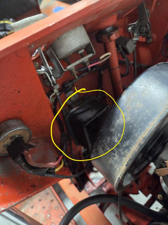

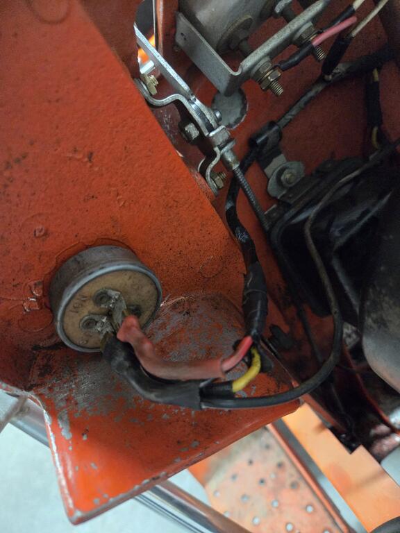

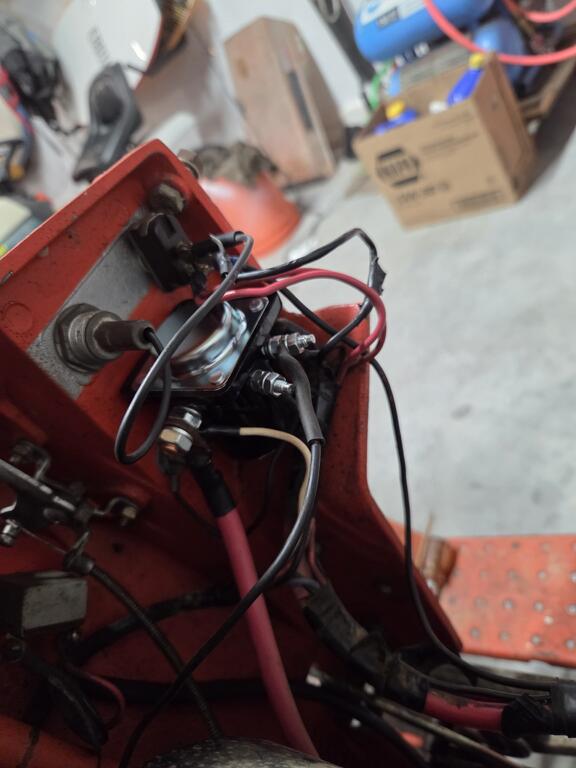

pfrederi

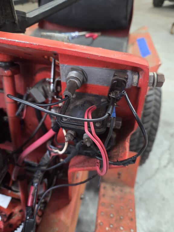

Can you post a [picture of the wires  I suspect they may be your issue...they can look OK but not pass enough current....
  • Like 1
McTurff
I just can't see how anything has changed on wiring since it last ran and after aching unless a ground fried when arched but here are some pics 20260908_174207.jpg.65062ed8053cc67428d0c1218ba05ef1.jpgspacer.pngspacer.pngspacer.png

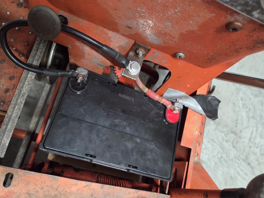

pfrederi
The battery ground seems to go to sheet metal...maybe ground the battery to an engine mounting bolt or something on the block???
  • Like 2
McTurff
That's where all the grounds go on these tractors through my research it is solid metal ! It worked fine before but I will try anything at this point!
Sure seems like I have bad ground somewhere but can't figure why arching it changed everything?

McTurff
Well you may have!
Will run new ground tomorrow 🙏

pfrederi
You can trust your mother but not your ground
McTurff
Hallelujah.
My persistence paid off and all your help she runs again!!
Took ground from battery to engine mount and she's alive!
From the mower graveyard given new life then I killed her and brought her back to life again haha 😄
  • Like 3
  • Excellent 1
pfrederi
My suspicion is when you arced the rush of power broke down a sheet metal to sheet metal contact point in the ground path that was somewhat corroded anyway.
  • Like 3
  • Excellent 1
