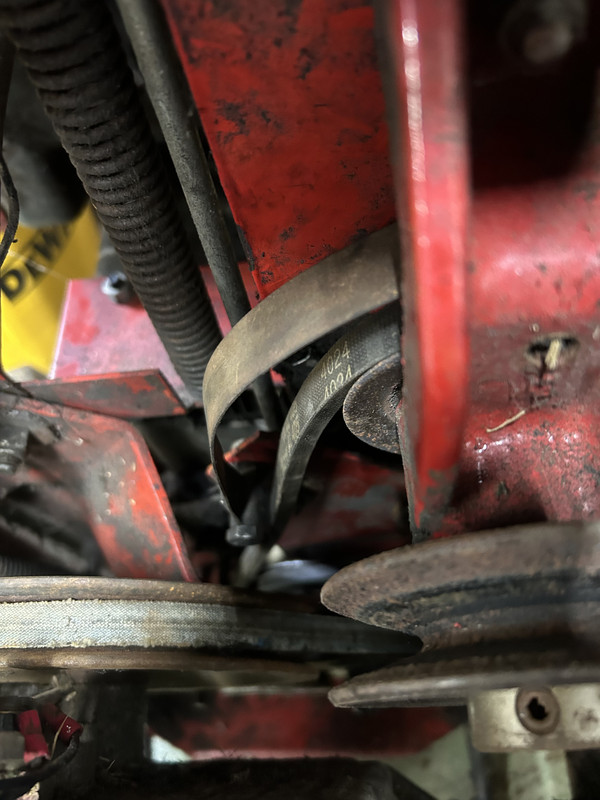

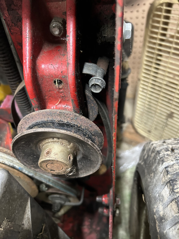

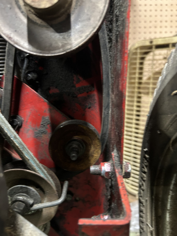

MowerGuy21 1 #12 Posted August 23 Hopefully this works… pictures of the belt on the mower. It’s in “engage” mode. There’s still plenty of play on the belt even though I’ve got the PTO adjusted to take up as much slack as possible. Is it supposed to be this loose? You can see the slack especially well in the third picture. I was given the mower last summer and had this same issue. Put it away for a while and now I’m banging my head against a wall again. Fires right up and runs well, but it shredded/smoked two of this belt last summer. Share this post Link to post Share on other sites
Ed Kennell 47,586 #13 Posted August 23 Do you have the correct PTO tension spring and is it adjusted to the 1 3/4 " length to apply the correct tension to the belt? Share this post Link to post Share on other sites
gwest_ca-(File Mod) 12,508 #14 Posted August 24 Those grooves look very rusty. Nothing wrong with rust but it has to be smooth. A wide flat file works good - knock off the high spots. A belt constantly slides into the groove and back out of it so smooth is required to prevent wear. 1 Share this post Link to post Share on other sites
