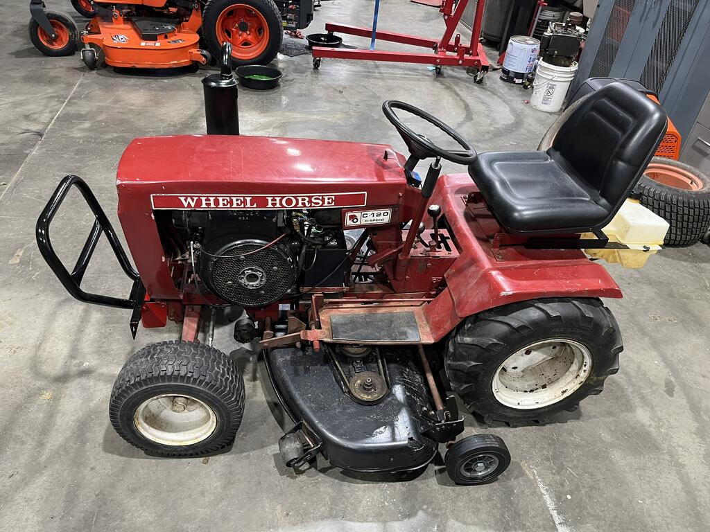

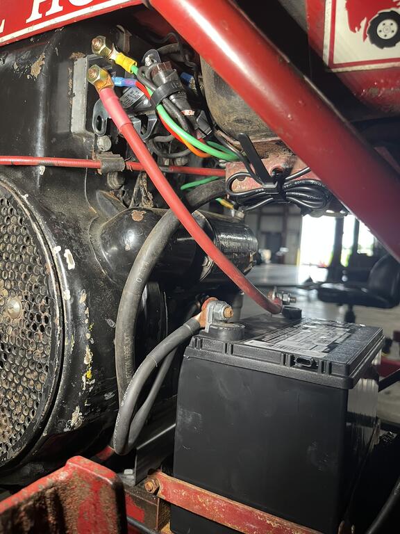

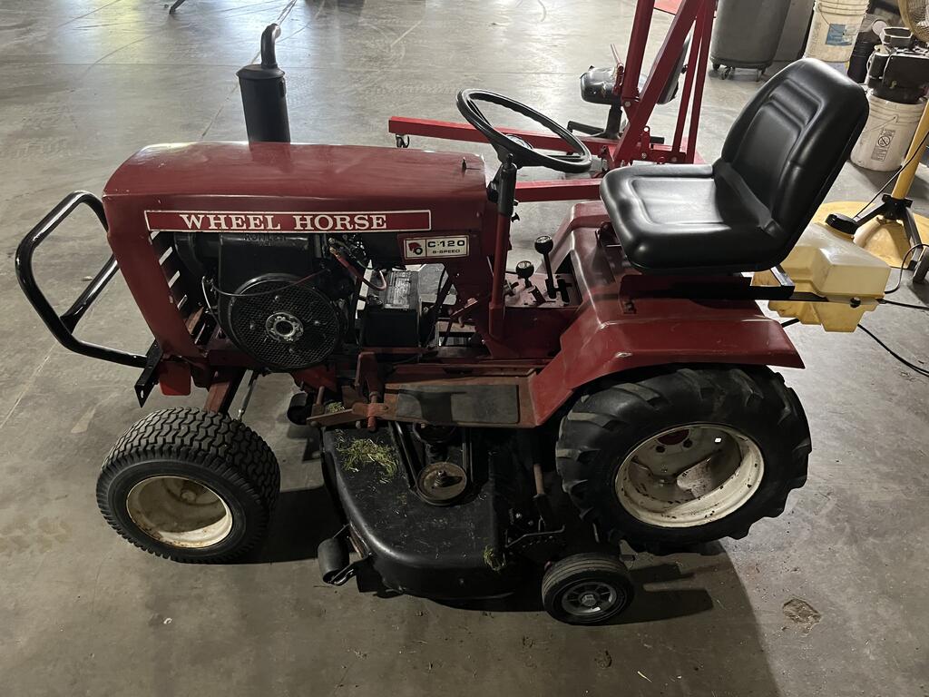

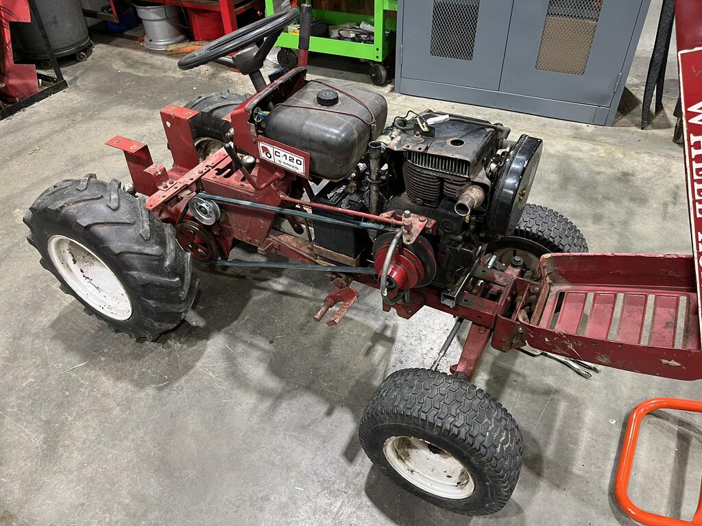

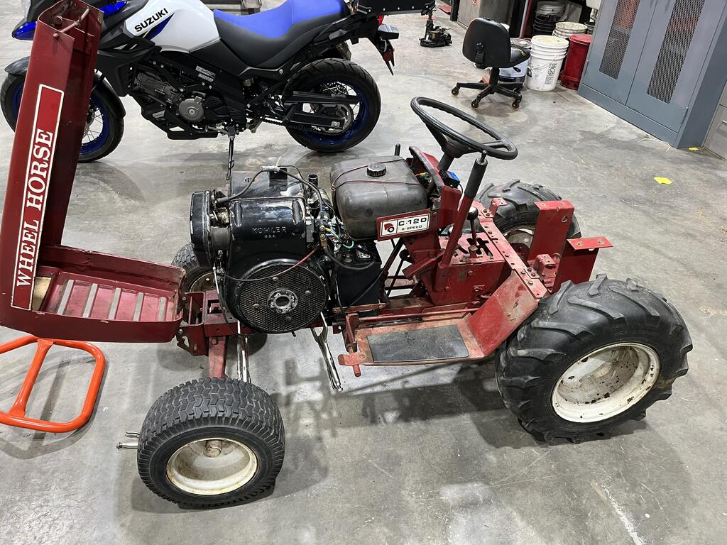

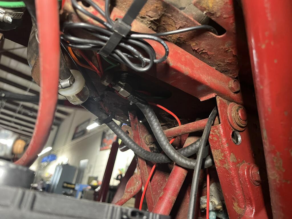

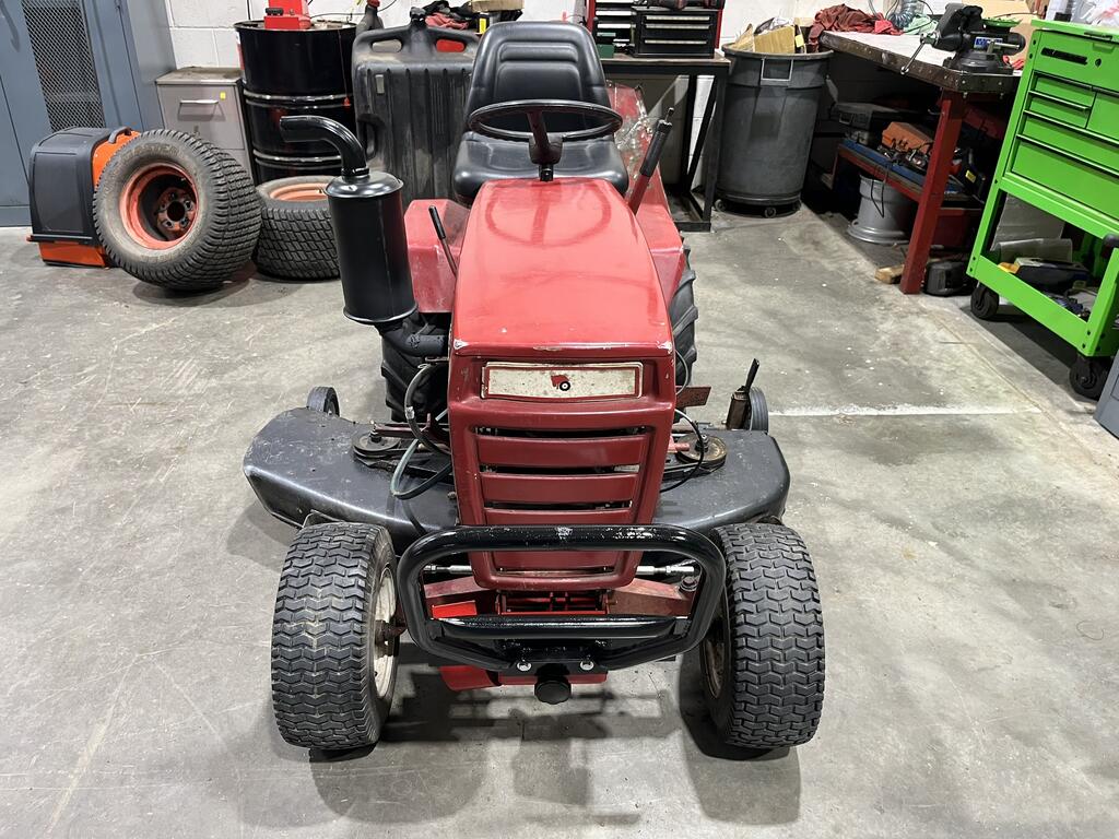

sgtsampay 166 #1 Posted August 20 (edited) Hello everyone. I have not falling off the face of the earth just yet and have been working on the old C120 that I got from my Grandfather years ago. I didn't really use it much as the old K301 was leaking and very worn out. So, I just let it sit in the barn for a long time. Well I got to thinking lately and I was like it time to get it going again. So I took it to work and stuck it in my work bay to get me working on it. To start we need to do something with the engine. Well, one of my co workers had a good shape K321 from a Cub Cadet. So, they was the first thing to do. (The first two photos of of it mocked up.) Once it was secured, I had to redo the whole wiring harness from scratch. The old one melt at some point and I figured it wouldn't hurt to wire it up correctly. I even used different color wires!!! ( I know right! HAHA) Next was the old 48in mower deck. Yes this deck is used to cut my neighbor's 3 acre horse pasture. So the deck will not need to cut pretty, just handle large tall growth compared to a normal yard. So I welded a rebar for the bottom front to help keep it from loosing its shape. I also replaced the old worn out original blades with some gator G6 blades. (They were a huge bear to drill out the hold from 5/8 to 3/4. That metal is super tough.) I also had some wheels hanging around that I have been wanting to use for a project, so I made them fit for this one. They look and seem to work so much better than the factor rear wheels. After that came the front bumper. I got this sub compact tractor bumper for free 5 years ago that i wanted to mount on the wheel horse. Well it finally happened and now it looks great! It will protect the front of the tractor from the brush and other whatnot in the field I will be mowing, plus it looks cool. What I did was use some scrap metal, welded the bumper to it and then bolts this to the front of a mule drive. The mule drive still works as it should and the hood even opens enough for me to refuel the the mid gas tank and check the oil. Final thing I wanted to do was add a secondary fuel tank to the tractor as the center tank only last about one hour or so in heavy mowing. The field is a 5 min tractor ride from my house and i do not want to keep stopping and walking back over or riding over. I found a scrap fuel tank and welded up a bracket, bolted it under the seat back feet. Then plumbed up some hoses to a valve that is mounted on the dash. Turn it left and it turns on the center tank and turn it right it turns on the rear tank. I think it works pretty well and I was surprised it all fit behind the center tank under the dash. I fixed the oil leak at the PTO input shaft on the transmission with a new seal. I also notice the right wheel hub has a wobble to it. So I got the hub off, and use some JB weld with a key trick in the key hole. The hole was a little worn and the key wasn't sitting in perfectly. Now its all snug as a bug. What's left is the drive pulley to get here and then I can put on the PTO clutch. Then the side cover plate and right foot rest for a test drive. All should be good. Oh, and the drive pulley will be the hydro one sleaved down to 1in so I can still have faster 2nd gear. Overall I'm very please with how this project came out and I hope it will do as I want. Mow the field in heavy growth conditions. Thank you everyone for the inspiration and I hope you all have a great day! Edited August 20 by sgtsampay 5 9 Share this post Link to post Share on other sites

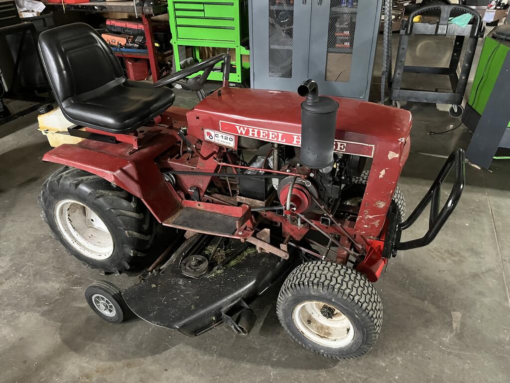

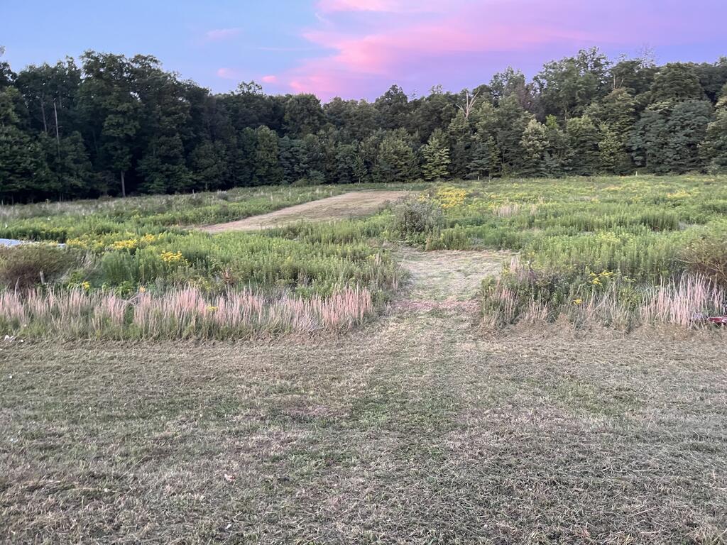

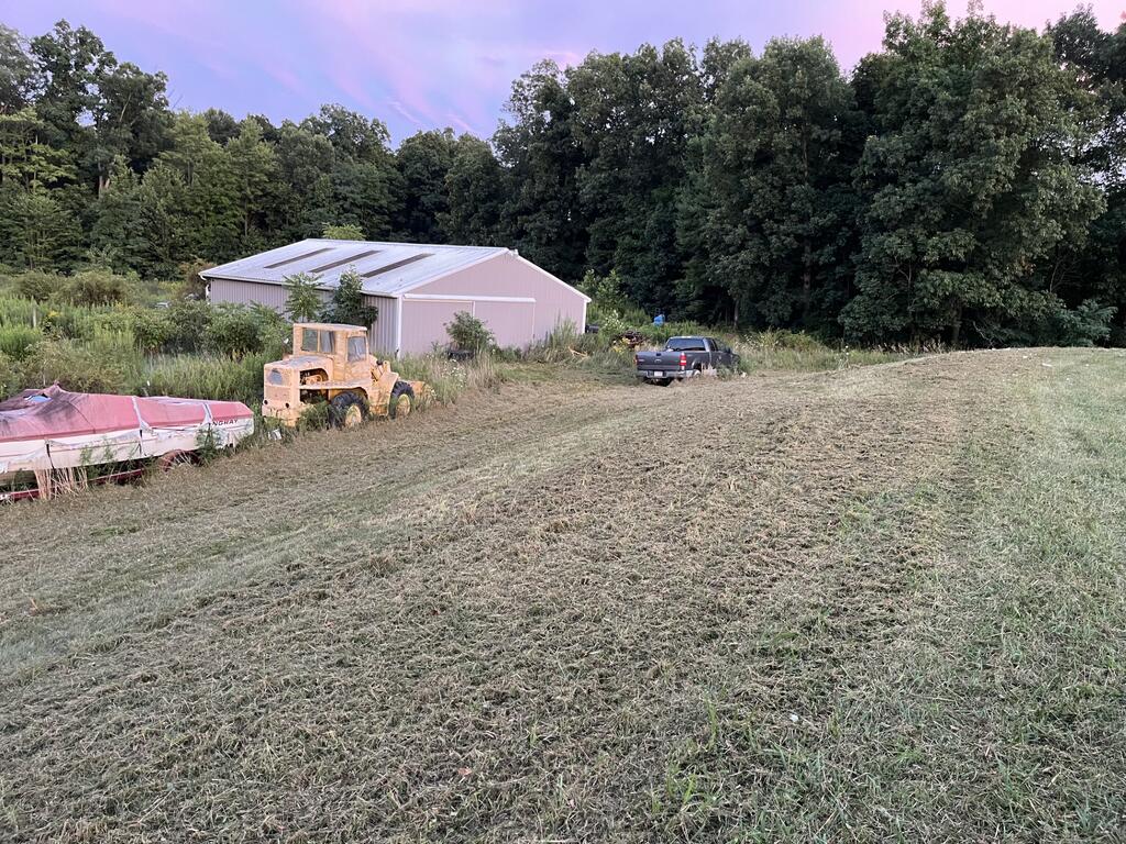

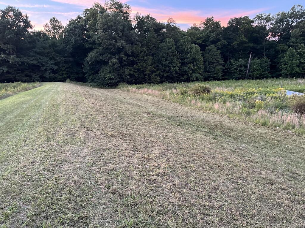

sgtsampay 166 #2 Posted August 20 (edited) More photos. (The field photos are what I have completed so far using this deck before the updates along with my C160 hydro. This grass is about 2-3 feet tall and really worked the tractor. Now, yes a real bush hog would be better however, I do not have one I figured I can use what I got and once its cut down, it will be way easier to maintain. This is after him letting it go for about 3 years due to his house burning down and his health going poor for a while.) Edited August 20 by sgtsampay 4 3 1 Share this post Link to post Share on other sites
ebinmaine 81,278 #3 Posted August 20 5 minutes ago, sgtsampay said: K341 Niiiiice work! FYI that'd be a C160. I like the second fuel tank idea. Share this post Link to post Share on other sites
sgtsampay 166 #4 Posted August 20 Haha, you got me. I corrected it to K321. LOL. I hope the second fuel tank idea works well. It was very easy to install and get going. 1 Share this post Link to post Share on other sites
8ntruck 9,420 #5 Posted August 20 Second fuel tank should be a workable idea. Seems to me that Wheel Horse had a kit to add a second fuel tank - not a real common item, though. 1 Share this post Link to post Share on other sites
ebinmaine 81,278 #6 Posted August 20 6 minutes ago, 8ntruck said: Second fuel tank should be a workable idea. Seems to me that Wheel Horse had a kit to add a second fuel tank - not a real common item, though. Correct. It was a rectangular 5 gallon tank meant to be added to the 500 series tractors behind the seat. I have a tank here from a Toro zero turn that looks very similar. Share this post Link to post Share on other sites
Handy Don 17,735 #7 Posted August 20 2 hours ago, ebinmaine said: Correct. It was a rectangular 5 gallon tank meant to be added to the 500 series tractors behind the seat. Fuel load could easily outlast the operator’s bladder. 1 3 Share this post Link to post Share on other sites
ebinmaine 81,278 #8 Posted August 20 1 hour ago, Handy Don said: Fuel load could easily outlast the operator’s bladder. Quite true 1 Share this post Link to post Share on other sites

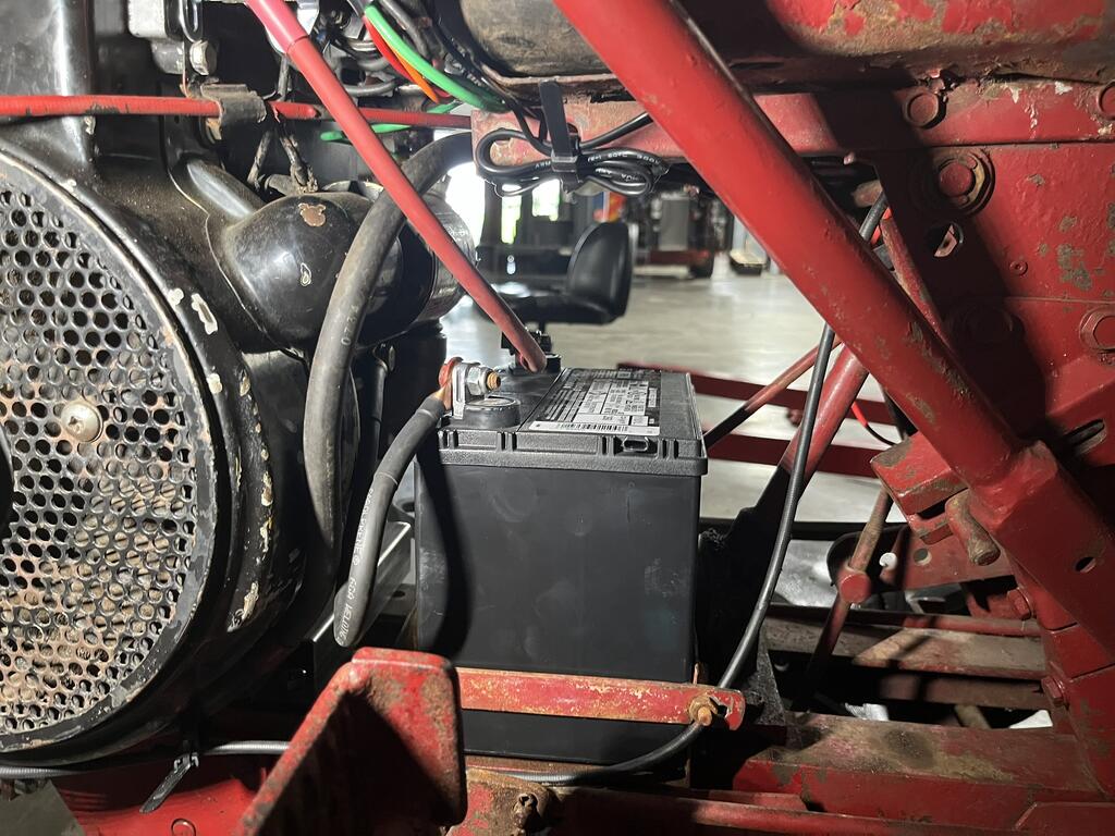

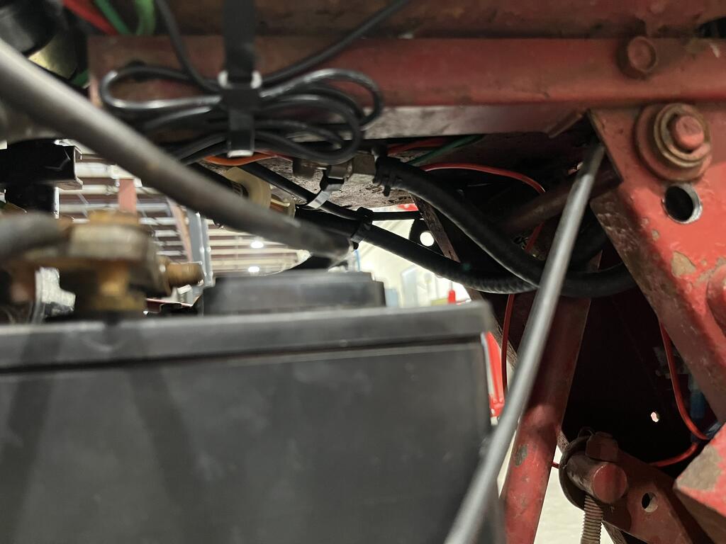

sgtsampay 166 #9 Posted August 21 Update: I replaced the battery connectors and then put in a much smaller and way battery CCA battery. 4 Share this post Link to post Share on other sites
ebinmaine 81,278 #10 Posted August 21 11 minutes ago, sgtsampay said: smaller Be sure to keep the battery from sliding around in the tray. I've had to use little chunks of wood and/or felt as "spacers" Share this post Link to post Share on other sites
sgtsampay 166 #11 Posted August 21 I used chunks of wood for that purpose. Its super snug right now so it should not move.. 1 Share this post Link to post Share on other sites

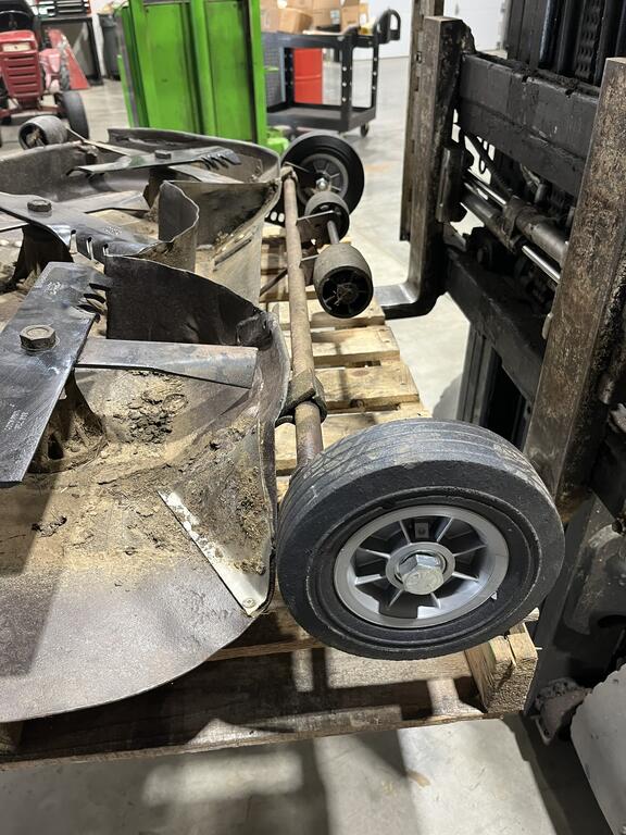

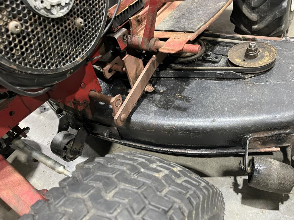

sgtsampay 166 #13 Posted August 22 Update: so I put jt all back together minus the belt cover. The cover is able to mount due to the idler pulley rubbing against the side of the cover. So I just made the clutch brake on the tractor chassis so I can run the whole thing without the cover. So during the test drive, I started to test mow. Well two things happened. First the midmount let go due to the spring being weak. I later took it apart and put in a much stronger spring that keep the wheel lock in place. Second thing was how forward the mower deck is pointed. I will be later today, correcting this via the truion in the thread rod. At least it drives and works correctly the most part. 2 Share this post Link to post Share on other sites

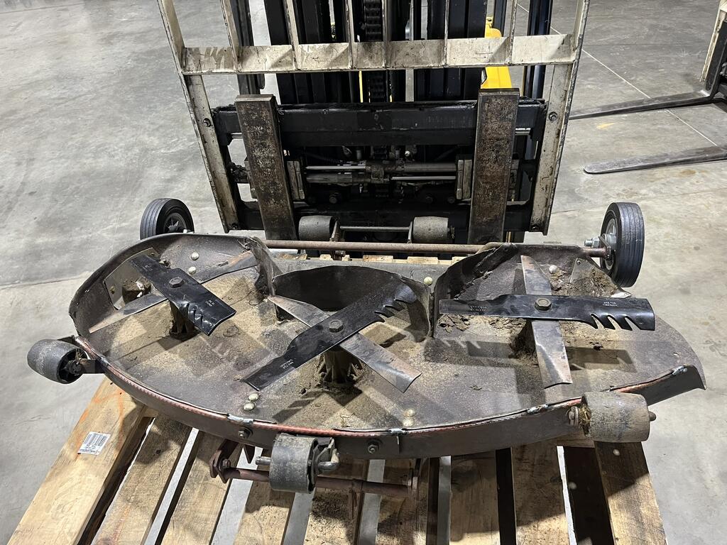

sgtsampay 166 #14 Posted August 22 Update: so I corrected the mower deck and now it seems to have a blade height of 4.25in at slot 5. So I’m pleased. Slot ; is about 3.75 or so. I also removed the second set of blades and are just running the gator g6 blades as I felt with the x blade setup the rpm would only go to about 3200rom with the mow deck on and without the second set it will go to about 3460rpm. So clearly the engine was just about maxed out with spinning the dual set of blades and that’s even with it not driving the hydro. I do think there is a difference in power with this deck on my c160 hydro. Which I figured I would t notice due to one being an 8speed and the other a hydro. It’s interesting. well thank you all for reading about my latest project. It was fun sharing. 2 2 Share this post Link to post Share on other sites

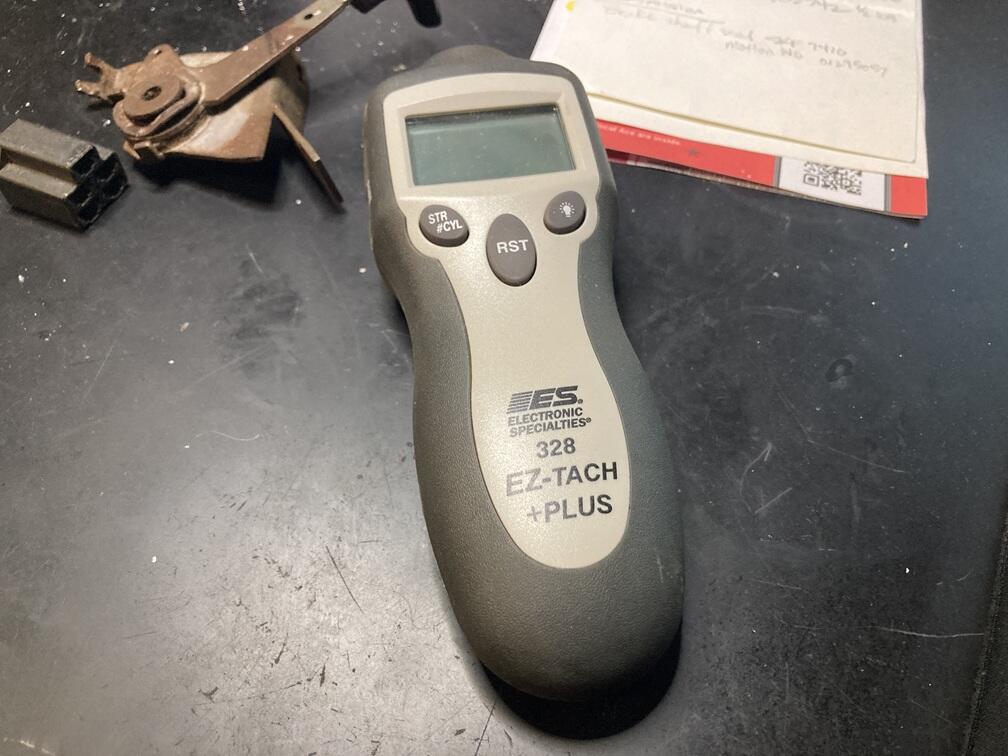

ineedanother 2,885 #15 Posted August 23 4 hours ago, sgtsampay said: Update: so I corrected the mower deck and now it seems to have a blade height of 4.25in at slot 5. So I’m pleased. Slot ; is about 3.75 or so. I also removed the second set of blades and are just running the gator g6 blades as I felt with the x blade setup the rpm would only go to about 3200rom with the mow deck on and without the second set it will go to about 3460rpm. So clearly the engine was just about maxed out with spinning the dual set of blades and that’s even with it not driving the hydro. I do think there is a difference in power with this deck on my c160 hydro. Which I figured I would t notice due to one being an 8speed and the other a hydro. It’s interesting. well thank you all for reading about my latest project. It was fun sharing. Curious what you're using for a tach. I've had this one a little while and it's okay but I'm not in love with it. Share this post Link to post Share on other sites

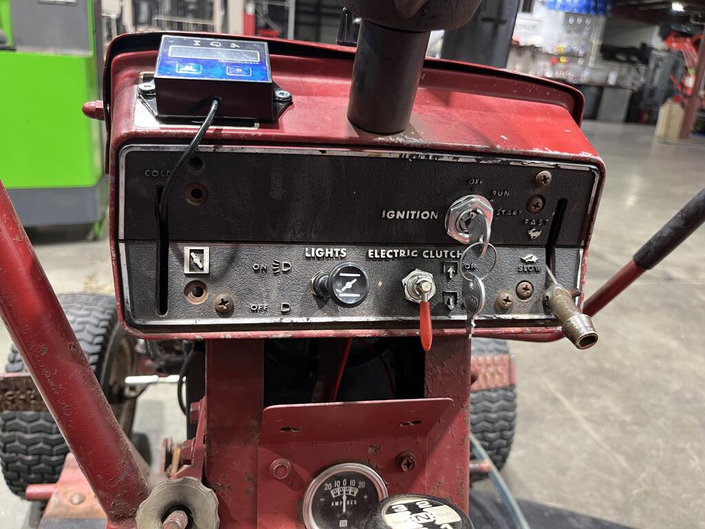

sgtsampay 166 #16 Posted August 23 9 hours ago, ineedanother said: Curious what you're using for a tach. I've had this one a little while and it's okay but I'm not in love with it. I’m using an engine tach. The blue one on the top let side of the dash. It’s a little slow at times but it also counts the hours as well. I have not use a lazer tach at work yet to see the pulley speed or anything like that. 3 Share this post Link to post Share on other sites
ineedanother 2,885 #17 Posted August 23 Cool. I've got that one here somewhere and used to use it with chainsaws. I remember now that it worked pretty well. Thanks 1 Share this post Link to post Share on other sites
ebinmaine 81,278 #18 Posted August 23 4 hours ago, ineedanother said: Cool. I've got that one here somewhere and used to use it with chainsaws. How does take the reading? Wire wrap the plug wire? Share this post Link to post Share on other sites
ineedanother 2,885 #19 Posted August 23 1 hour ago, ebinmaine said: How does take the reading? Wire wrap the plug wire? Yes, powered with a button battery. I used to velcro it to a hood or dash to watch the speed for one reason or another. It was pretty accurate from what I can remember. I haven't used it in a while. 1 Share this post Link to post Share on other sites
ebinmaine 81,278 #20 Posted August 23 20 minutes ago, ineedanother said: Yes, powered with a button battery. I used to velcro it to a hood or dash to watch the speed for one reason or another. It was pretty accurate from what I can remember. I haven't used it in a while. I have a tach that uses a tiny piece of reflective material stuck on the rotating item to read rpm. Works fine for tractor checks but I don't see how it would function for a chainsaw. I should really have a separate tool for those. Share this post Link to post Share on other sites
ineedanother 2,885 #21 Posted August 23 6 minutes ago, ebinmaine said: I have a tach that uses a tiny piece of reflective material stuck on the rotating item to read rpm. Works fine for tractor checks but I don't see how it would function for a chainsaw. I should really have a separate tool for those. I just do 2 strokes by ear now. I just richen them up on the top end to slow them a bit and adjust once see how they do under a full load. 1 Share this post Link to post Share on other sites
ebinmaine 81,278 #22 Posted August 23 7 minutes ago, ineedanother said: I just do 2 strokes by ear now. I just richen them up on the top end to slow them a bit and adjust once see how they do under a full load. Same. 1 1 Share this post Link to post Share on other sites
sgtsampay 166 #23 Posted August 25 Update: So I put the new tractor to work on the field finally. It ran very well. I was able to make 3 passes before I had to go home due to the muffler splitting apart. So I had to order the amazon one that your guys have tried. We will see. Now, my issue is how the mower deck seems to be running great. Spinning great until the tractor bogs down to about 3 k and then the mower deck seems to drop in speed very fast. The engine doesn't go any lower though. I'm running the tractor in 1 or 2 low as well. At first I was thinking the PTO is slipping but I'm not so sure and i don't want to keep making it tighter in fear it will wreak the bearings. The mule drive belt seems to be very tight as well and its a new belt. What am I missing? Can anyone refresh me about how to confirm the PTO is not to tight? LIke I know when you turn the lever the steering tower will twist a tad along with the engine slightly twists as well. My C160 does the same thing and both have brand new PTO clutch disks. The C160 also would bog down running this deck and the engine RPM would go down to 2.3k. Then I would stop moving and let the engine catch back up. Any thoughts you guys? Share this post Link to post Share on other sites
c-series don 12,751 #24 Posted August 25 All I know is that it looks like golden rod growing in that field. The thought of mowing that is making my eyes water and I’m sneezing uncontrollably 🤣🤣🤣 1 1 Share this post Link to post Share on other sites
sgtsampay 166 #25 Posted August 25 I’m thankful I haven’t had any sneezing fits yet. Yes that’s stupid weed stuff goes everywhere! I hope this weekend to get some more mowing in.. tomorrow the muffler will be here. Update: To counter the slowing down of the deck under heavy load I confirmed the pro is aligned correctly. I also did two turns on the pto rod to get it to an air gap of .012. So we will see if that helps. I also found one barely loose engine mounting bolt. I corrected this and confirmed they are all right. So now we will see if that makes any difference. 1 Share this post Link to post Share on other sites
