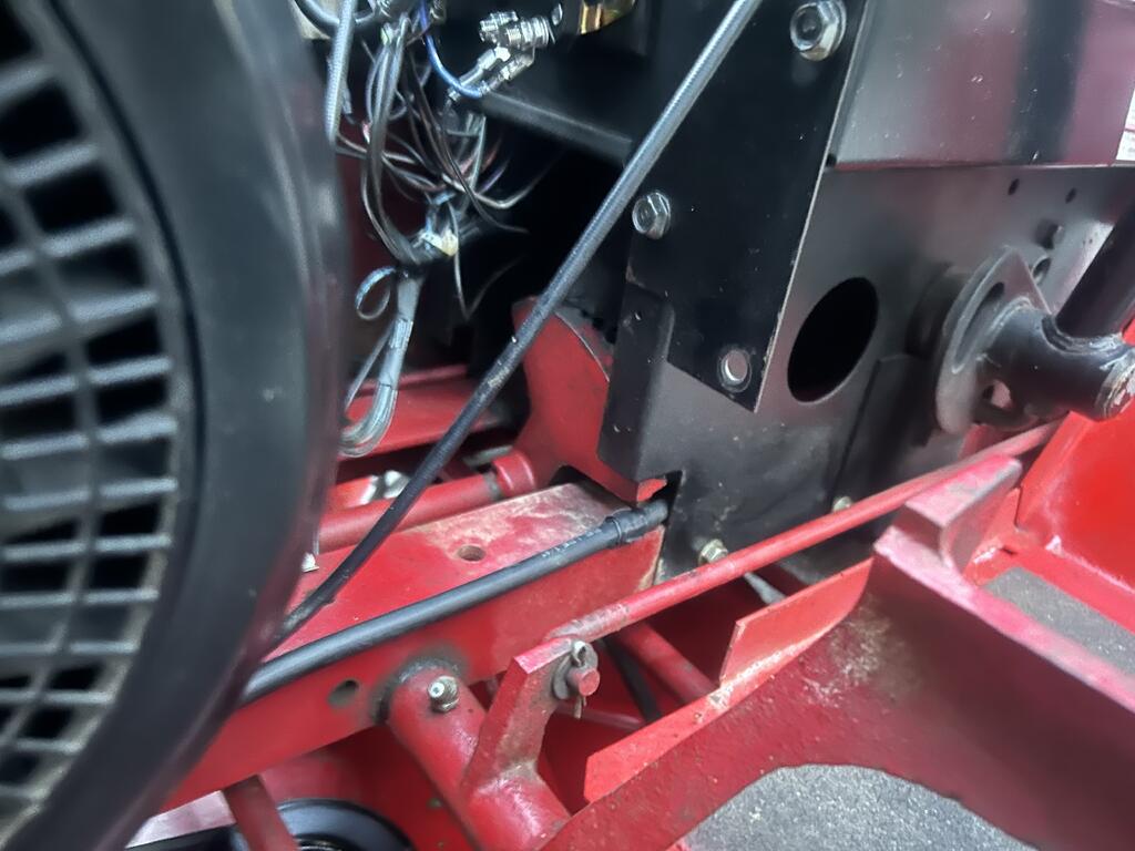

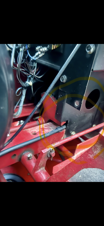

Vinnie 11 #1 Posted August 19 I have a 310–8 Wheelhorse Tractor The fuel line was Run next to the serum column mechanism and it cut the line. I am replacing the fuel, but I’m not sure the location around the steering mechanism. Anyone have any ideas on how to get it through? I attached a video to show you the issue. Thanks again for your help. Share this post Link to post Share on other sites

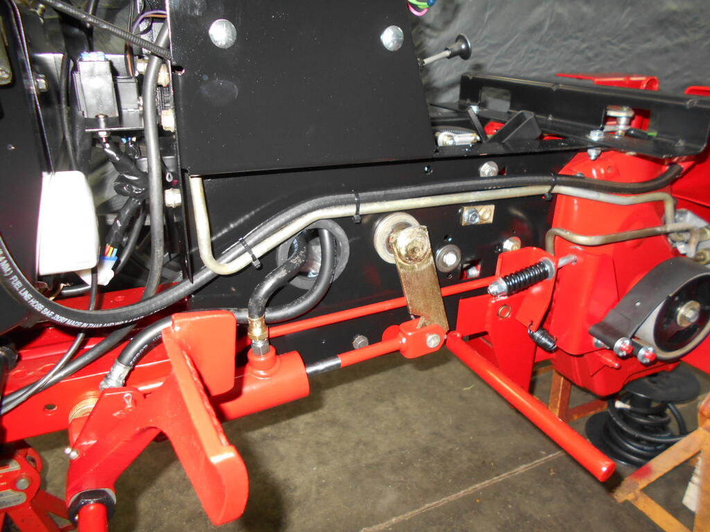

cleat 9,448 #2 Posted August 20 This is where I routed mine on the 416 I built last year. I know you don't have that hydraulic line but you could fasten it there another way. 3 2 Share this post Link to post Share on other sites
peter lena 10,125 #3 Posted August 20 @Vinnie opportunity staring right at you ? if you tuck a line INSIDE THE FRAME LENGTH INNER 90 DEG BEND , it disappears , another option with this , would be to make that long frame length run , with ? 1/4 or 516 steel brake line ? ELIMINATE THAT FUEL HOSE BREAK DOWN ZONE , that frame 90 deg bend easily holds mounting spots , minimizing rubber hose , along with , sta bil in all my fuels , have zero debris in any related filter or carb bowl , doing this for years , regularly go after REPEDETIVE ISSUES . MAKE A CHANGE , PETE Share this post Link to post Share on other sites

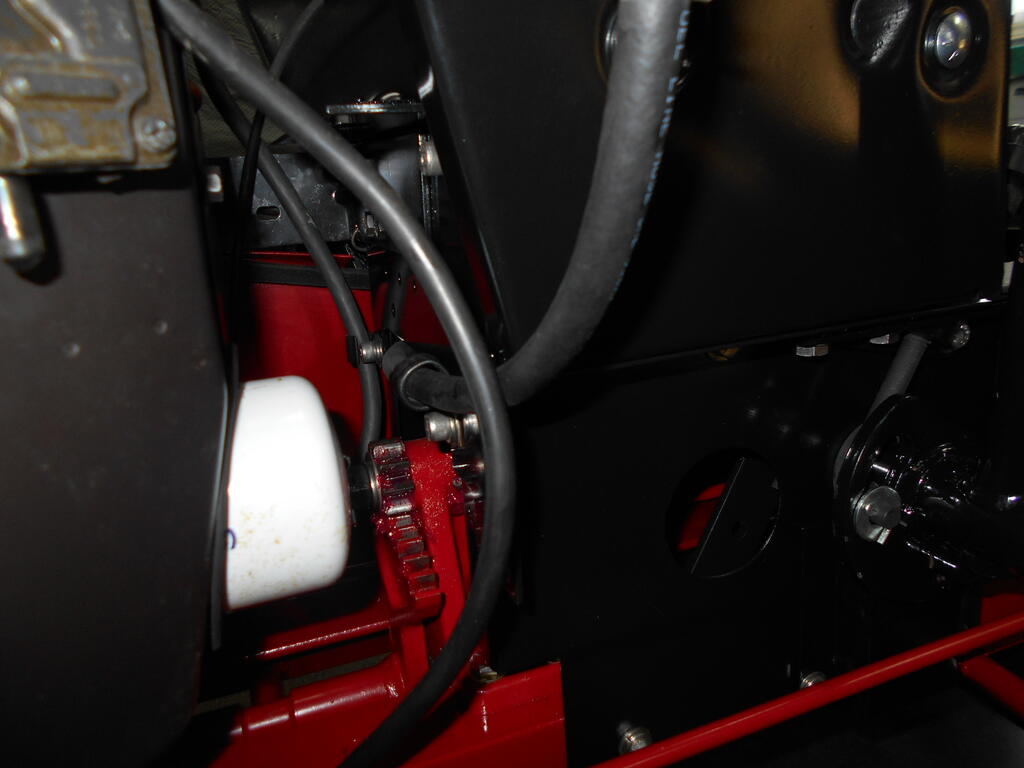

cleat 9,448 #5 Posted August 21 2 hours ago, Vinnie said: Thanks for your help. Would anyone have pictures of a 310 tractor with how they routed the fuel line? Here is how I routed the fuel line on my 520-8 which is very close to your 310 except you need the line to be a little longer to run to the front of the engine. 1 Share this post Link to post Share on other sites
sqrlgtr 4,225 #6 Posted August 22 6 hours ago, cleat said: Here is how I routed the fuel line on my 520-8 which is very close to your 310 except you need the line to be a little longer to run to the front of the engine. Same as @cleat but on a 520H and not near as clean and shiny. Share this post Link to post Share on other sites
