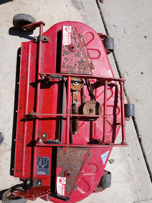

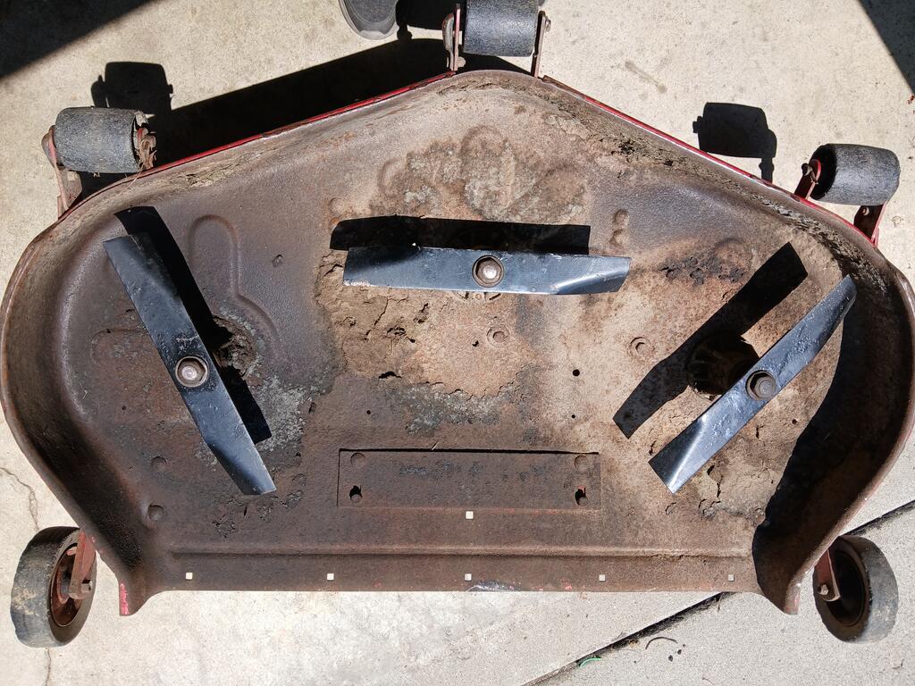

Good Afternoon All
 Just acquired rear discharge deck and spare mule drive for the Raider 12.
Can anyone ID the deck? I see not tags on it.
Once my mid mount hitch arrives I should be able to mount and mow.
 Also, the hight adjustment has no markings, so I'll ASSUME that you adjust with a tape measure off of the blade tips.
 Thanks to all who respond

Looks like the blades are too short. ?

@Simplecity  what is the width  underside  deck  inner side wall to wall , ?  looks like a 42"  also lucky you !  no baffles !  also no related rot . I have 3  of those , this what my decks look like , how do  spindles sound move , any roughness at all ? have a regular bearing clean out and re grease , with  lucas x tra hd  green chassis grease  , also did my mule  drive bearings , no  noise or bearing whine , what an opportunity  !   mine are  rust free and quietly very solid . BTW  the related pto  lever set up  . is a GOLD MINE  FOR IMPROVEMENT  . did this too. wish you were closer !   ask away , pete
" rear discharge , also lucky yoy

  It is a 42". Would you have any idea of a model #? I would like to get a parts manual.

It will be one of these. A few of the differences are noted but not all.
These all use blades with 3/4" center hole.
1977 model 75-42MR02 replaced by - (Has the flat spindle belt idler pulley mounted on a flat bar) (Has multi-link hardware at the gauge wheel support)
1978 model 85-42MR01 - (Has the flat spindle belt idler pulley mounted on a flat bar) (Has multi-link hardware at the gauge wheel support)
1979 model 95-42MR01 - Shares an illustrated parts list with 85-42MR01 - (Has the flat spindle belt idler pulley mounted on a flat bar) (Has multi-link hardware at the gauge wheel support)
1979 model 95-42MR02 - (Has no multi-link hardware at the gauge wheel support)
1980-1983 model 05-42MR01
1984 model 05-42MR02 - Last year for bearings with 3/4" ID
1985 model 05-42MR03 - First year for bearings with 17mm ID unless older spindles were updated.
1986-1988 model 05-42MR04
1989-1990 model 15-42RC01
1990-1992 model 15-42RC02
1993-2012 model 78350
Note - 17mm is .669"

I don't know if it will help but is there a part number on the belt routing decal or any of the others?
Simplecity
Thanks for the model#s
The is a part # on the belt routing decal (106748) I'll see if that will help narrow it down.
 The deck does have the flat bar mounted tensioner pulley.
