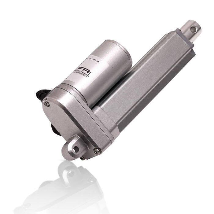

TheMooseIsLoose 17 #1 Posted August 19 I am looking to install a Deflector Actuator on my 520-H single stage snowblower. Does anyone out there use one and what brand/model number you are using. A 4" stroke shoud be sufficient. If anyone does please post a pic of it installed. Thank You Share this post Link to post Share on other sites

TheMooseIsLoose 17 #3 Posted August 19 I was thinking about something like this 2 Share this post Link to post Share on other sites

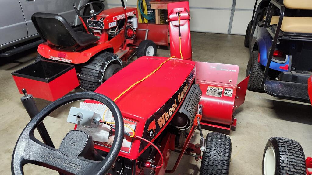

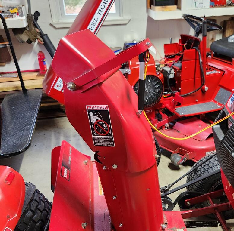

Racinbob 13,290 #6 Posted August 20 I put this on my tall chute a while back. Mounted this way the 6" stroke is spot on. The control is mounted in a pvc handy box with a magnet. The directional crank works just fine for me. 1 3 Share this post Link to post Share on other sites

Racinbob 13,290 #10 Posted August 20 (edited) 55 minutes ago, TheMooseIsLoose said: Do you have a brand name/model #, I've looked at Firgelli and others but don't know which is good. I was thinking of a 4" stroke but a 6" may be better. @Bar Nuthin I don't know if this link is still good. DC 12V Electric Micro Linear Actuator Mini 1.2" 2" 4" 6"Stroke Fast Speed CNC TV | eBay The length depends entirely on your set up. The 6" worked perfectly for my set up with the fairly long chute handle. It lowers the needed power with the leverage. Simply measure what you need. The speed is plenty fast enough. Edited August 20 by Racinbob 1 Share this post Link to post Share on other sites
Bar Nuthin 3,642 #11 Posted August 20 1 hour ago, Racinbob said: The 6" worked perfectly for my set up with the fairly long chute handle. Looks identical to mine 1 Share this post Link to post Share on other sites

Racinbob 13,290 #17 Posted August 24 3 hours ago, TheMooseIsLoose said: This comes with hardware, how is it wired in for power. I cant find a manuel for this. No manual. It's simply a 2 wire connection. 12v DC. I used a DPDT momentary center off switch to flip the polarity for the in/out. It shuts off automatically when it reaches full extension or retraction. The switch is housed in a pvc box with a cord that plugs into a power port I installed. Switchbox is headed in place with a magnet. Flexibility. The blower will likely go on Dino. I much prefer the manual PTO vs electric. 2 Share this post Link to post Share on other sites

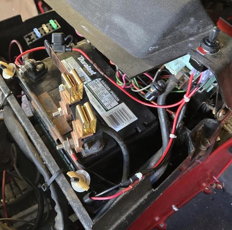

TheMooseIsLoose 17 #20 Posted September 12 On 8/20/2026 at 7:40 AM, Bar Nuthin said: Looks like a great mod. Do you have a link for this actuator? Iam currently installing my actuator, what did you splice into for power. Share this post Link to post Share on other sites
Racinbob 13,290 #21 Posted September 12 Look closely at the pictures and you'll see a power port I installed on the steering tower. I installed that a couple years ago mainly for a tank sprayer. Share this post Link to post Share on other sites
TheMooseIsLoose 17 #22 Posted September 14 On 9/12/2026 at 1:47 PM, Racinbob said: Look closely at the pictures and you'll see a power port I installed on the steering tower. I installed that a couple years ago mainly for a tank sprayer. would it be safe to run power from the battery to the switch with a inline 10 amp fuse between battery and switch. Share this post Link to post Share on other sites
Racinbob 13,290 #23 Posted September 15 1 hour ago, TheMooseIsLoose said: would it be safe to run power from the battery to the switch with a inline 10 amp fuse between battery and switch. Sure. The power port on mine is connected that way. Share this post Link to post Share on other sites

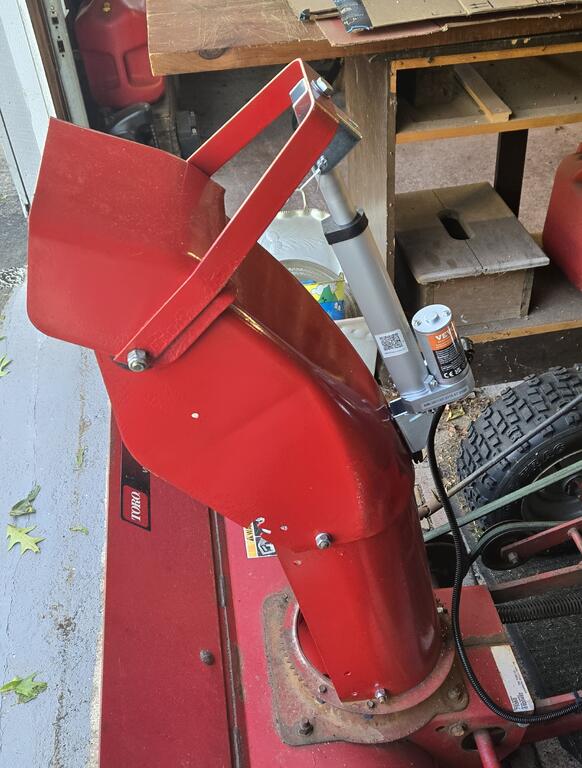

TheMooseIsLoose 17 #24 Posted September 30 On 8/19/2026 at 11:14 AM, TheMooseIsLoose said: I am looking to install a Deflector Actuator on my 520-H single stage snowblower. Does anyone out there use one and what brand/model number you are using. A 4" stroke shoud be sufficient. If anyone does please post a pic of it installed. Thank You Finally got this mounted & wired. It is a little slow but i will deal with it. Thanx 4 all of your help. 1 Share this post Link to post Share on other sites
Handy Don 17,735 #25 Posted September 30 1 hour ago, TheMooseIsLoose said: Nice neat job. Is the knife switch just for an overall cutout? BTW, if you were in an embellishing mood, you could add a cross piece on the deflector arm closer to the pivot to attach the actuator. With the shorter throw, the movement would be quicker. Share this post Link to post Share on other sites
