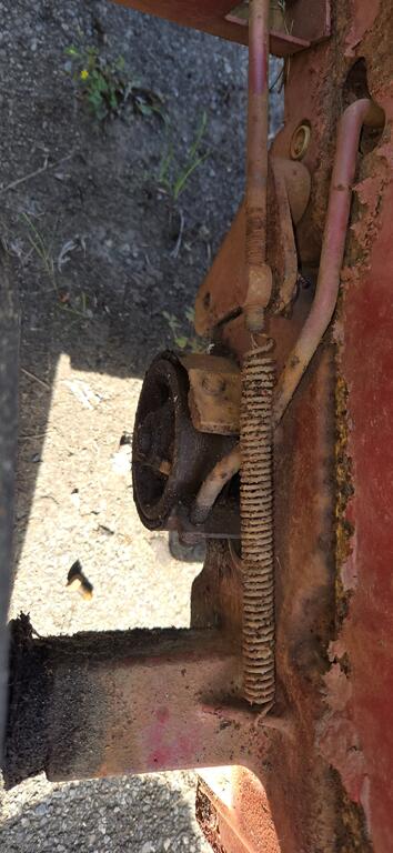

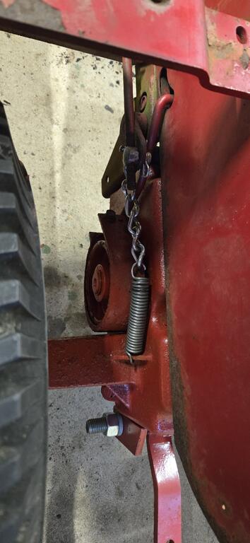

tractor. 3 #1 Posted August 18 I have a b80 and im unsure of what snow plow i can use, do I need a long frame, a short frame, or does it not matter being its a mid frame. Also not sure if it will matter or not, but I swapped the trans being it was seized, and i think it was from an 856 and the brakes are a little differently placed so i dont know if it will get in the way or not. Not sure if this will help or not, the photo with the newer red and chain is the one I put in and the other one is the original style from my parts b80 Share this post Link to post Share on other sites

Ed Kennell 47,308 #4 Posted August 18 The brake location will not matter. The long frame will work with either style axle bracket. The short frame may work with the older style axle bracket that has the notches in front of the axle. 1 Share this post Link to post Share on other sites
