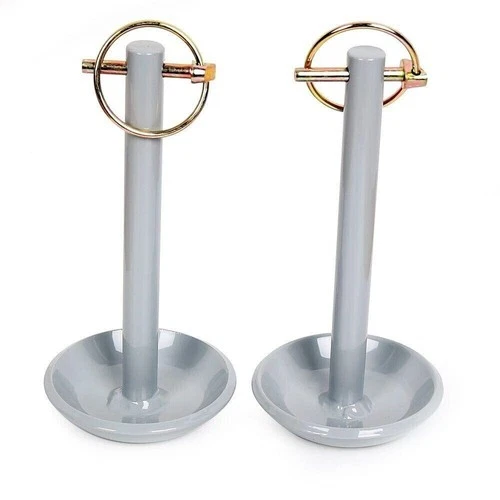

1987_WHEEHORSE312 95 #1 Posted August 17 Hey guys! Has anyone found plow skids that work that bolt on and also adjustable on the fly? My driveway is mostly gravel but I have a pavement apron at the end, as well as my neighbors driveways that are pavement that I plow for them too. I dont have a welder so being able to bolt stuff together is my only option. Thanks! Share this post Link to post Share on other sites
953 nut 69,285 #2 Posted August 17 24 minutes ago, 1987_WHEEHORSE312 said: adjustable on the fly? You planning on putting them on some sort of electric linear actuator or hydraulic cylinder? 1 Share this post Link to post Share on other sites
1987_WHEEHORSE312 95 #3 Posted August 17 1 minute ago, 953 nut said: You planning on putting them on some sort of electric linear actuator or hydraulic cylinder? No, just want pins i can pull and slide thwm manually out. Adjustable on the fly meaning no tools needed to slide them up or down. Share this post Link to post Share on other sites
953 nut 69,285 #4 Posted August 17 Check these out. https://www.ebay.com/itm/317620224807?_skw=wheel+horse+snow+plow+skids&itmmeta=01M08Z870V98AS4S8Q5NZ0GQQ2&hash=item49f3a40327:g:1JgAAeSwOcppT-RS&itmprp=enc%3AAQALAAAA4GfYFPkwiKCW4ZNSs2u11xC%2BP1ZGkww8hATohcc%2FsATOTRBGKzfmjk4kZQcciMBF9DoG8xI2Ppaesmys5tIhWWN3lJVpE%2BO4UPWb7xNjbmiCuT74yZiPVXZh2qNKn34ncx%2BPTrqfdaQAsyDVqAZ1BPE%2BI5WAkMN6JuOlA8Tm0GGAj8hRv92hBHgPu9FoqEzgvveKdgS56IsHd7ZAll0XfKtv4pNECc68wloFsRfQZs30l3sRCjMuBALYpJ0TWtdOAUXVCX8DBAyQI%2FtI1Swq5kunfmAovVlj2PPlhJmQDYBR|tkp%3ABk9SR8bwoJ-CaA Share this post Link to post Share on other sites
1987_WHEEHORSE312 95 #5 Posted August 17 Just now, 953 nut said: Check these out. https://www.ebay.com/itm/317620224807?_skw=wheel+horse+snow+plow+skids&itmmeta=01M08Z870V98AS4S8Q5NZ0GQQ2&hash=item49f3a40327:g:1JgAAeSwOcppT-RS&itmprp=enc%3AAQALAAAA4GfYFPkwiKCW4ZNSs2u11xC%2BP1ZGkww8hATohcc%2FsATOTRBGKzfmjk4kZQcciMBF9DoG8xI2Ppaesmys5tIhWWN3lJVpE%2BO4UPWb7xNjbmiCuT74yZiPVXZh2qNKn34ncx%2BPTrqfdaQAsyDVqAZ1BPE%2BI5WAkMN6JuOlA8Tm0GGAj8hRv92hBHgPu9FoqEzgvveKdgS56IsHd7ZAll0XfKtv4pNECc68wloFsRfQZs30l3sRCjMuBALYpJ0TWtdOAUXVCX8DBAyQI%2FtI1Swq5kunfmAovVlj2PPlhJmQDYBR|tkp%3ABk9SR8bwoJ-CaA Thanks! Do they have a bracket that will bolt onto the existing holes on the plow? Share this post Link to post Share on other sites
953 nut 69,285 #6 Posted August 17 Just now, 1987_WHEEHORSE312 said: Thanks! Do they have a bracket that will bolt onto the existing holes on the plow? Got to fabricate something of your own. Share this post Link to post Share on other sites
1987_WHEEHORSE312 95 #7 Posted August 17 1 minute ago, 953 nut said: Got to fabricate something of your own. Yea thats where im stumped. If I had a welder it would be easy Share this post Link to post Share on other sites

peter lena 10,065 #11 Posted August 18 @1987_WHEEHORSE312 https://www.google.com/search?q=atv+plow+skids&rlz=1C1CHBF_enUS866US866&oq=atv+plow+skids&gs_lcrp=EgZjaHJvbWUyBggAEEUYOTIICAEQABgWGB4yCAgCEAAYFhgeMggIAxAAGBYYHjIICAQQABgWGB4yCAgFEAAYFhgeMggIBhAAGBYYHjIICAcQABgWGB4yCAgIEAAYFhgeMggICRAAGBYYHtIBCTEwMzc1ajBqNKgCAbACAfEFllTzXrNDIJfxBZZU816zQyCX&sourceid=chrome&source=chrome.ob&ie=UTF-8 atv set ups are the same , a spring following slider , would let you dial in your ground contact . picture reference , ideas ? pete Share this post Link to post Share on other sites
1987_WHEEHORSE312 95 #12 Posted August 18 1 minute ago, peter lena said: @1987_WHEEHORSE312 https://www.google.com/search?q=atv+plow+skids&rlz=1C1CHBF_enUS866US866&oq=atv+plow+skids&gs_lcrp=EgZjaHJvbWUyBggAEEUYOTIICAEQABgWGB4yCAgCEAAYFhgeMggIAxAAGBYYHjIICAQQABgWGB4yCAgFEAAYFhgeMggIBhAAGBYYHjIICAcQABgWGB4yCAgIEAAYFhgeMggICRAAGBYYHtIBCTEwMzc1ajBqNKgCAbACAfEFllTzXrNDIJfxBZZU816zQyCX&sourceid=chrome&source=chrome.ob&ie=UTF-8 atv set ups are the same , a spring following slider , would let you dial in your ground contact . picture reference , ideas ? pete Thanks! Yea the actual skids is the easy part, making a mounting bracket it hard given I dont have a welder. Share this post Link to post Share on other sites
