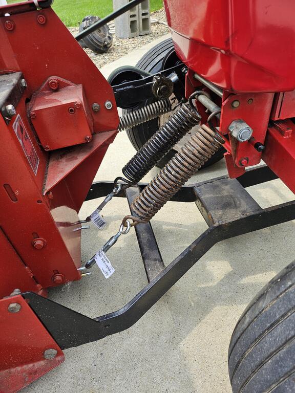

Gary S Minnesota 62 #1 Posted August 15 Hey Folks, I picked up a nice 1977 C160 two years ago and finally have it purring sweetly. I ultrasonically cleaned the carb, replaced the fuel lines and pump and finally installed new points, condenser and coil. ( later found the old coil was fine). My question now involves the hydro unit.. It seems to have plenty of power, easily lifting the mounted 2 stage snow thrower. What puzzles me is that when the hydro lifts the blower, the engine RPM drops a bit. The RPM then stays at this lower speed until the the blower is lowered again relieving the load. Is this normal for a Sunstrand unit? Just curious? My 520 H with the Eaton 110 will also lose a bit of RPM when lifting but the RPM quickly returns to normal once the up lever is released and the load remains in the up position. Share this post Link to post Share on other sites
953 nut 70,584 #2 Posted August 15 The hydro pump consumes about two horse power doing the lifting, even with a 42" snow plow the hydro will slow the engine a bit during lift. You might want to look into some lift assist springs, https://wheelhorsepartsandmore.com/product-category/snow-blower-plows/ Share this post Link to post Share on other sites
ML3 2,567 #3 Posted August 15 9 minutes ago, 953 nut said: The hydro pump consumes about two horse power doing the lifting, even with a 42" snow plow the hydro will slow the engine a bit during lift. You might want to look into some lift assist springs, https://wheelhorsepartsandmore.com/product-category/snow-blower-plows/ Agreed. I have them on my 416H w/Bervac. I definitely noticed an improvement with the springs installed 2 Share this post Link to post Share on other sites
peter lena 10,121 #4 Posted August 15 @ML3 totally agree on that ! been a spring assist , addict for years , adding a heavy eye bolt for a go to spot is regular for me ! now combine that with lubrication detailing. and enhance details as you go , started with choke and throttle cable , pull back assist spring to close / stop ? that way you always have pull assist , now add penetrating oil to those cables , mine in use for years , 3 tractors . functional detailing is an addiction for me , EX , WHY DOES THIS KEEP FAILING ? . ironically its usually a lay out / part failure , easily ENHANCED , favorite helper ? roller stool , picking up every , INTENDED STEP , then INSURING it . what stands out to me in your lower picture ? FLAT IDLER BELT PULLEY , known for rotational LUBRICATIONAL failure , enhance it . red aerosol grease , tiny bearing , heat / stress hang ups , good for you , pete Share this post Link to post Share on other sites
Gary S Minnesota 62 #5 Posted August 16 Thanks for the replies guys. As I mentioned the C-160 lifts that heavy two stage snow thrower without a problem. By the way I do have the 2 helper springs that the factory recommends installed. My question centers on the fact the the engine RPM drops when I lift the snow thrower and REMAINS REDUCED until I actually lower the snow thrower to the drive way at which time the RPM returns to it’s previous setting. My 520 H by comparison, looses a bit of RPM also when lifting , but the RPM returns to the previous speed as soon as I release the up lever with the snow thrower remaining in the upmost position. I don’t have to lower the snow-thrower to get the RPM back up with the 520 H. Share this post Link to post Share on other sites
adsm08 5,247 #6 Posted August 16 Is your valve returning to the neutral position correctly? 2 Share this post Link to post Share on other sites
Gary S Minnesota 62 #7 Posted August 16 Interesting question? I’ll have to crank her up tomorrow and check that! Thanks for the tip! Gary Share this post Link to post Share on other sites
pfrederi 21,340 #8 Posted August 16 My reply to you other post. Does the end of stroke hydro noise continue while the blower is up?? When the lift cylinder reaches the end of the stoke you hear an increase in hydro pump noise. is that the noise what you are hearing, if so your control valve may not be returning to bypass when you release the lever...If you briefly push it towards down does the noise stop. 1 Share this post Link to post Share on other sites
Gary S Minnesota 62 #9 Posted August 27 So, finally got the C160 out of the garage and experimented a bit with the hydro. As I stated earlier the engine RPM drops significantly when the hydro is tasked with lifting the two stage blower. I have noted that I can increase throttle again with the blower in the upper position and the RPM comes right up. It almost seems like the throttle setting position is reduced as the hydro is lifting and the throttle setting is increased when the blower is fully lowered. It does not seem likely that the throttle and hydro would be interconnected?? Share this post Link to post Share on other sites
ineedanother 2,885 #10 Posted August 27 Sounds like it could be an issue with the governor to me. I could be missing something here though. 2 Share this post Link to post Share on other sites
lynnmor 9,073 #11 Posted August 27 11 hours ago, ineedanother said: Sounds like it could be an issue with the governor to me. I could be missing something here though. If the governor isn't regulating the engine speed at idle or low speed, then the only available power stays the same. Share this post Link to post Share on other sites
