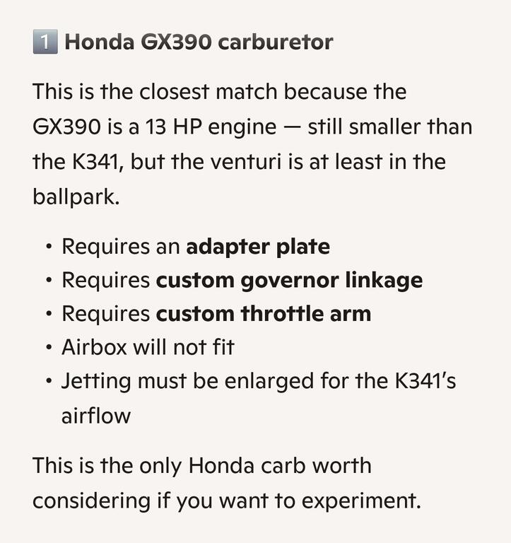

RJR49 179 #22 Posted August 23 Being curious I checked Amazon for Honda Carburetors. I was shocked at the price variation. $25.00 to $250.00! I asked AI and the attached picture basically says "don't do it" 1 Share this post Link to post Share on other sites
