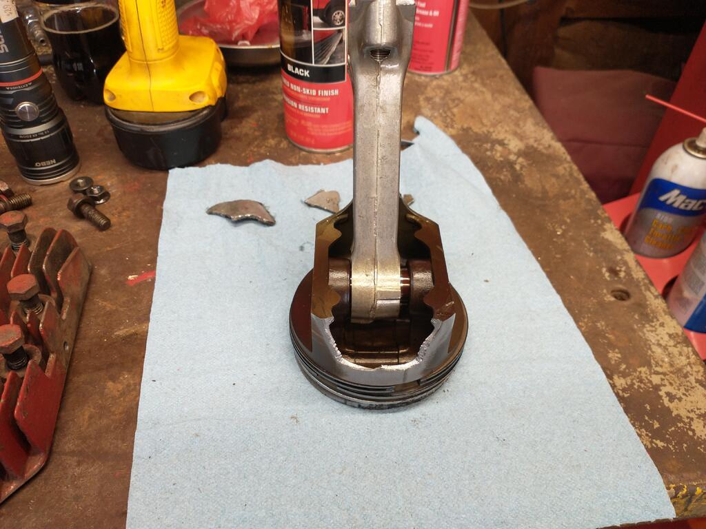

squonk 47,488 #3 Posted 4 hours ago Could even be a busted piston skirt. I found this in my C-160 engine that was still running. Using oil with little smoke and not much in the way of unusual noises. 1 Share this post Link to post Share on other sites
