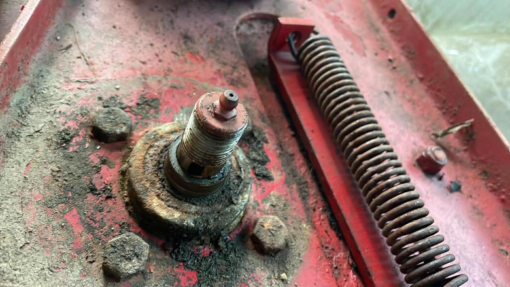

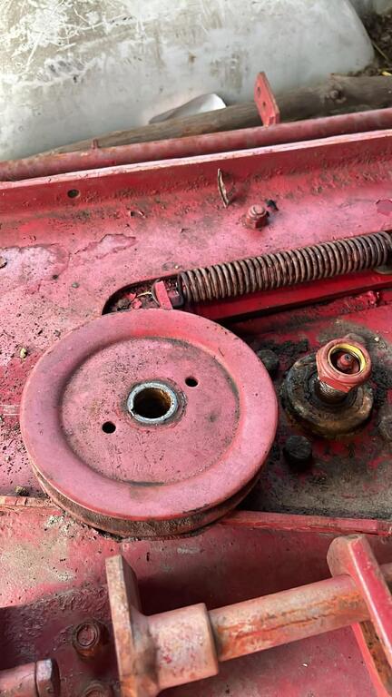

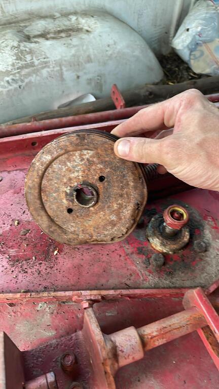

EthanL 69 #1 Posted August 9 This is the center drive stacked pulley off my 48” mower deck I just picked up. I have looked everywhere and can’t seem to find it. The only style I can find are the double D types. Is anyone able to point me in the right direction or give me a part number? It is a 3/4” keyed shaft and the pulley measure 5” across. I will be uploaded more pictures tomorrow. Share this post Link to post Share on other sites

76c12091520h 4,284 #5 Posted August 9 Part # 106073 , center keyed pulley for a 48" deck. Plenty in stock here 2 Share this post Link to post Share on other sites
