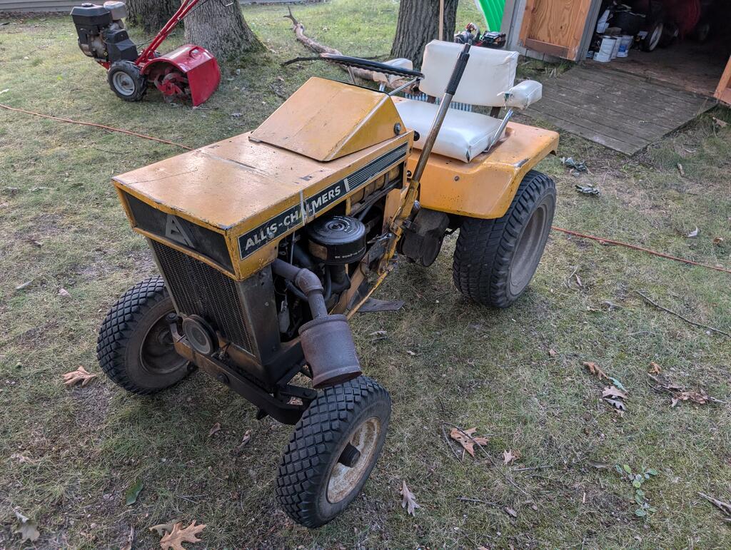

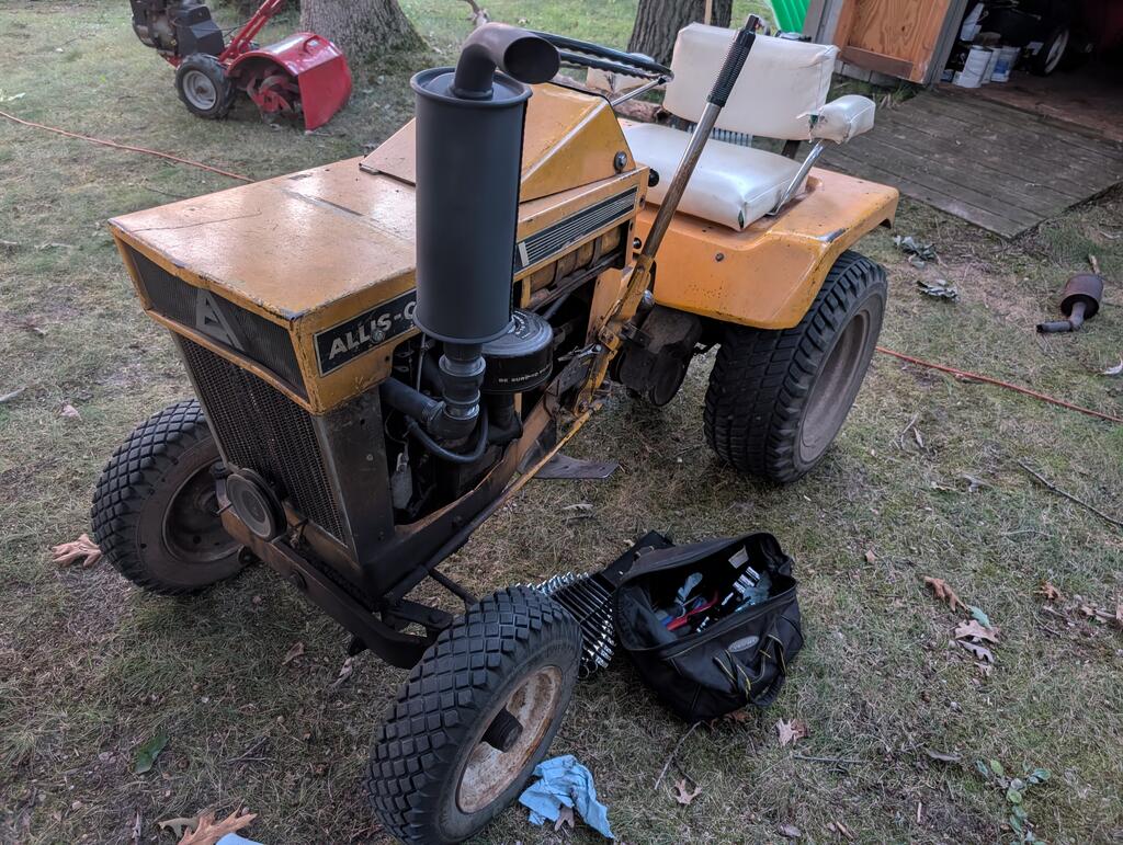

8ntruck 9,246 #5 Posted August 21 (edited) PICTURES!!!!!!! After Before I guess that the new muffler is quieter, 'cause the backfires now sound louder. I fired it up just after the sun set. It is very definitely backfiring through the exhaust - yellow flame out of the stack about 18" long! The backfire is not as bad with a bit of choke applied, so as soon as the B&S jet removal tool arrives, I'll start with a carb rebuild. If that does not help, the head will come off to get a good look at the valves. Sticky? Out of adjustment? Need reseating? Edited August 21 by 8ntruck 1 Share this post Link to post Share on other sites
