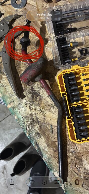

SamHit 15 #1 Posted August 5 The 1/4”-20 dog set screw that holds the shifter in place in the transmission, on my 312-8, broke. I can’t get the screw out of the donut, I’ve tried a screw extraction kit but just can’t get it to grab and remove the screw. Any recommendations on other things to try? Or does anyone have a shifter they’d be interested in selling? I’ll attach a photo of the shifter. Share this post Link to post Share on other sites

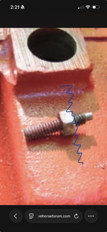

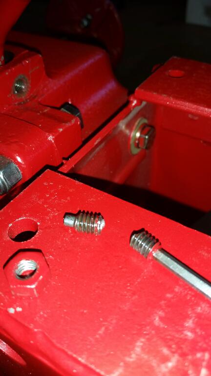

953 nut 70,262 #6 Posted August 5 The attached thread has very good photos of the part and pieces we are looking at here. Take a look at them and let us know what you think. 1 1 Share this post Link to post Share on other sites
SamHit 15 #7 Posted August 5 The set screw broke at this point. The right side is in the donut of the shifter, stuck in place. If that doesn’t make sense I will send a close up tonight of what it looks like currently. The other half is still in place in the transmission where it’s meant to screw in. So I can account for both parts, and don’t have concern that it fell into the transmission. 3 1 Share this post Link to post Share on other sites
