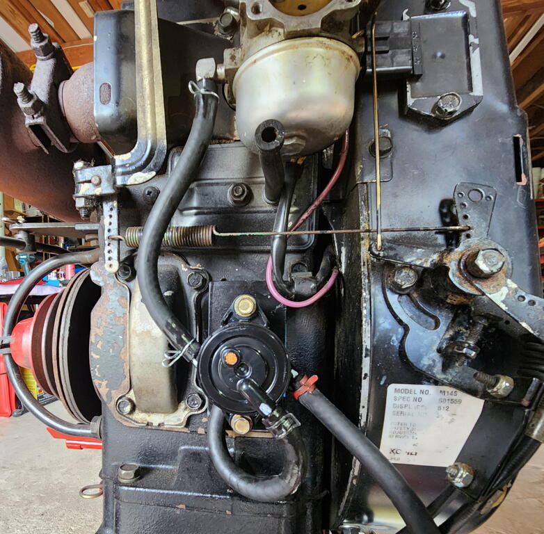

Looking for a brand new mechanical fuel pump for a 1990 Wheel Horse 310-8 tractor.

@JOEPOE1977  realise you want original type of pump , only a suggestion , been using  CARBOLE LOW PRESSURE  3,5 PSI , pumps for years , very solid reliable , get a  blank   engine plate to  cover engine mounting spot  .easily hooked up to run on ,switch , never had an issue many hours / years , also have a fuel filter  at tank and just before carb . pete
Bill D
I made a mounting plate and installed a vacuum pump.  Have several machines running these.
  • Like 2

Vacuum pumps work well. The only hard spot I have for them and the mechanical pumps is that if the diaphragm develops a leak you will be sucking gasoline into the crankcase of your engine.       :twocents-02cents:

I have had 2 mochines do this (857 and 701) luckily, I caught both before they had gotten real bad. I went back with rebuilt Mech pumps but have used Electric pumps on others and have had great luck with them. If you don't mind not being a "traditionalist" electric is only way to go IMO.
