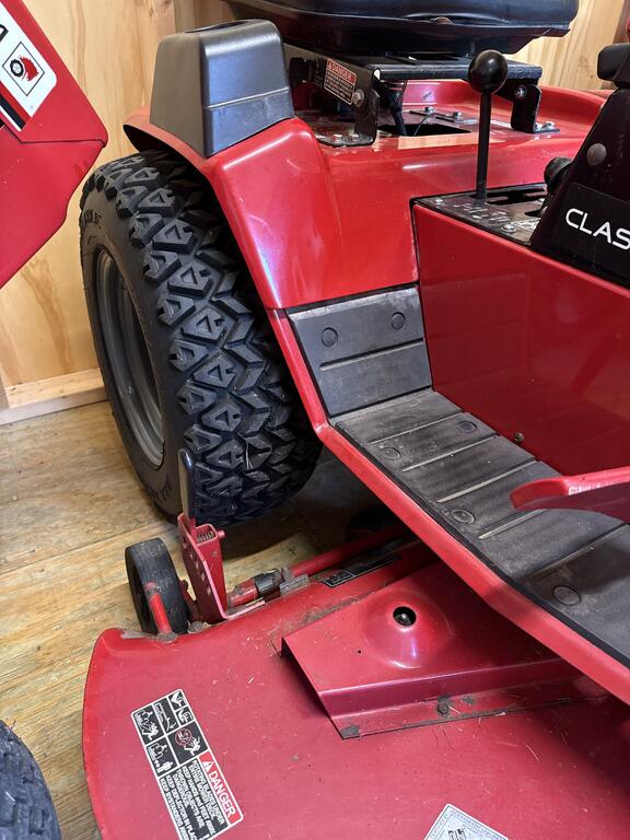

   Not a fan of ag tires. The Carlisle All-trails (Carlstar their called now I think) are my favorites and I run them on a couple of my machines. They are not a directional tire.
  The ones in this pic are 23 x8.00 x 12’s .
