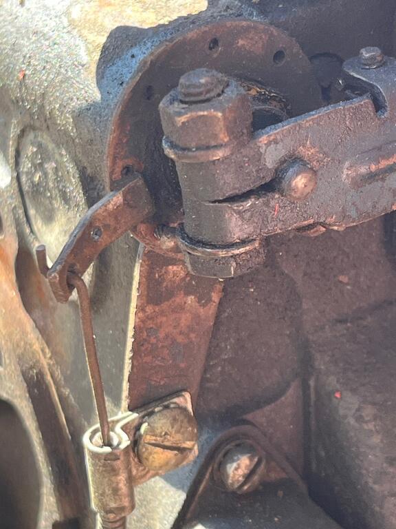

1968Commando 189 #1 Posted August 1 Hey all, I’m trying to work on my wheel horse a little bit here, well for some reason I swear my throttle is either idle, or full throttle no inbetween, it’s a k181 on a commando 8 80729712277__A6E2EF28-3946-421D-91F4-70B6B11217C7.MOV Share this post Link to post Share on other sites

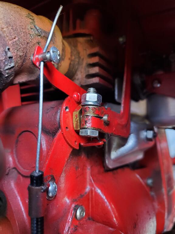

wallfish 20,600 #3 Posted August 1 (edited) Whenever the cable is connected directly to the holes in the disk that happens. Very fast throttle response. A Wheel Horse spec engine would have a small arm that was welded to the disk so the cable connection was a bit farther distance away from the center fulcrum point. Therefore it would take a longer distance to travel from idle to full rpm. This is what that arm looks like Edited August 1 by wallfish 2 1 Share this post Link to post Share on other sites
1968Commando 189 #4 Posted August 2 Well shoot ok guess I’m gonna have to fix that Share this post Link to post Share on other sites
wallfish 20,600 #5 Posted August 2 14 minutes ago, 1968Commando said: Well shoot ok guess I’m gonna have to fix that Yours would be located about 2 O'clock with the cable coming from the top. Mine shows the cable coming from the bottom. And you'll need to trim the conduit back a bit on yours to leave some room so the cable inside is exposed more. Share this post Link to post Share on other sites
1968Commando 189 #6 Posted August 2 On 7/20/2026 at 4:19 AM, Retired Wrencher said: It will get better after you settle in your new house. On 7/28/2026 at 8:52 AM, sqrlgtr said: If it's just air bubbles and nothing under there you may be able to take a pin and poke small hole in them and get air out. I have done this before and have had pretty good luck doing it that way. You could try one and see, Ive never tried it on the silver dash decal though and pin hole may be more visible than its worth. 9 hours ago, wallfish said: Whenever the cable is connected directly to the holes in the disk that happens. Very fast throttle response. A Wheel Horse spec engine would have a small arm that was welded to the disk so the cable connection was a bit farther distance away from the center fulcrum point. Therefore it would take a longer distance to travel from idle to full rpm. This is what that arm looks like C Share this post Link to post Share on other sites

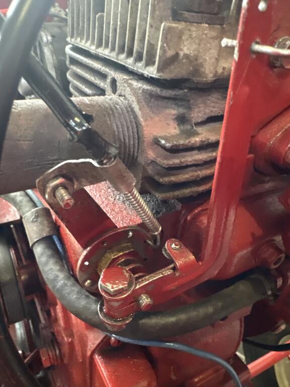

Racinbob 13,188 #7 Posted August 2 I didn't have a disc with the arm so I made one. 2 2 Share this post Link to post Share on other sites
Retired Wrencher 6,987 #8 Posted August 2 1 hour ago, Racinbob said: I didn't have a disc with the arm so I made one. Bob does the part you made for the disk, does it move at all? Meaning it has one small bolt holding it there. Share this post Link to post Share on other sites
Racinbob 13,188 #9 Posted August 2 There's actually two. The second one is hidden in the pic.That disc has to move. The added arm is relieved to clear the brass nut, the holes tapped to, I think 4-40, JB Welded to together, bolts have Loctite, then ground flush on the backside for clearance. 1 1 Share this post Link to post Share on other sites
Lane Ranger 12,105 #10 Posted August 2 Those throttle setups are tricky little devils! It takes a lot of messing with them to fully see the way they are supposed to work. Even the early Kohler motor books do not give the most detailed explanations! good job Bob ! Share this post Link to post Share on other sites
