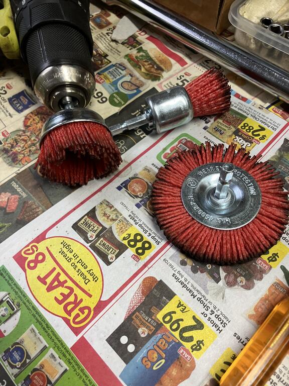

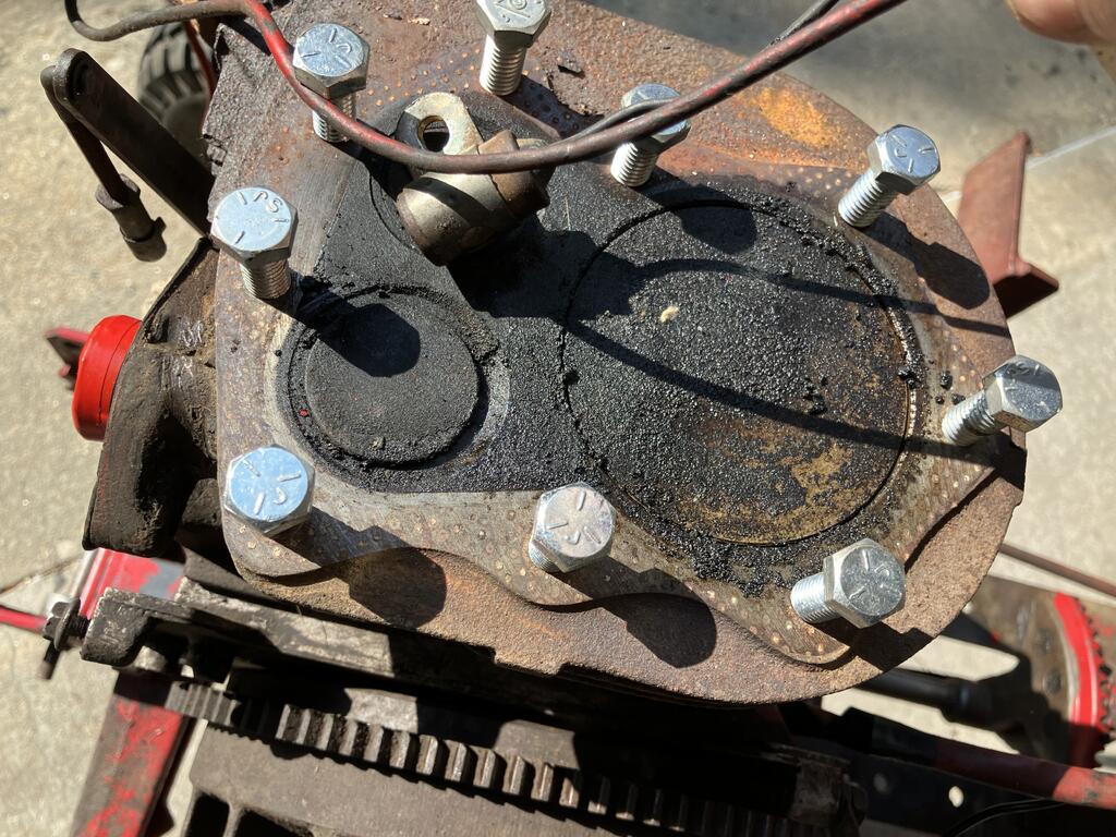

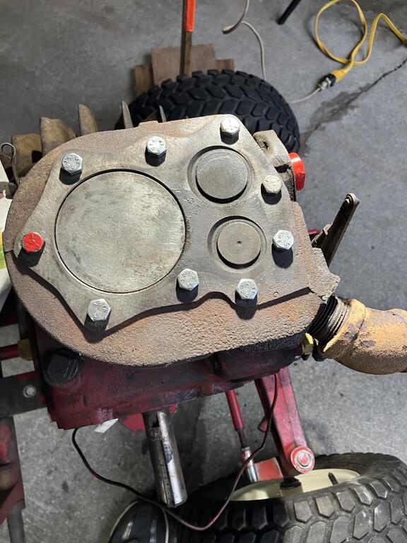

Retired Wrencher 7,042 #1 Posted August 1 I was on you tube a few weeks ago, and I found this page that had a case dealership in Connecticut I believe.. He had this new tool that I’ve never heard about how to safely clean the top end of the engine and the head. It’s nylon attached to steel that you can put in your drill or whatever. You spray it down with like fantastic or some kind of household cleaner, but let it sit for about 10 minutes. These nylon attachments made the whole head and top of the engine clean within a 10 minutes. I was truly impressed on that. The other bonus it doesn’t leave any scratches or gouging of the material which according to this video it’s the first place where carbon will build up. So here’s a couple pics before and after this was about 10 minutes worth of work. The orange is course this kit came with two others gray, which is a medium grit and I believe the blue is a fine grit. I’m sold on this so far much easier. I used to use steel but at left a lot of scratches. 14 Share this post Link to post Share on other sites

ebinmaine 81,273 #3 Posted August 1 Looks like this gives excellent results. Remember to hand plane the cylinder head for flatness too. 2 Share this post Link to post Share on other sites

Bar Nuthin 3,639 #19 Posted November 16 (edited) On 8/1/2026 at 7:01 AM, 953 nut said: D you have a link to the video or the product? I believe these are the style of discs he's referring to. I can't see @Retired Wrencher's photos. Available from several different suppliersin arbor style or the twist in Roloc style, with 3M/Scotchbrite being a premium mfr. When I worked at a GM dealership, GM mandated this type of disc over the standard ROLOC discs due to fibers that could possibly shed. click photo to see on Amazon Edited November 16 by Bar Nuthin 1 Share this post Link to post Share on other sites
Retired Wrencher 7,042 #20 Posted November 17 20 hours ago, Bar Nuthin said: I believe these are the style of discs he's referring to. I can't see @Retired Wrencher's photos. Available from several different suppliersin arbor style or the twist in Roloc style, with 3M/Scotchbrite being a premium mfr. When I worked at a GM dealership, GM mandated this type of disc over the standard ROLOC discs due to fibers that could possibly shed. click photo to see on Amazon Bar: I believe mine are flat style. Like sandpaper style. I do have your style in a package deal. Have not tried them yet. Good luck with them. 2 Share this post Link to post Share on other sites
