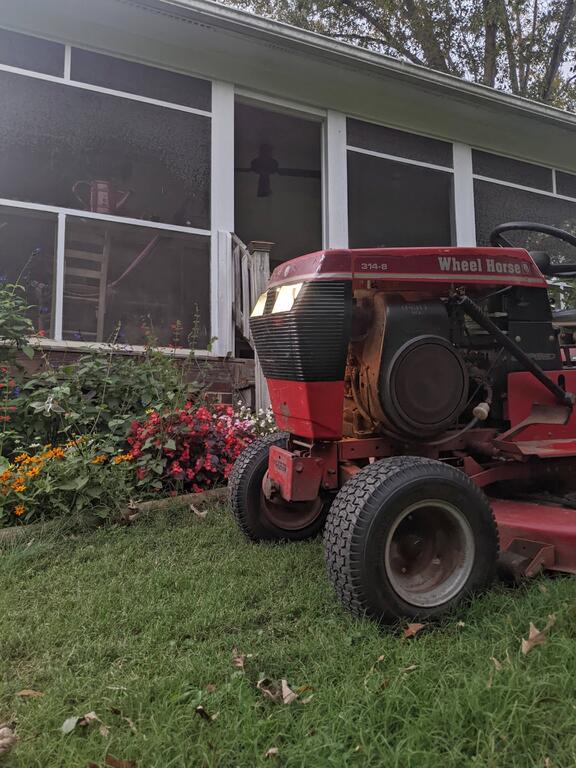

Rubix 5 #1 Posted July 31 (edited) Where are we buying new carbs and fuel pumps for Kohler K series engines now that isavetractors is shut down? Or, where are we buying rebuild kits for original carbs and fuel pumps? Anything out there these days or are we stuck with lower quality ebay and amazon parts? My old WH 314 k321s has been giving me trouble all summer with power loss in tall grass or under heavy load and now will not start. New condenser, capacitor, points, spark plug wire, and spark plug installed last year. It seemed like it was starving a month ago so it got a new spark plug (again already), air filter, fuel filter this year, and the carburetor screws reset per the manual after the new air filter and it ran great. I've double checked all electrical - continuity is all where it should be regarding my bypassed safety switches. I noticed my clear plastic in line fuel filter seems to be holding a little more fuel than usual. I'm left thinking it must be the fuel pump, I'll pull the hose at the carb tomorrow and see if I'm getting fuel when cranking. While I'm at it though, I have to assume this is the original ~40 year old carb; I've never replaced it since I bought the tractor in 2011 and maybe the float is bad. I've always bought my parts from isavetractors, but now I'm lost. I've read about the plastic fuel pumps on amazon and ebay, ugh. What about carbs, does anyone sell quality stuff like isavetractors did? Thanks in advance. Edited July 31 by Rubix Share this post Link to post Share on other sites

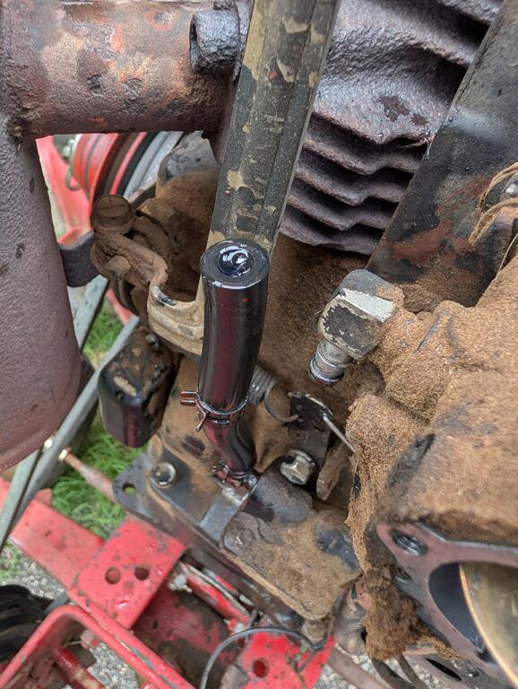

Rubix 5 #6 Posted August 2 (edited) Well I have to rule out fuel issue. I pulled the fuel line where it joins the carb and cranked the engine and fuel is pushing quite nicely as it turns over, so I can rule fuel pump out. This engine just cranks and cranks but will not fire up, I guess I'm going back to electrical tinkering. I appreciate the links and the knowledge, excellent info! Edited August 2 by Rubix Share this post Link to post Share on other sites
953 nut 70,648 #7 Posted August 2 28 minutes ago, Rubix said: I pulled the fuel line where it joins the carb and cranked the engine and fuel is pushing quite nicely as it turns over, so I can rule fuel pump out. This engine just cranks and cranks but will not fire up, I guess Well, gas is getting to the carburetor, how is it doing from that point? Is the spark plug wet (too much gas) or totally dry (perhaps no gas)? Sounds like the next step is to remove, soak, (lots of tiny passages need to be cleaned, soaking is the best method) and rebuild the carb. Lots of posts on here about carb cleaning, read a few and select the path you will follow. Share this post Link to post Share on other sites
Rubix 5 #8 Posted August 2 I figured it out. My points had somehow fallen out of spec. Cleaned them, readjusted, she just fired up strong. And as I closed the hood, just when I thought I'd mow again here comes the thunderstorm 😂😭 Thanks again all, this forum is such a gem of knowledge 4 Share this post Link to post Share on other sites
