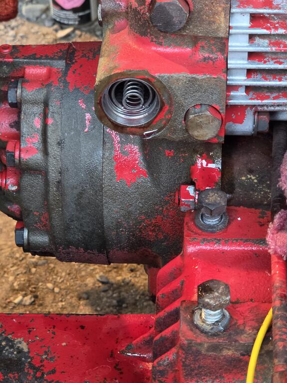

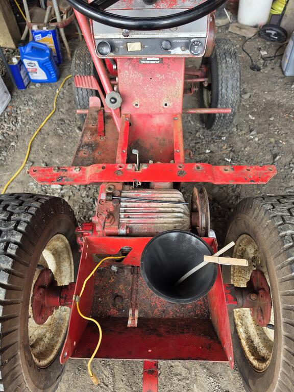

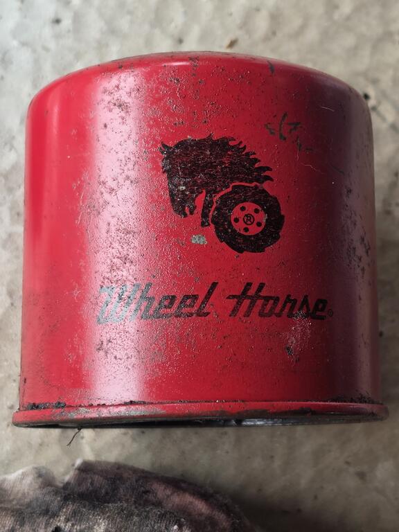

Hi all , got a question.  Working on a 1972 charger 12 with a sunstrand 90 - 1136 hydro gear.   The tractor sat for 30 + years . I drained atf ,the atf was dark, but no shinny parts in the pan. New atf, 1410 filter, service all the ports , checked springs, replaced all O rings, checked valves ( forward and reverse ), springs look good, no nicks or burrs . Took a red wh filter off, so it's been a while since last service
Question is how to get some atf up in the top of pump.  Don't want to dry start if possible. What do you guys think 🤔

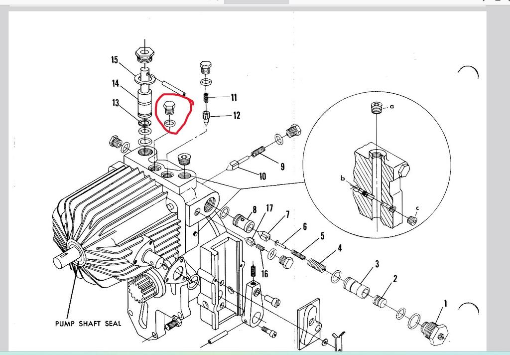

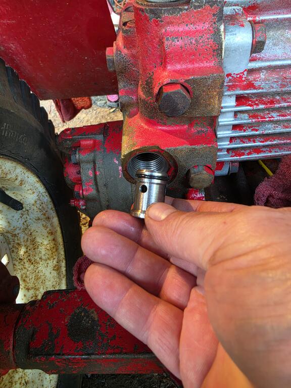

pfrederi
Pull circled plug
  • Thanks 1

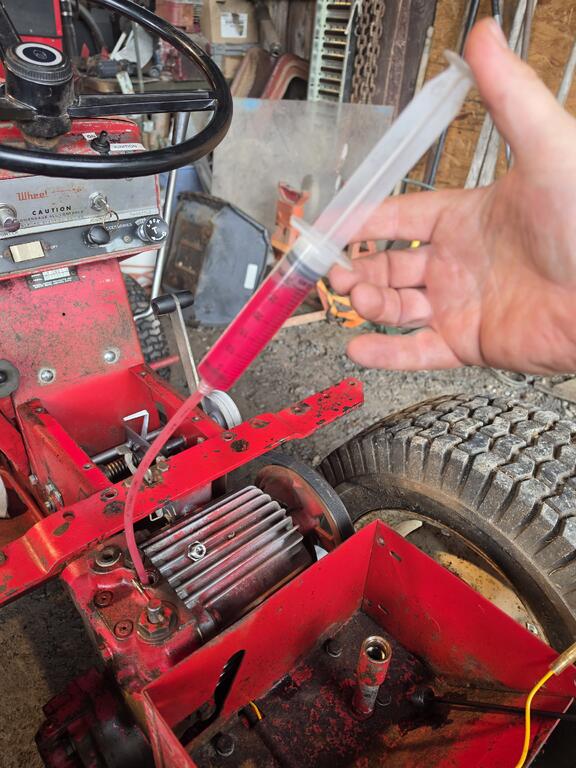

gt14rider
Thanks Paul,  added some atf,  tryed to fill others ports but didn't seem to take much,  I can just hear those brass slippers and pump grinding on a dry start.

rmaynard
The transmission holds 4 quarts. How much have you gotten in? Turn things by hand at first.
