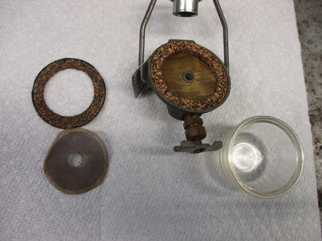

Walleye Guy 28 #16 Posted August 10 Was the original set-up a gasket and a filter screen as separate parts or was the gasket and screen one part (ie was the gasket molded around the perimeter of the screen)? Share this post Link to post Share on other sites
pfrederi 21,150 #17 Posted August 10 3 minutes ago, Walleye Guy said: Was the original set-up a gasket and a filter screen as separate parts or was the gasket and screen one part (ie was the gasket molded around the perimeter of the screen)? Separate 1 Share this post Link to post Share on other sites
sqrlgtr 3,929 #18 Posted August 10 This is the one I replaced mine with. Never could keep the old one from leaking from around the fuel shut off and I tried a couple times . 1 Share this post Link to post Share on other sites
Walleye Guy 28 #19 Posted August 10 (edited) 42 minutes ago, pfrederi said: Separate So, TWO gaskets and one screen were required? Or did you set extra parts next to each other for clarification? Edited August 10 by Walleye Guy Share this post Link to post Share on other sites
Handy Don 17,474 #20 Posted August 10 1 hour ago, Walleye Guy said: So, TWO gaskets and one screen were required? Or did you set extra parts next to each other for clarification? The original might have had the screen gasket-sandwiched into a single part, but I separated and used two gaskets. Share this post Link to post Share on other sites
pfrederi 21,150 #21 Posted August 11 15 hours ago, Walleye Guy said: So, TWO gaskets and one screen were required? Or did you set extra parts next to each other for clarification? One gasket one screen..note the discoloration on the screen on the left. It is not as big around as the gasket so the gasket completes it seal out side the screen Share this post Link to post Share on other sites
