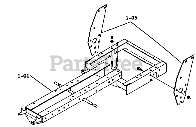

Hello,
I'm wondering if anybody could share information as to how the snow blade rear bracket mounts on an 800 special? I've put them on numerous tractors with uni-drive transmissions, but never put one on an 800 special.
According to wheel horse parts and more, the same rear bracket for the  300, 400, B, and C series tractors fits the 800 special also. Just wondering if anybody has a couple of pictures or diagram of how it goes on with that different frame set up with the peerless gearbox.

If I remember correctly all you need are the latches as the frame has the U shaped part built into it.  My 800 Special is about 35 miles away from me at present'
