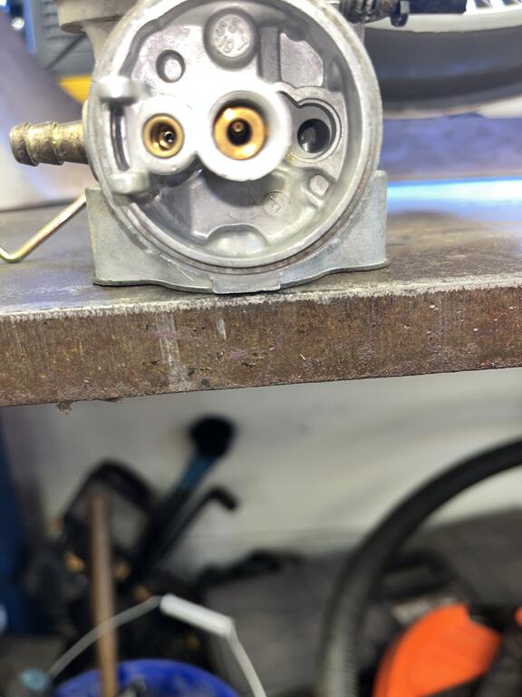

Wvtroutbum81 327 #4 Posted July 30 Took the carb off to clean, is the jet supposed to be off to the side like this? how do you get this apart? Share this post Link to post Share on other sites
sqrlgtr 4,077 #5 Posted July 31 If it has been fine for a couple years probably just needs a good cleaning, hard to tell what ya looking at in pic. If fuel lines are old or not a good brand that may be where the drugs are coming from. I don't skimp on fuel lines any more learned my lesson on that. Went through a time when I would have to take carb off every so often to clean, couldn't figure out were trash/drugs was coming from, come to find out fuel lines were deteriorating and stopping everything up including filling fuel pump up with fine black particles. this was with some cheap fuel line I had bought local. I don't run anything but the 30R14 name brand stuff now, cost a little up front but well worth it in the long run. To me anyhow. Share this post Link to post Share on other sites
ineedanother 2,879 #6 Posted July 31 Not sure what carb you're showing and I'm (definitely) no expert but it looks like a fixed main jet. Off-center is fine. Spray up through and you'll see where it dumps into the body (no emulsion tube). Spray back down from the top and clean it as best you can. Looks pretty clean. Your issue is likely float adjustment or the seat on the jet (on the left) not seating and overfilling the bowl which is flooding the intake. That could have been from debris in the bowl. How did that look when you disassembled it? Share this post Link to post Share on other sites
