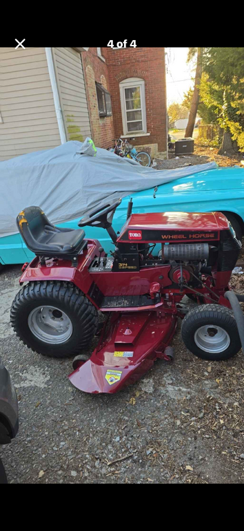

Margie 17 #1 Posted July 27 Hi everyone!! I’m new to this forum and new to tractors in general. Recently fell in love with Wheel Horses. I would love if anyone here could give me some advice. My property 2 acre property has some slight hills and I have some light hauling projects (500lbs and less). I’m looking at a 314-8 with mower deck and snow blower for $1500. Starts up strong with no smoke. 1000 hrs. No rust. Oil and spark plug look good. As a newbie does this sound like a good idea? Thanks in advance for any advice or feedback!!! Have a great day!! 2 1 Share this post Link to post Share on other sites

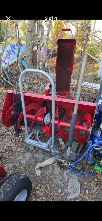

gwest_ca-(File Mod) 12,557 #2 Posted July 28 Welcome to Red Square. Sounds reasonable to me but I'm in that foreign country to the north. It would be worth asking the seller to walk you through the removal of the mower deck. Then ask if they would install the snowthrower. That way any loose pieces should not get missed and there are a few. Raising the thrower is assisted by a spring - armstrong without it since you have no hydraulic lift. If you can get the model and serial numbers off each we should be able to link you to the correct manuals. 2 Share this post Link to post Share on other sites
Ed Kennell 47,942 #3 Posted July 28 to the It all looks clean in the pictures. Has it been stored outside? It would certainly be capable of handling the mowing and towing chores. I personally prefer hydro transmissions and hydraulic lifts especially for snow removal. $1500 seems a bit high. A clean 300 series is 6-700 a good 42 or 48" deck 2-300 good tall chute blower 200 Good Luck. 2 Share this post Link to post Share on other sites
953 nut 70,648 #4 Posted July 28 A properly maintained Wheel Horse will provide decades of service and this appears to be a pampered unit. While $ 1.500 seems to be strong money for a used garden Tractor, mower, and snow blower attachment you would be spending twice as much for a new Big Box comparable package that would need to be replaced in a few years. Many of us use Wheel Horses from the 1970s and 1980s that are servicing like new and will continue to serve another generation or two. 6 Share this post Link to post Share on other sites
Pullstart 71,561 #5 Posted July 28 For that coin, I would think you could find something with either more attachments, or some weights and chains on the tires, etc. It is a very nice looking tractor. Let’s make sure the steering is tight, no funky noises in the engine, belt, clutch, transmission, etc. If it was well maintained, the money put towards this for your 2 acre estate makes way more sense than a throw away mower from a box store! 5 Share this post Link to post Share on other sites

Achto 32,962 #8 Posted July 28 12 hours ago, Ed Kennell said: good tall chute blower 200 It is a 2 stage - that might fetch a little higher price. Share this post Link to post Share on other sites
parsonsponyz 420 #9 Posted July 28 to Red Square. Nice looking machine. I will agree with what has been previously posted. Seems to be top dollar for the tractor so everything should be in good working order. 1 Share this post Link to post Share on other sites
Ed Kennell 47,942 #10 Posted July 28 3 hours ago, Achto said: It is a 2 stage - that might fetch a little higher price. Good eye Dan. I missed that. Just sold my Ber Vac for $400. 1 Share this post Link to post Share on other sites
Rick3478 478 #11 Posted July 31 The 314-8's are great tractors. That two stage blower is heavy, even with the assist spring. Make sure the steering is greased up good and front tires pumped to max. I'd also recommend adding rear wheel weights and chains to the winter setup. Share this post Link to post Share on other sites
