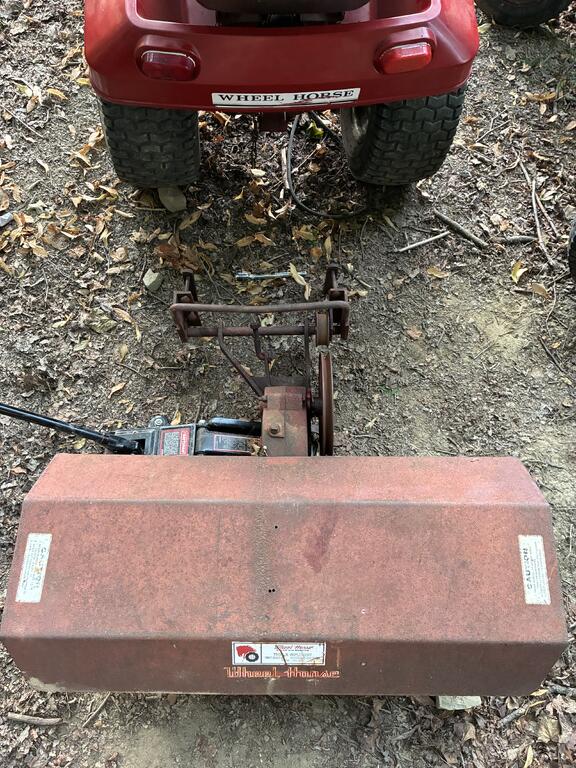

SamHit 15 #1 Posted July 27 I have this rototiller (I think model number 7-1211) and the mowers I have are 312-8 and C-175. I’m wondering if there is any way to adapt it to fit one of the mowers I have? Or if anyone is interested in it, I’m located in northeast Ohio. Share this post Link to post Share on other sites
kpinnc 19,105 #2 Posted July 28 That should fit either of the machines you mentioned. When using a tiller, 8 speeds are far superior. The tiller "pushes" the tractor so low 1st gear works very well. You can use with a hydro but you will fight against the tiller any time it's digging. 2 Share this post Link to post Share on other sites
