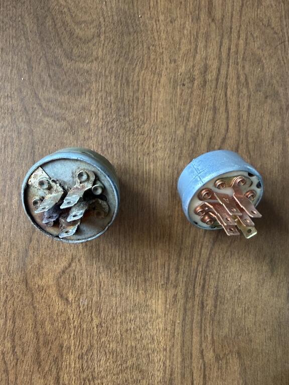

AHS 1,701 #1 Posted July 26 i was messing around with headlights and left the key on for 6 hours. Oops!! What a bone head!! So, the lights would work. I turned it to start and nothing. I took out the key switch, expecting to find a 6 prong and i only find 5!! wait… a Magnum and a 5 prong key switch?? now, the 5 prong looks old, likes It’s been in the tractor for quite a while AND it runs excellent! Now, the 5 prong looks like the lower right hand prong looks like it runs the key switch…but the continuity meter says otherwise! I don’t know what to do? Just replace it w/ a 100990 or… reaplace it with a 100991 6 prong and run a ground wire? Share this post Link to post Share on other sites
gwest_ca-(File Mod) 12,488 #2 Posted July 26 It is a switch for magneto ignition #116338. If you replace with another part number switch makes sure the other terminals are connected to the appropriate wire. 1 Share this post Link to post Share on other sites

953 nut 69,292 #4 Posted July 27 22 hours ago, AHS said: reaplace it with a 100991 6 prong and run a ground wire? NO! All 300 and 400 models that were equipped with Kohler Magnum engines from 1987 to 1991 used the 103991-ignition switch and from 1992 to 1997 they all used the 116338-ignition switch. These two switches are not interchangeable. Share this post Link to post Share on other sites
