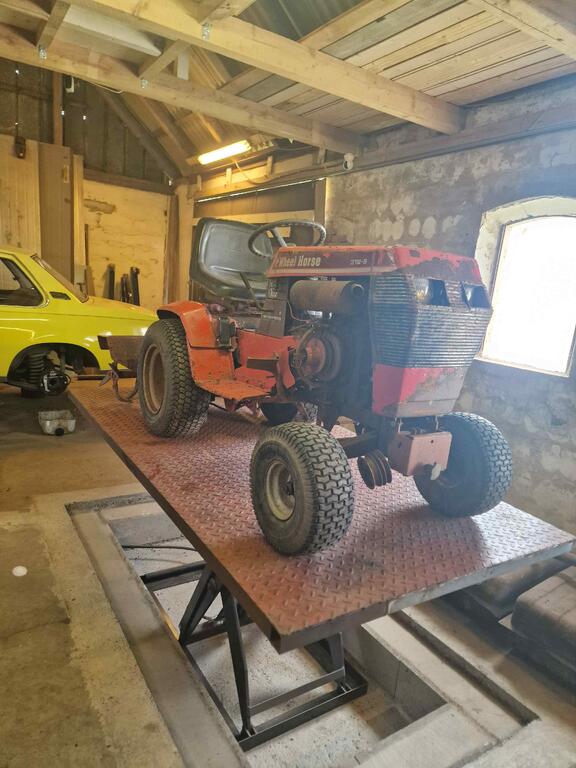

hello there - got a 312-8 the other day and the previous owner made som modifications that im trying to undo. also im missing som parts and other things i dont think is for my machine or attachments.
here are my questions:
1. how to i find out what year my 312-8 is from ? its missing the decals with serial number, the m12s engine serial starts with 17 and it may be from 1987 ?

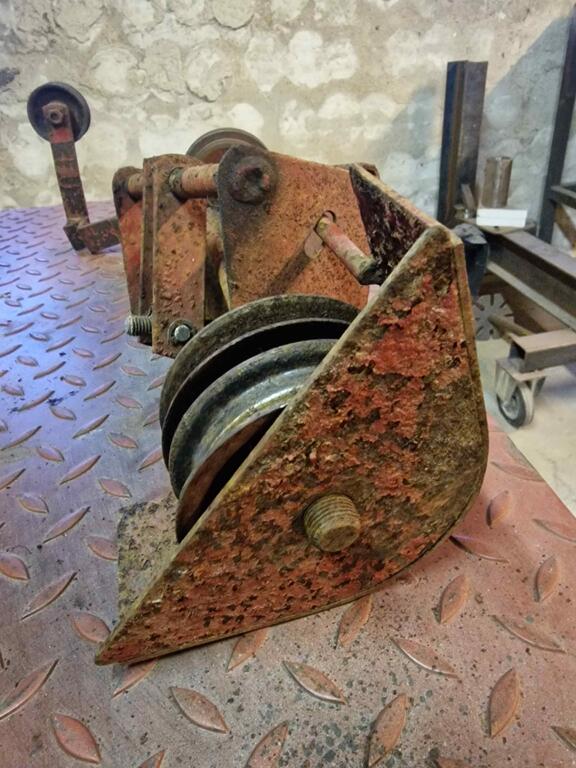

2. i got a big bracket that i dont know what is for, its not for my cutting deck, snowthrower or the rototiller.

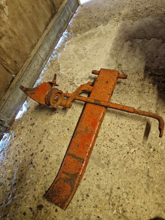

3. i got a smaller bracket that i also dont know is for, im missing the bracket that sits under the pto for my tiller, is there any one that has some messurements for it ? im thinking of making my own as getting used parts is kinda hard here in denmark where i live :)

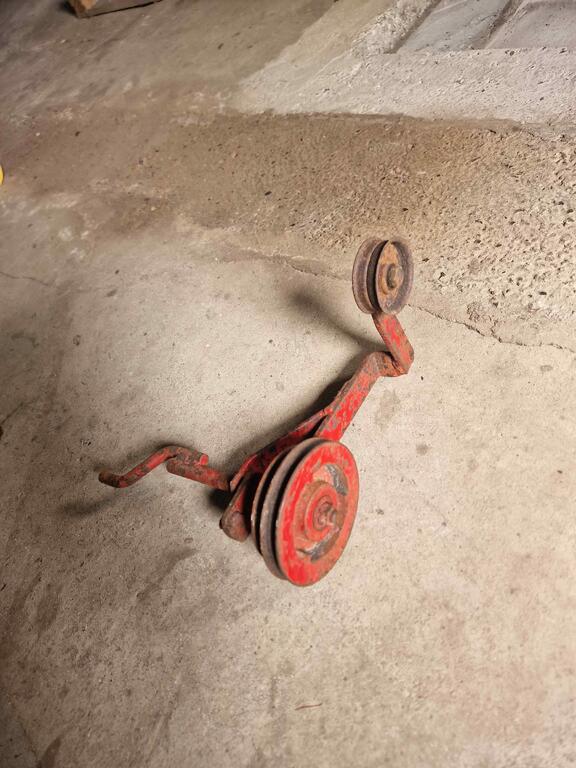

4. the front pully assembly (mule drive?) is missing the nut and id like to know what size thread it has so i can buy a new one.

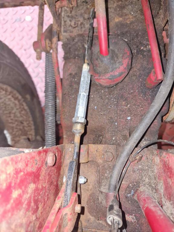

5: and lastly i think the linkage to the rear slot hitch is some homemade crap, it hits the rubber boot for the shift linkage, is that not supposed to be a wire ? can anyone tell me what the part number is for the complete cable im missing.

i think the nut for the mule drive is a 3/4" UNF - correct me if im wrong :)

Yes, the nut is 3/4" 16 fine thread.
You will find your rear lift parts and more here.
https://wheelhorsepartsandmore.com/

Is your engine spec number 471546?
Good chance your tractor is a 1988 model E1-12K801. It took a while for the engines to land on a tractor and 1988 models would have been available in October 1987.
That is the frame and side drive system for an older   (1960-1970) style mowing deck.
