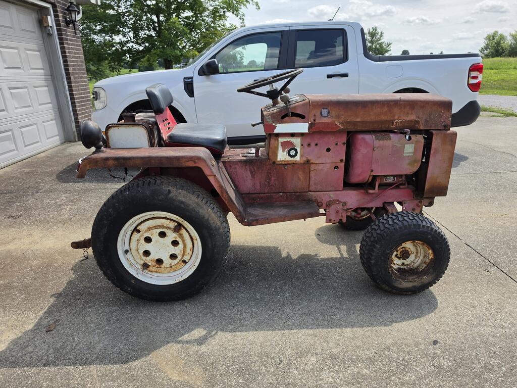

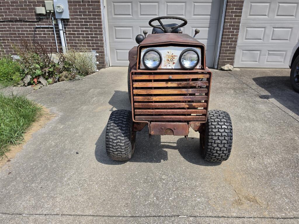

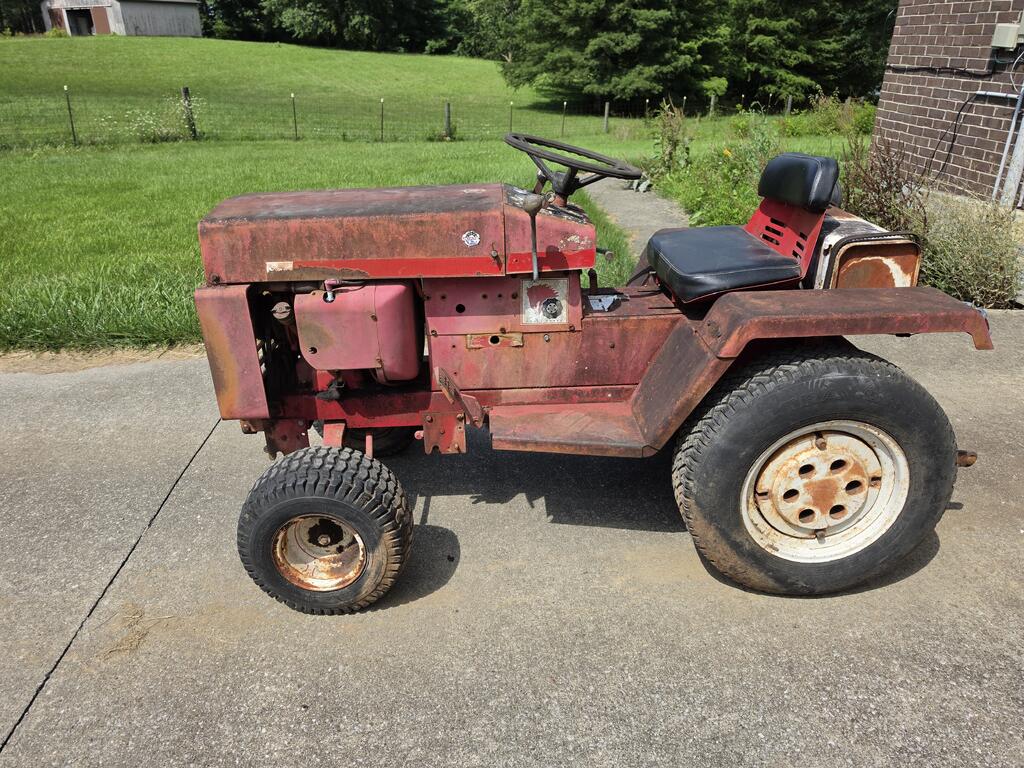

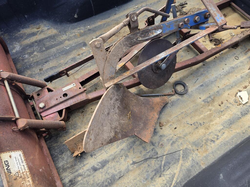

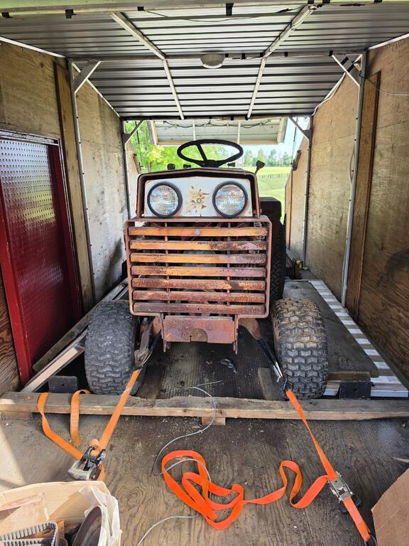

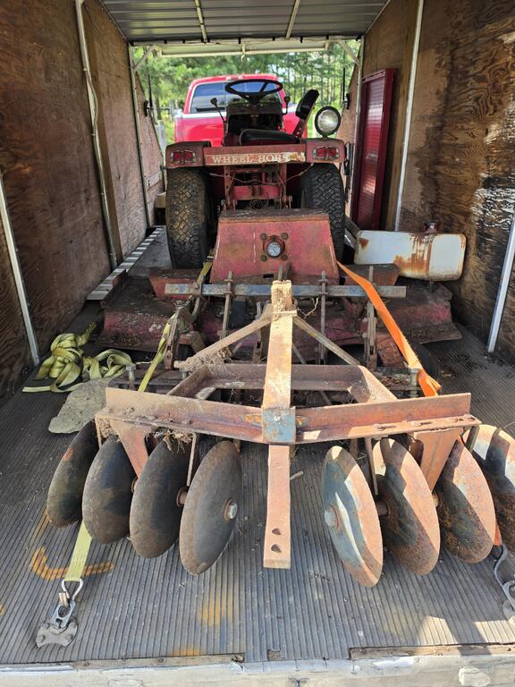

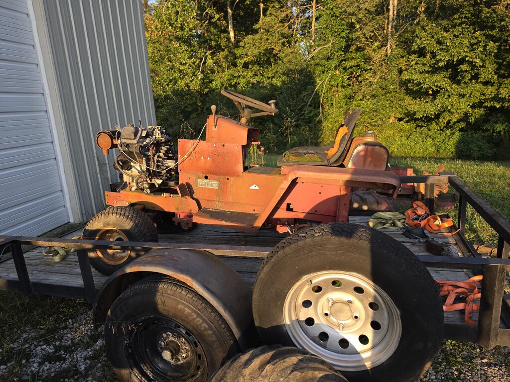

BradKahler 416 #1 Posted July 23 (edited) Well....it looks like I've got my winter project lined up, just picked it up today Found this one on FB and after thinking about it for a few days I contacted the seller and we made the deal. The ad listed the tractor, 5' pto mounted finish mower and possibly a push blade (if he could find it!). While I was on the road going to pick it up he texted me and mentioned they found a few more implements and I could have them if I wanted them. Heck yeah!! Included in the package was the tractor, finish mower, snow plow, Brinly disc harrow, what appears to be a Ford 3pt plow and a homemade 3pt plow, and what might be a homemade box blade although it looks pretty decent. It has the optional 15" rear wheels with rear wheel weights. The snow plow is for the B and C series tractors and the sad part is according to the seller, his father bought the blade in new condition from someone who never used it. So basically it's a brand new blade that's been sitting outside for at least 20-30 years. Oddly enough the seat looks almost brand new. It turns out every fall his dad would take the seat off and store it inside, putting it back on in the spring. The gas tank looks solid but there is a distinct possibility it will need to be boiled and then sealed inside to make it useable. The story behind the tractor is the sellers dad bought it 30 years ago and used it for 12 years before parking it, they started using a zero turn which was faster. For 11 of those 18 years that it sat outside unused. Seven years ago he moved it into his basement with the hopes of restoring it. Unfortunately he never got around to it. In theory, it was running and driving when parked. Oh yeah almost forgot, included was the original operators manual AND an original parts list. For the past few days I tried searching for a downloadable parts list and couldn't find one. I am going to scan this one and if possible upload it to the forum. Possibly someone could explain how to do the upload. One quick question, it needs mufflers, are there suitable replacements available that don't cost $603 each as shown on the Toro site. Thanks! More to come.... Edit: it also came with a 3 pt cultivator and what i thought was the operator manual is actually a service procedure manual that describes all of the new features of the new 18 HP model with detailed descriptions and pictures. The manual was intended for the mechanics that went through their service school. Edited July 23 by BradKahler 3 5 Share this post Link to post Share on other sites
ol550 880 #2 Posted July 23 IMHO Owning a D series is similar to owning a boat, well at least for me, it's more than a winter project. It is more like every winter. In my case with the boat and D series. About as happy the day I got it and the day they left. Good luck and enjoy the adventure. 1 Share this post Link to post Share on other sites

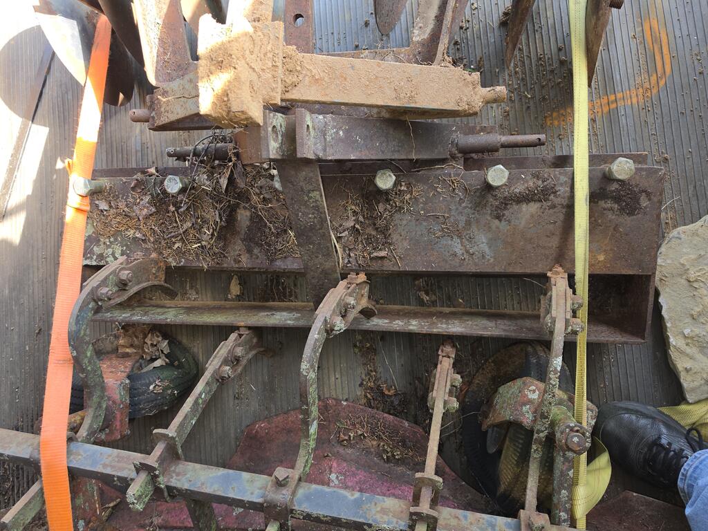

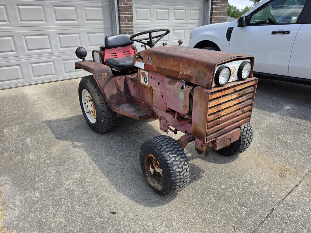

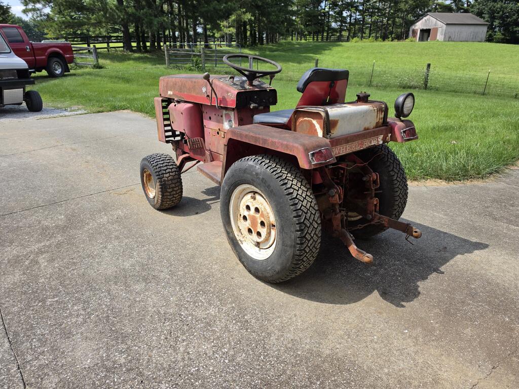

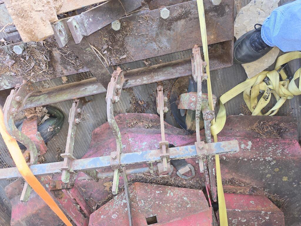

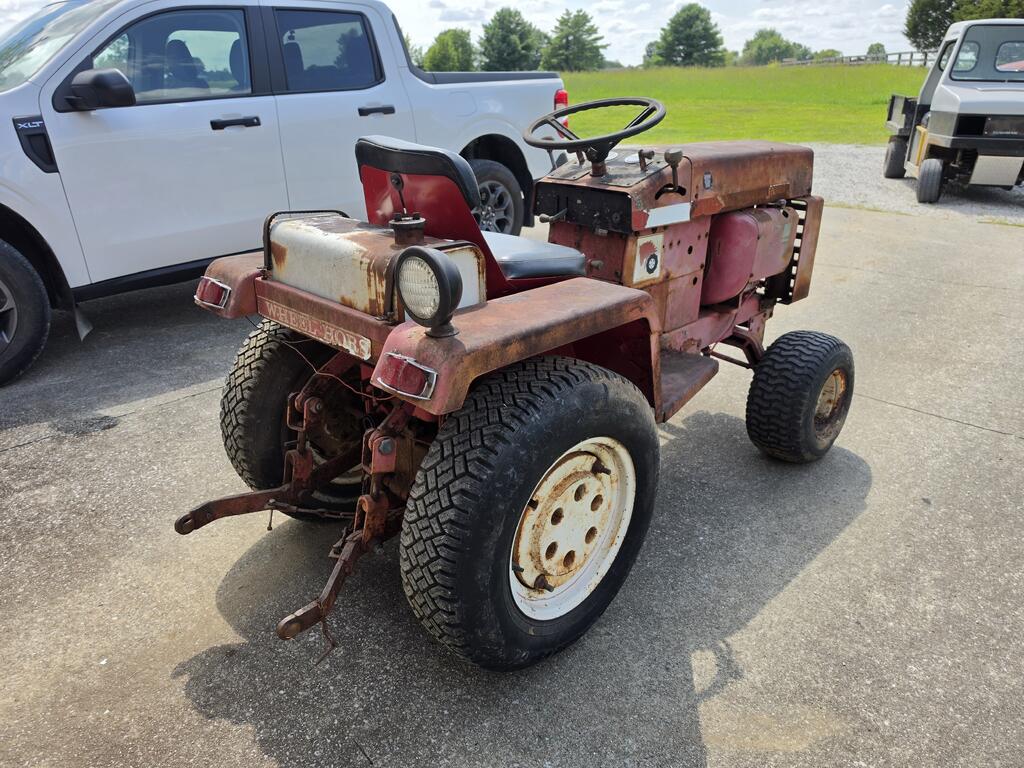

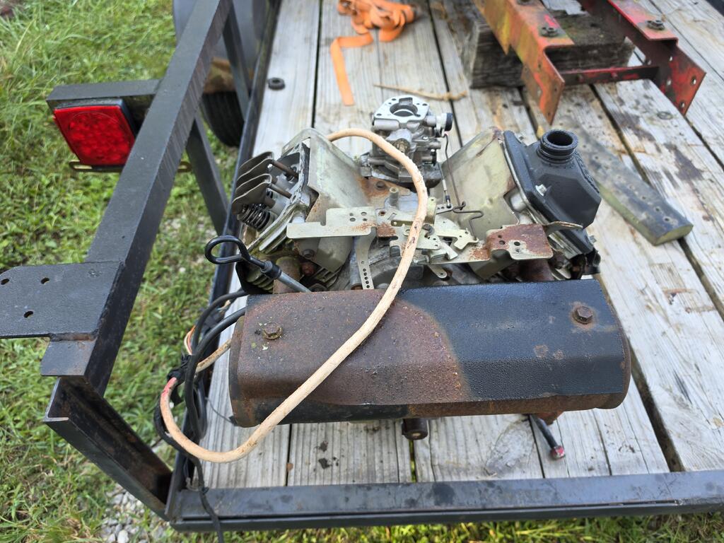

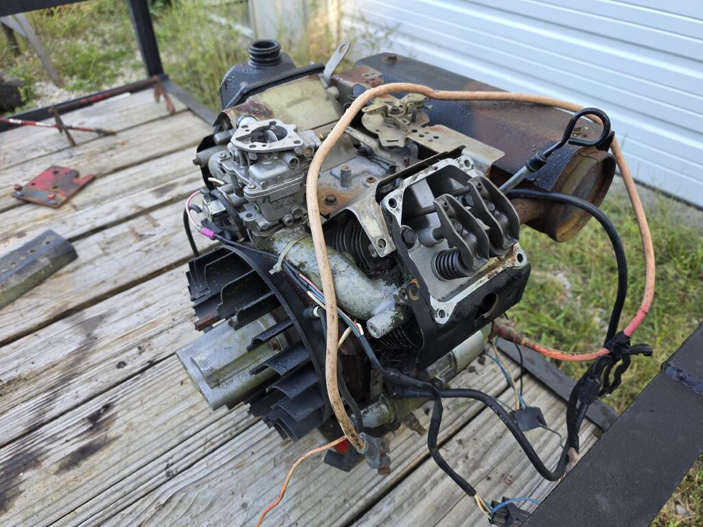

BradKahler 416 #3 Posted July 25 Got everything unloaded today and used the air gun to blow out all of the years of debris accumulation. The tractor is actually in overall pretty good condition considering it sat outside unused for at least 12 years. The engine does turn over and has compression so the first task will be to replace the fuel line, fuel filter and probably pull the carburetor and clean it in the ultrasonic cleaner. The engine oil looks good and the same for the gearbox oil. I plan on changing the engine oil before trying to start it and once the engine is running I'll change the gearbox oil and filter and then see if it will move under it's own power. After inspecting the gas tank I realized that it's not the original tank So I'm now on the hunt for an original replacement tank. I also found that while the air filter base is correct, it had the wrong filter and was using a hub cap for the cover So I'm also on the hunt for the correct air filter cover. While fiddling with the front grille I noticed that there were no holes for the bottom pins to fit into. Looking closer I found that the lower front cross member was installed upside down. I have since rotated the cross member and now the grille fits properly. I wonder how many years it has been like that. It doesn't have a battery tray so I've been searching for some sort of replacement. More than likely I'll just fabricate one myself so if anyone knows the dimensions that would help tremendously 2 Share this post Link to post Share on other sites
rjg854 13,454 #4 Posted July 25 Looks like it's all there, so the bones are good. Are you planning on restoring it? 1 Share this post Link to post Share on other sites
BradKahler 416 #5 Posted July 25 4 hours ago, rjg854 said: Looks like it's all there, so the bones are good. Are you planning on restoring it? Other than not having the correct gas tank and air cleaner cover it is in remarkably original condition. I think the seat amazed me the most, it's still soft and pliable and so far there aren't any cracks in it that I can see. Not to many 53 year old tractors still have the original seat in that condition For the time being, I'm just going to go through it mechanically and electrically to get it running and driving. I'll fix what needs fixing and after that's all done, if I have time then I just might try restoring it. I do have some questions. What size battery would have been installed? What size is the battery tray? The battery tray is missing so I'll likely have to fabricate one, but I have no idea on what size to make it or what it even looks like. Thanks! Brad Share this post Link to post Share on other sites

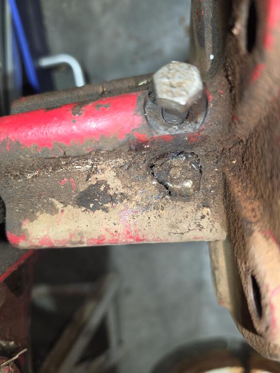

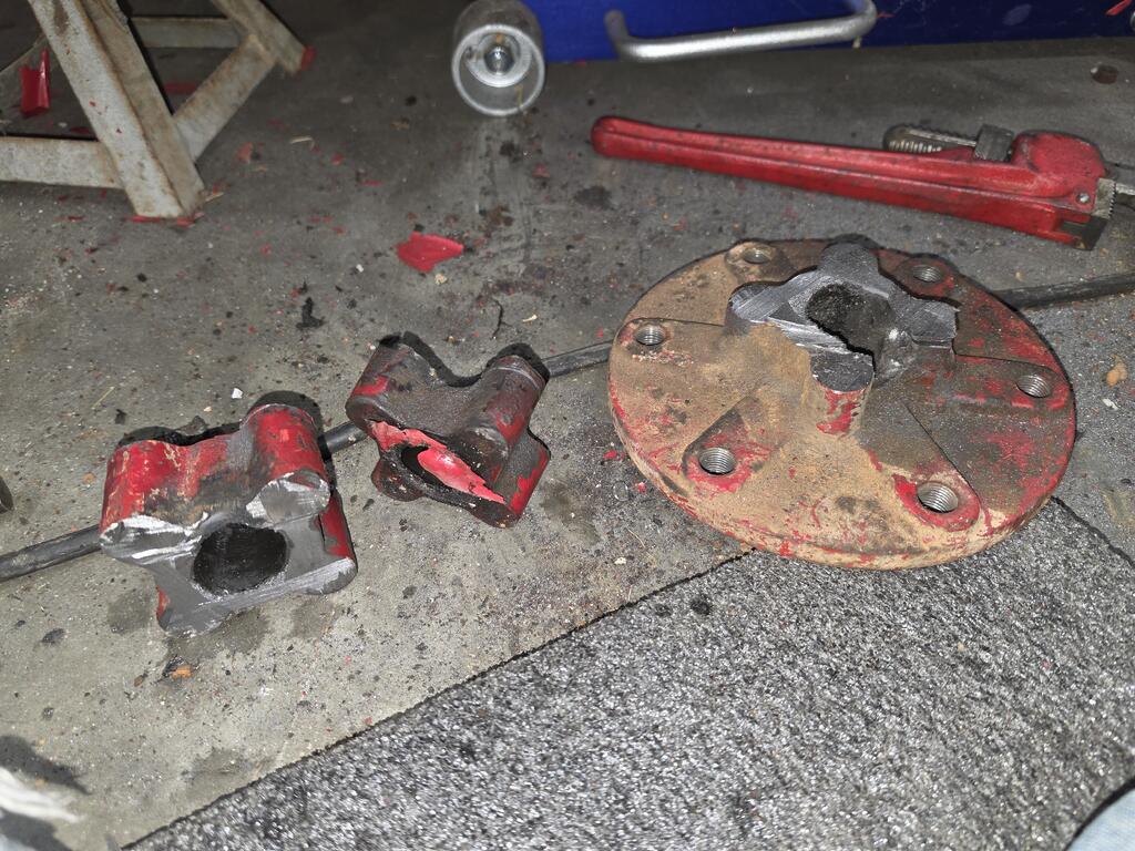

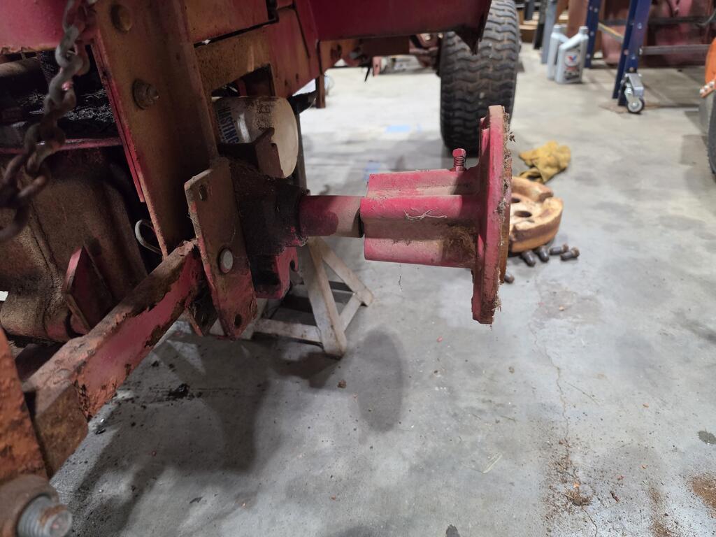

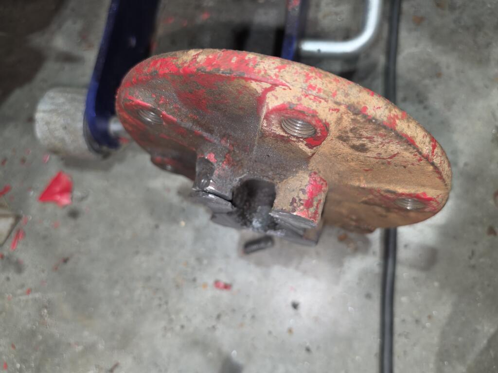

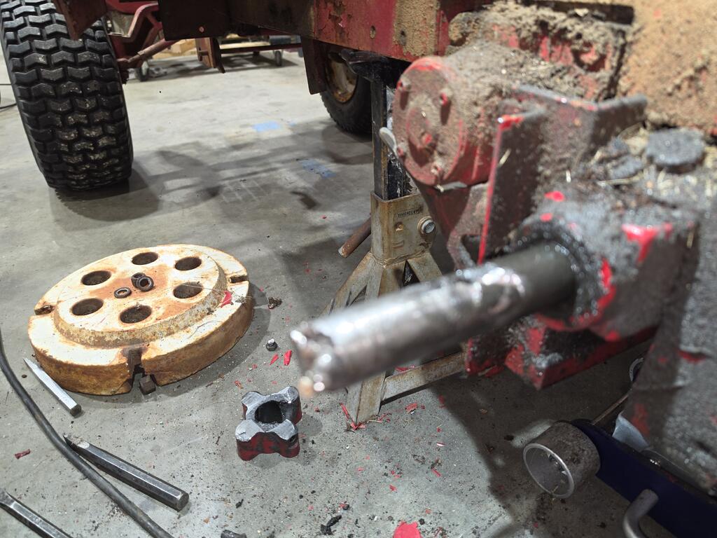

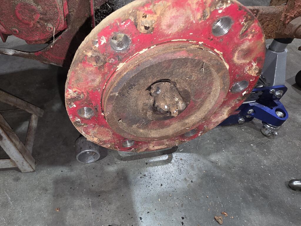

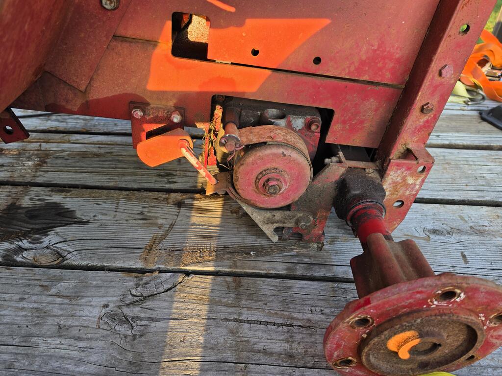

BradKahler 416 #7 Posted August 14 This welded hub problem because real expensive really quick Now that I've had time to look at things I've discovered just how messed up the left axle is. The first thing that clued me in was the parts manual listed both axles as the same part number and there is supposed to be a spacer between the axle and the housing on both sides. Only my passenger side has the spacer. What I couldn't figure out at first, was if both axles are supposed to be the same length, then why where my wheels centered properly. It turns out the wheel on the right side was installed correctly, i.e. the valve stem was towards the inside. On the drivers side, the valve stem was pointed to the outside. With the shortened left axle minus the spacer and the wheel mounted backwards provided the same wheel spacing on each side. There must have been some catastrophic accident on the left side to require that much modification to the axle. The outer axle bearing seems nice and tight, the only issue is the seal is leaking and of course a bad axle. Bottom line is it looks like I'm going to have to pull the gearbox out and do some repairs. Not what I was expecting, but oh well.... So I now need to source an axle, hub and spacer. 1 Share this post Link to post Share on other sites
c-series don 12,751 #8 Posted August 14 Wow! I’m not well versed in D-series tractors at all, but might it be easier to find and swap out the entire transmission/transaxle? 1 Share this post Link to post Share on other sites
BradKahler 416 #9 Posted August 14 37 minutes ago, c-series don said: Wow! I’m not well versed in D-series tractors at all, but might it be easier to find and swap out the entire transmission/transaxle? I'm definitely open to that option. I'm still researching to find out what if any differences there might between years. There are axles and hubs available but they are pricey, a complete swap would definitely be easier, now if I can find one and afford it. 1 Share this post Link to post Share on other sites

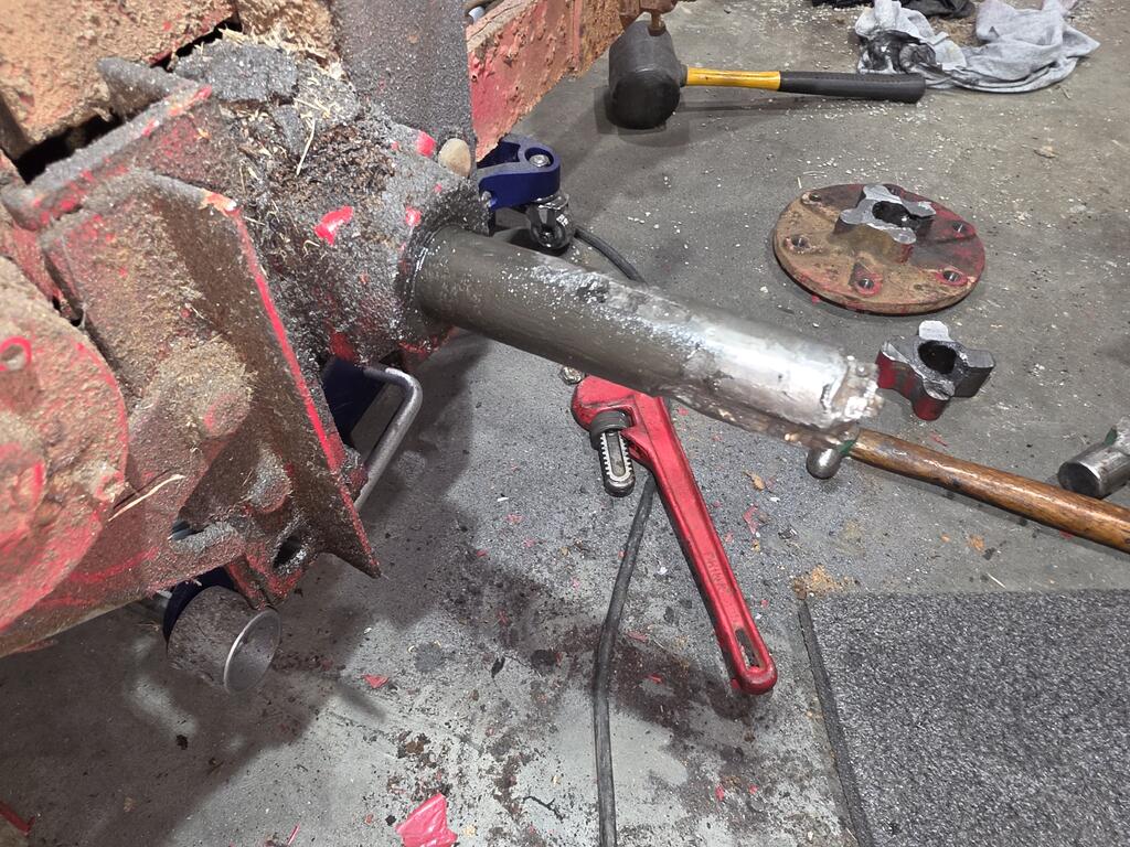

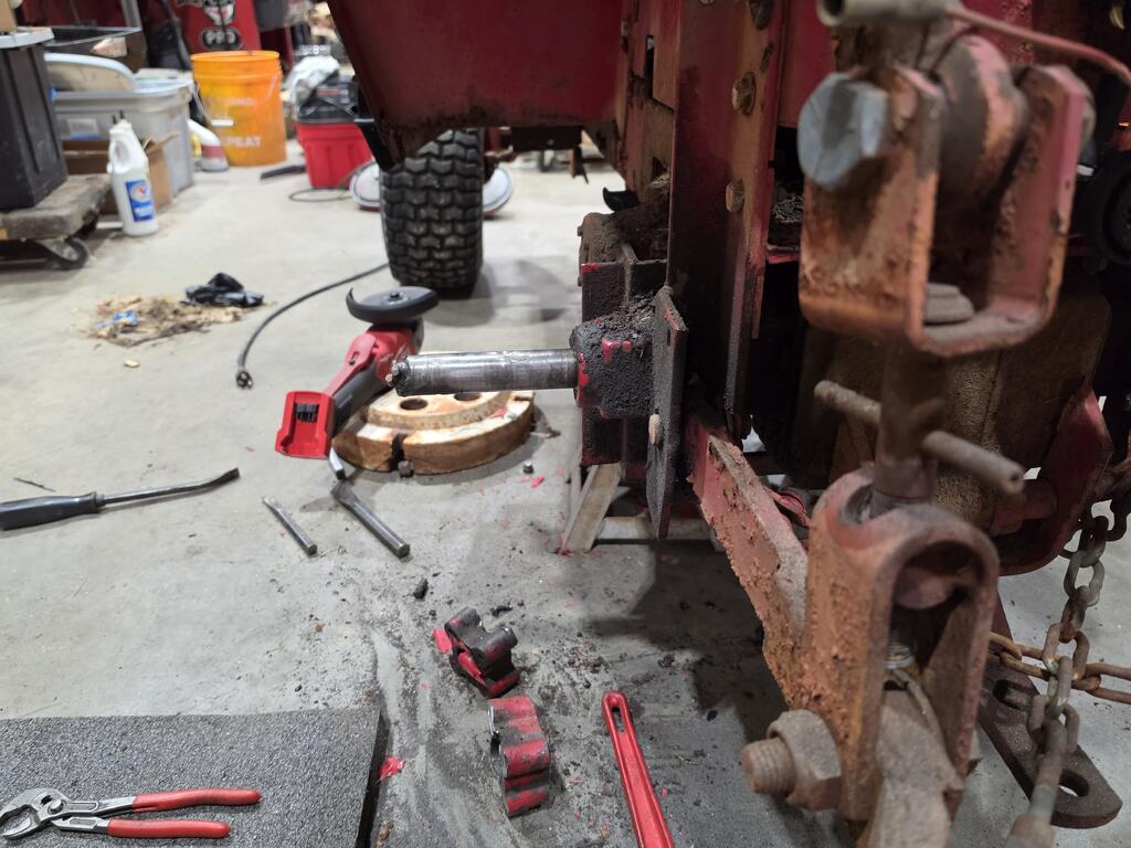

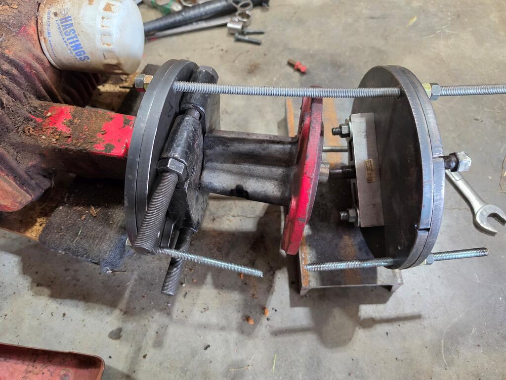

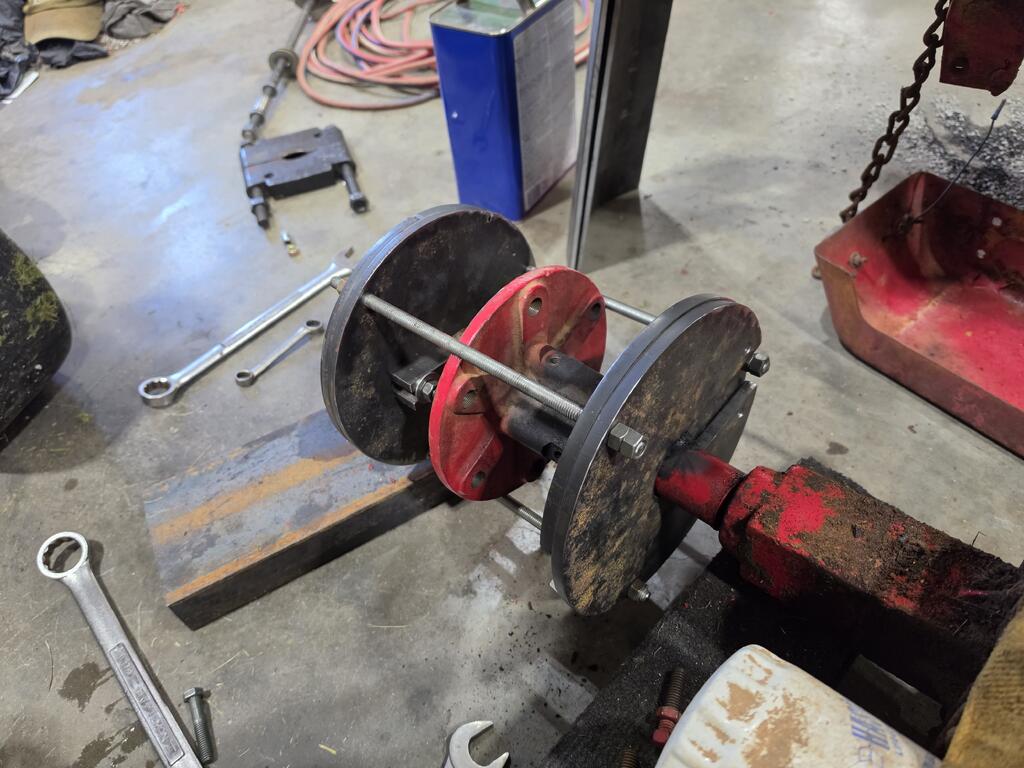

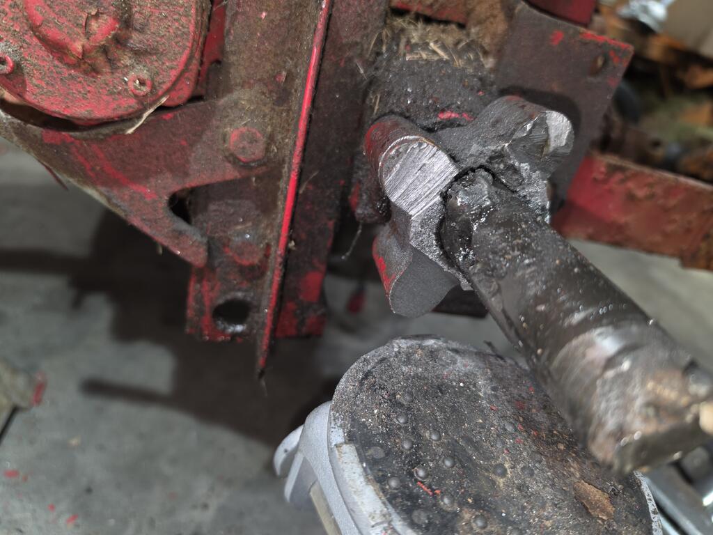

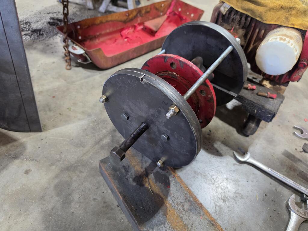

BradKahler 416 #10 Posted August 25 While waiting on a rear axle and rear hub I've bend spending time trying to remove the hub on the other axle. So far the hub is winning the battle I started out with 3/8" plate and found the rear plate bent way to easy. I then switched to double 3/8" plates and still got flex in the rear plates. It wasn't until I looked at the pictures that I realized that I have the two rear plates swapped. The front plate needs to be behind the back plate. I'll switch them tomorrow and give it another try. I'm also considering adding tubes or three equal length pipes over each of the 3/8" all-thread rods. My thought is with the pipes, the back plates can't flex unless the front plates flex. I don't know if they will make any difference but it's a cheap test. On the front end I found that the right hand spindle was a homemade spindle and it wasn't made long enough and is also worn pretty badly. The left hand spindle is original but it also is showing a great deal of wear. It looks like I will be able to source a pair of either new reproduction spindles or they may be NOS, not sure which. I also found that the pivot pin for the axle is worn .005" on each end so I'm making a new pin. I checked the three axle bores (spindle and pivot) with new shafts and found that the axle has very little wear. Assuming the spindles show up, the front end should be in pretty good shape. Along with the replacement RH spindle I found that the center portion of the RH wheel has been repaired, unfortunately the repair did not leave the bearing tube straight or perpendicular to the rim. It makes me wonder what kind of accent occurred to destroy the left rear axle and hub and the right front spindle and wheel. 1 Share this post Link to post Share on other sites

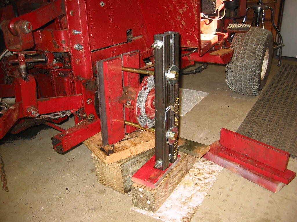

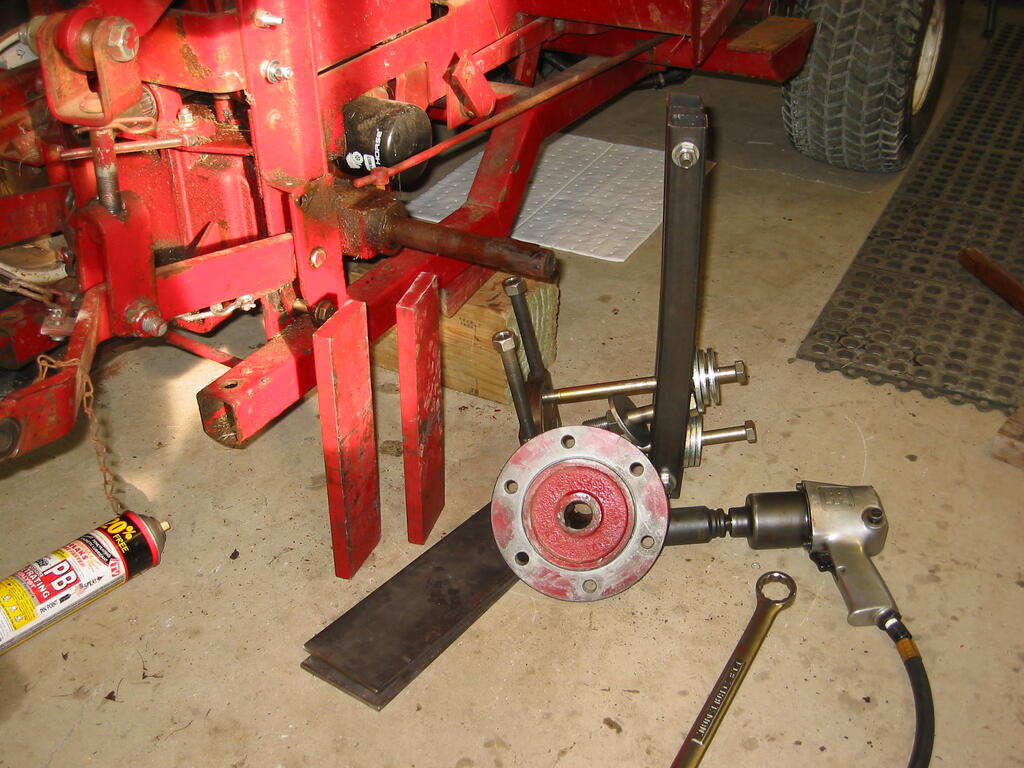

pfrederi 21,342 #11 Posted August 26 My sympathies on your hub issue I bent the thick wall tubing getting mine off 2 Share this post Link to post Share on other sites
BradKahler 416 #12 Posted August 27 19 hours ago, pfrederi said: My sympathies on your hub issue I bent the thick wall tubing getting mine off Thanks for the pictures. I actually found your post last week when I was searching for ideas on how to make a puller. I stopped at my local metal fab shop to see what kind of scraps they had available and found the 8-1/2" round 3/8" thick metal plates. My first attempt was with just one plate on each side and they started to flex right away. I then added the second pare and the front plates didn't really flex, but the back plates are flexing, mainly I think due to the smaller contact area on the back of the hub. Today my next try is going to be putting some tubing over the all-thread which should keep all four plates pretty much tied together. They will all have to flex the same amount. My other concern is the threaded stud I'm using to apply pressure with. I think it's to long. When I smack it with a hammer it doesn't seem like it's applying a solid impact to the shaft. Looking at your pictures, you used a short bolt which I believe guarantees more of the force is going straight into the shaft inside of the bolt flexing like I think mine is. So today I will be adding the tubing and finding a shorter bolt. Thanks! Share this post Link to post Share on other sites
pfrederi 21,342 #13 Posted August 27 Behind the hub I had 4 steel plates 2 red 3/4" 2 plain 1/4" and the flange puller 1 Share this post Link to post Share on other sites

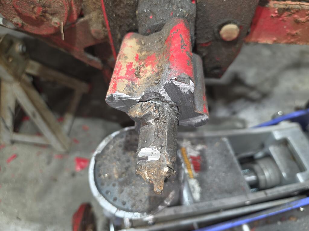

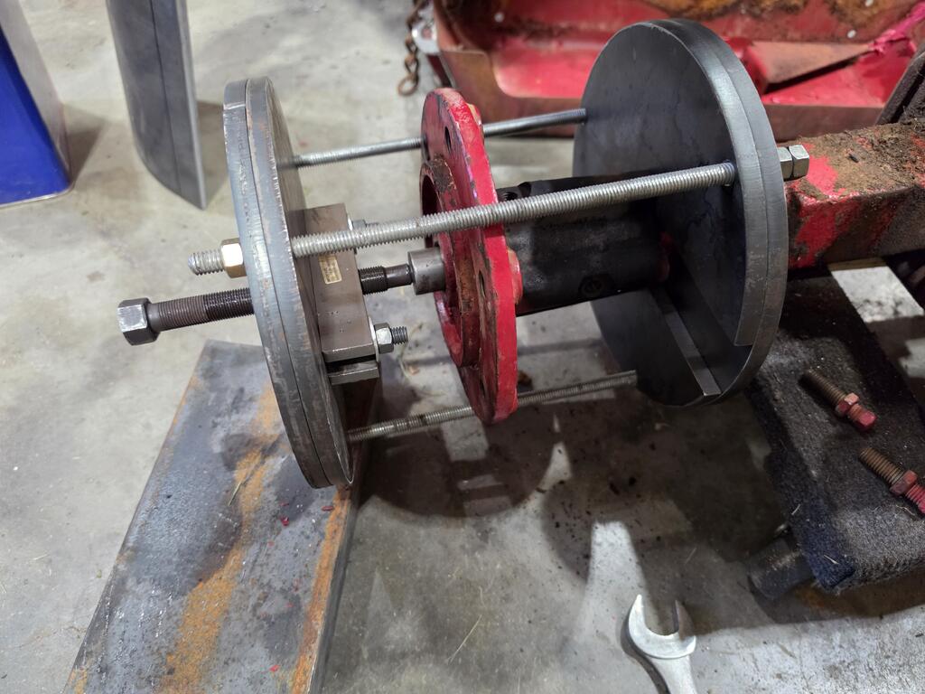

BradKahler 416 #14 Posted August 27 Well, I think I'm going to have to go to Plan B (or is it Plan C?!) I added a 1" thick bearing splitter directly against the back of the hub and tried again. This time I also used my high torque Milwaukee impact and you can see the results in the picture below. Needless to say it startled me a little when the rod let go I suppose I could upgrade from 3/8" to 1/2" all thread but I don't think I'd see much difference in the outcome. The hub hasn't budged. I see two options left, one would be to split the cases and try and find a hydraulic press wide enough to fit the hub through the support beams. The other is to cut the axle off and press the shaft out after words. The latter option will cost me around $100 for a replacement axle and hopefully the existing hub is salvageable. My local one-man machine shop has a large press and I'm going to check to see if the hub will fit up through the cross members. On a slightly different topic, I received the new replacement front spindles today. A huge shoutout to A-Z Tractor for having them in stock. The rusty one is definitely NOS and I'm almost certain the other one is as well. Also, I picked up the newly fabricated front axle pivot shaft which means I'm fairly close to being ready to put the front axle and spindles back on the tractor. To bad I can't say the same for the transaxle... 1 Share this post Link to post Share on other sites
sqrlgtr 4,224 #15 Posted August 28 9 hours ago, BradKahler said: I suppose I could upgrade from 3/8" to 1/2" all thread but I don't think I'd see much difference in the outcome. The all thread will probably never get the job done any way you could get some grade 8 bolts to replace it with? 1 Share this post Link to post Share on other sites
pfrederi 21,342 #16 Posted August 28 The bolts in my set up pictured above were GR8 5/8" Most all thread is Gr 2 2 Share this post Link to post Share on other sites
BradKahler 416 #17 Posted August 28 (edited) 7 hours ago, sqrlgtr said: The all thread will probably never get the job done any way you could get some grade 8 bolts to replace it with? 2 hours ago, pfrederi said: The bolts in my set up pictured above were GR8 5/8" Most all thread is Gr 2 Agreed, all thread is probably grade 2 and is not a suitable choice, unfortunately it's what I had on hand that was long enough. Due to the hubs being about 7-3/8" in diameter and my steel disks being 8-1/2', about the largest diameter bolt that I can use is 1/2". Also, due to the thickness of the metal plates and bearing separator I would need 1/2" bolts that are 10" long or longer. I just checked McMaster Carr and they carry grade 8 1/2-13 x 10" bolts but they are $10 each, add in shipping and I'm looking at $40 just for the bolts with no guarantee they would work. I don't think I can find any 10" bolts locally but I'll check just to be sure. I recently bought a 3/4-10 x 5" grade 8 bolt with two nuts from Tractor Supply and the total was $10 Since one front wheel was toast and the other one not far behind I decided to go in a slightly different route for putting wheels on the front. I purchased a pair of Club Car front wheel hub kits and will be using 8" x 7" wheels with a 4 on 4 bolt pattern. Below is a picture where I used a section of pipe to mock up the spacers I think I'll need to position the hubs properly. Until I get the wheels delivered the size of the spacer is still in question. My initial plan is to position the outer wheel bearing just slightly short of the end of the spindle and use thin shims between the washer and the bearing to create the required preload. Needless to say, this is a work in progress. The goal is to have the wheels positioned on the spindle in the same relative location as original. The original wheels have a neutral or zero offset so the hubs just have to be placed in the same location as the originals using spacers and shim. Edited August 28 by BradKahler 2 Share this post Link to post Share on other sites

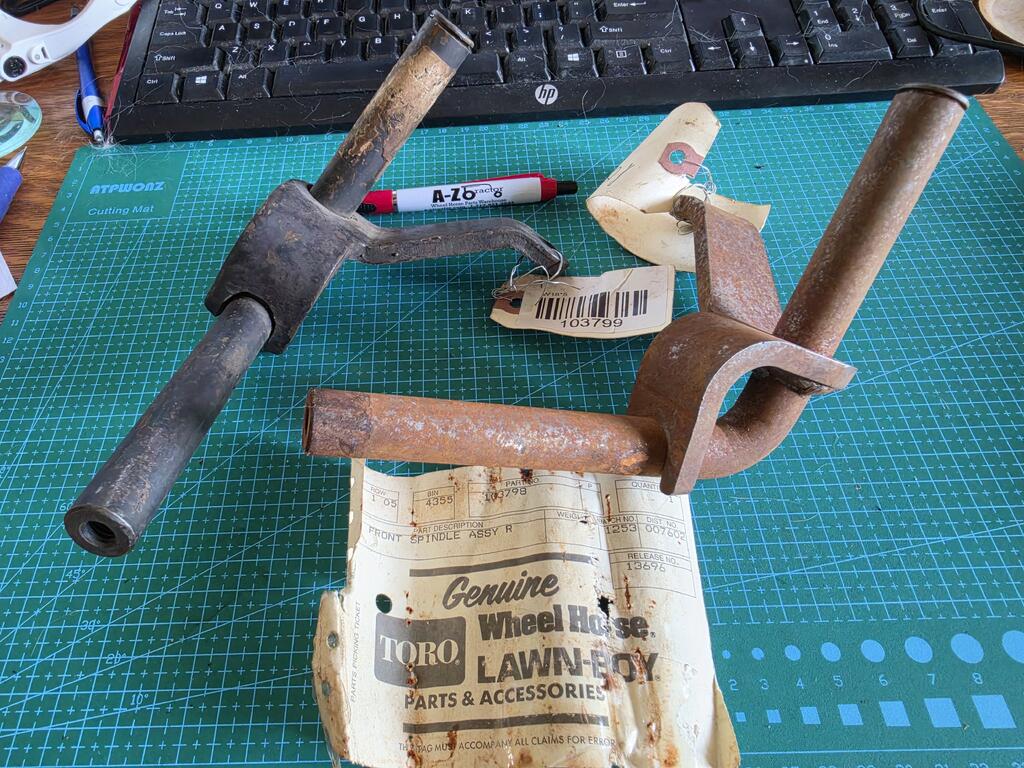

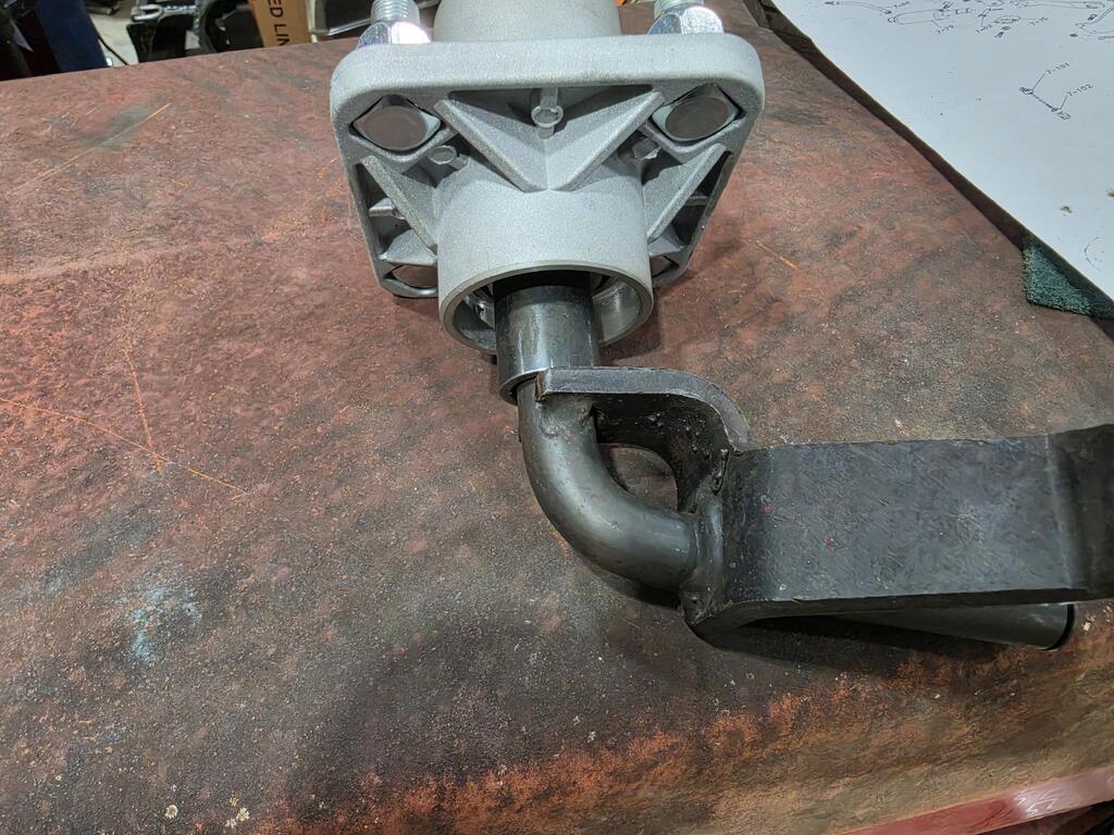

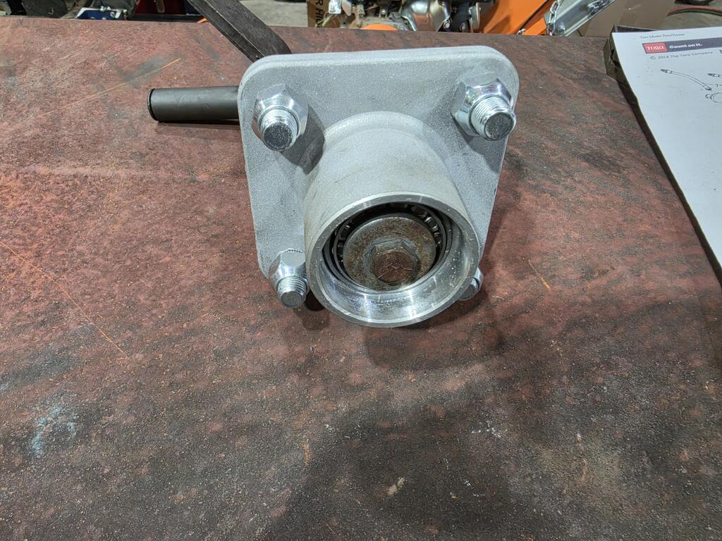

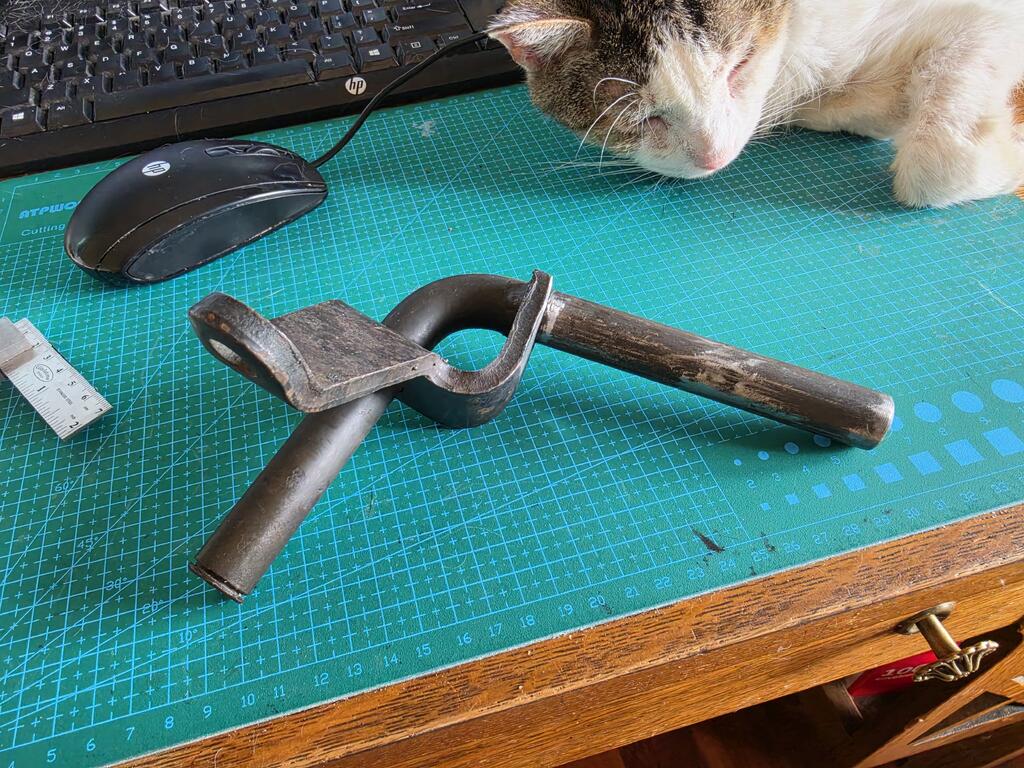

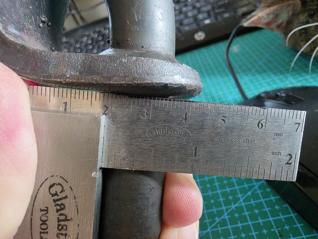

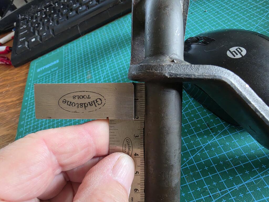

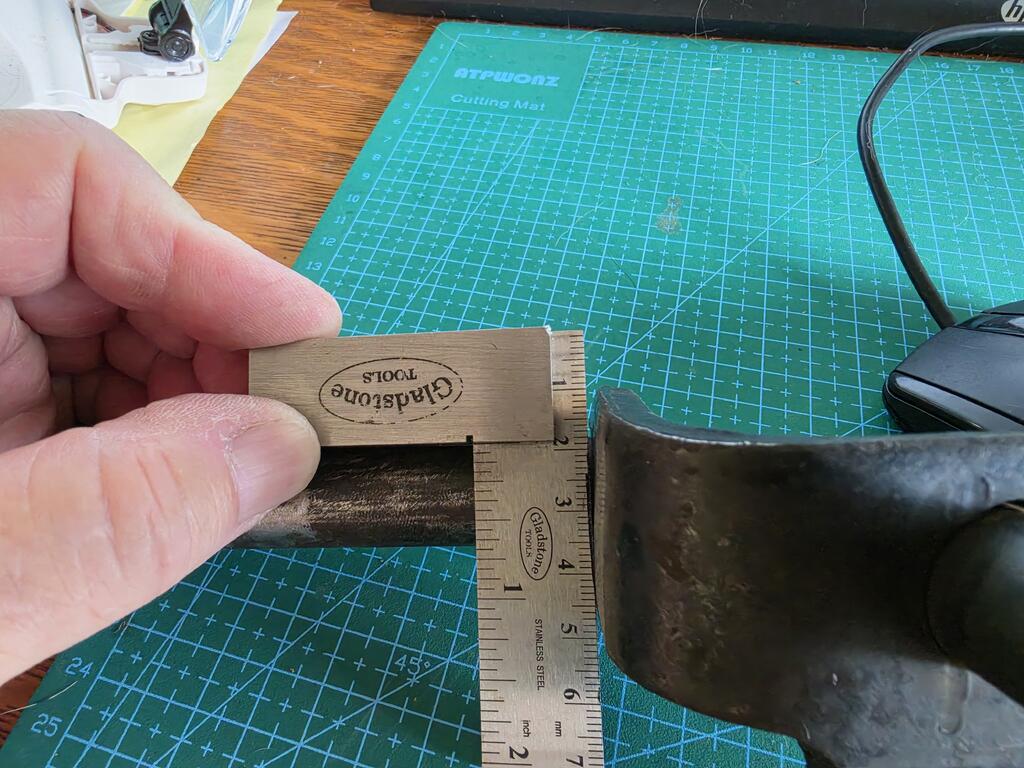

BradKahler 416 #18 Posted September 8 I managed to source two NOS front spindles from A-Z Tractors. An issue I've found with one of the spindles is how the drag link arm has been welded in place. The faces of the drag link arm where it contacts the shaft are not perpendicular to the shaft. The best way to explain it is to look at the pictures. My concern is with them not being perpendicular it will put an incorrect load on the thrust bearing and washers that are installed. The bearings will only be contacted on a small surface area. Currently the only way I can think of squaring up the faces on the drag link arm is to use some kind of cutter that slips over the shaft where the cutting face would cut into the drag link arm. I've been looking at annular cutters but can't find any that have a 3/4" bore that would slip over the shaft. I'm beginning to think I might have to find a pipe or tubing that is a slip fit over the shaft and then braze a high speed steel lathe tool bit to the end of the tube. Then rotate the tube slowly cutting away the shoulder. My description sucks but I can't think of any other way to describe it Any suggestions would be greatly appreciated. Share this post Link to post Share on other sites
sqrlgtr 4,224 #19 Posted September 9 16 hours ago, BradKahler said: Any suggestions would be greatly appreciated. Is it just the one spindle or both? Only thing I could think of would be chuck it up in a lathe, would probably have to use a longer boring bore to reach the spindle face. Might be able to use a face plate to clamp spindle to then cut it? Just thinking aloud here. I would be tempted to use as is just to see how bad it is before I spent too much time on it or try to source another one. . 1 Share this post Link to post Share on other sites
BradKahler 416 #20 Posted September 15 On 9/9/2026 at 9:57 AM, sqrlgtr said: Is it just the one spindle or both? Only thing I could think of would be chuck it up in a lathe, would probably have to use a longer boring bore to reach the spindle face. Might be able to use a face plate to clamp spindle to then cut it? Just thinking aloud here. I would be tempted to use as is just to see how bad it is before I spent too much time on it or try to source another one. . Well, the 3/4" spindle replacement project is on hold. A couple of days ago I picked up a 75 or later D160 parts tractor and it just happens to have 1" front spindles The play in the 1" spindles inside the spindle bearings in the axle casting is no worse than what I have with the 3/4" axle so I see no reason I shouldn't use the 1" axle. Also the D160 transaxle has the external parking brake drum and pedal assembly so I will be using the D160 transaxle and parking brake assembly along with the D160 transaxle. The motor is definitely not original, anyone recognize it? 1 Share this post Link to post Share on other sites

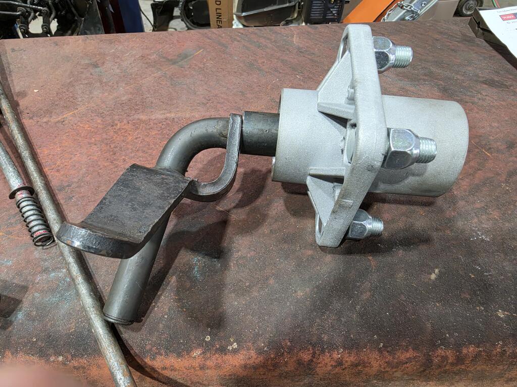

BradKahler 416 #21 Posted November 9 (edited) I've been making slow but steady progress on the tractor. The front axle from the D160 with 1" spindles has been installed. The left side bushing in the axle has a little more wear than I would like but it's still better than what the original axle had, which was extremely sloppy, so I'm calling that a win. One of the original front wheels was severely damaged so I made the decision to just convert to hubs with tapered roller bearings from a trailer and buy new wheels with tires mounted. The only touchy part was making spacers to position the hubs so they had the correct amount of bearing preload. I left them a little tight on clearance, I want to see if they loosen up any after I can finally drive the tractor. It's easier to shorten a spacer than is to lengthen it I also got the D160 transaxle cleaned up, painted and installed. I'm a little nervous in that I don't know if the axle is any good but I do know the oil was clean with no debris and the axles rotate smoothly with little to no slop. I have made the decision that no matter what, if this transaxle is bad and/or needs rebuilding then I'm going to rebuild it. In order to sort out the parking brake situation I've been doing a ton of research, going over parts lists and diagrams. What I'm attempting to do is incorporate the drum brake with my 18 Auto motion controls on the Sundstrand pump. I've compared the original parking brake linkage with the early and later D series parking brake linkage arrangements and I think I can marry the two systems together. At least that's what I'm going to attempt to do. The D160 came with all of the brake and parking brake system intact so I have all of those components that I am moving over to my 18 Auto. The only area of difference is the motion control apparatus on the side of the pump. However, it seems that the linkage arms that go into and come out of the motion control do the same basic locations. I've got it all installed except the brake band that I have to put new lining on. The one thing missing from the parking brake setup was the knob but I found one on ebay and it will be here this week. The last thing I want to mention is I downloaded the 3D files for the plastic instrument overlay from the site and after some discussion with Greg Wilfong I was able to get them printed. I think they came out pretty good. I would like the top surface to be a little smoother so I'm going to check the 3D printer slicer software to see if there is something I can do to smooth it out. Thanks Greg! Edited November 9 by BradKahler 1 Share this post Link to post Share on other sites
