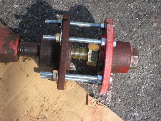

rmaynard 17,642 #11 Posted July 25 (edited) This is my hub puller. Works well. Cheep to make. Plenty of variations have been made. Edited October 6 by rmaynard 5 1 1 Share this post Link to post Share on other sites

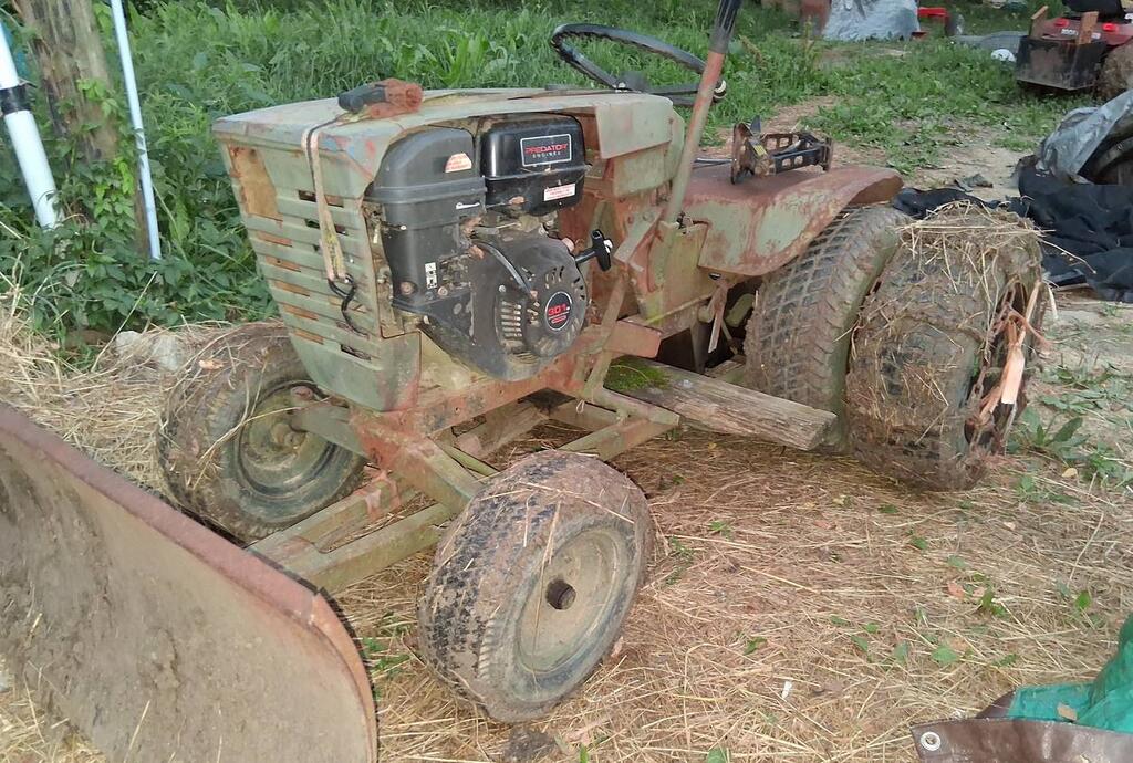

nyquil junkie 333 #14 Posted July 27 (edited) I found a couple hubs in my junk boxes... didn't know I had them. I put in new keys, and the hubs are now pretty snug. Good enough. I removed the outer tires on the back, and put some oil in the case.... it'll leak out eventually but, who cares. I'll add some now and then. Its good enough to tote the little wagon around, take feed to the cows or go inspect/fix the fences. When I i get some time I'll find the seals and put a set in. Its better than getting set under a tree to rot. I need a bigger machine w duals to crawl up into the high rough fence lines, which is what I'm going to slap together from this 520H roller I drug home the other day. Edited July 27 by nyquil junkie 1 Share this post Link to post Share on other sites

ebinmaine 81,116 #17 Posted October 4 On 7/25/2026 at 12:04 PM, rmaynard said: This is my hub puller. Works well. Cheep to make. Plenty of variations have been nade. Hey Bob. What's the specific size of the main bolt there? Share this post Link to post Share on other sites
rmaynard 17,642 #18 Posted October 4 8 minutes ago, ebinmaine said: Hey Bob. What's the specific size of the main bolt there? The main (big) bolt is 7/8" x 5". It is stationary. Does nothing other than push on the axle as the other 3/8" bolts and nuts do all the work. 1 1 Share this post Link to post Share on other sites
ebinmaine 81,116 #19 Posted October 4 12 minutes ago, rmaynard said: The main (big) bolt is 7/8" x 5". It is stationary. Does nothing other than push on the axle as the other 3/8" bolts and nuts do all the work. Very good. Thank you sir. Share this post Link to post Share on other sites

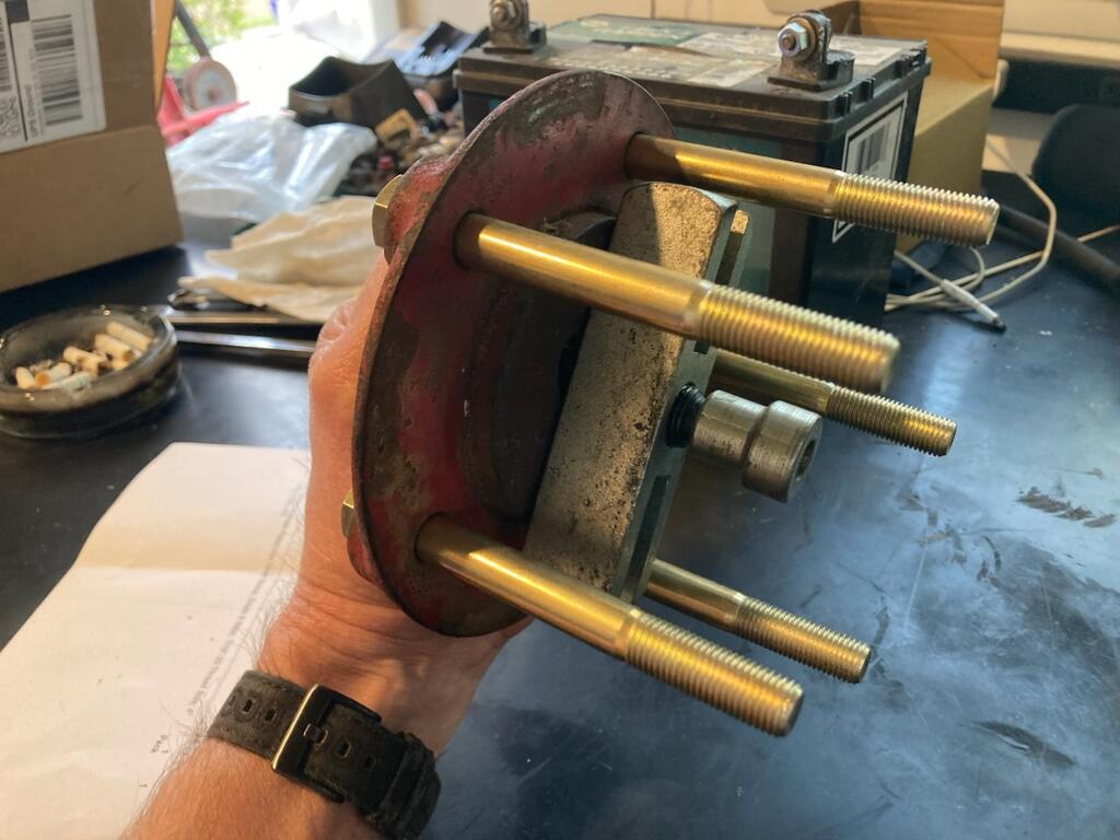

ineedanother 2,885 #20 Posted October 5 On 7/25/2026 at 12:04 PM, rmaynard said: This is my hub puller. Works well. Cheep to make. Plenty of variations have been nade. Mine is similar and quick. Not as good looking but it was cheap and I used it twice this weekend. Sacrificed a bad hub and the bolts thread directly into the hub being pulled. Share this post Link to post Share on other sites
