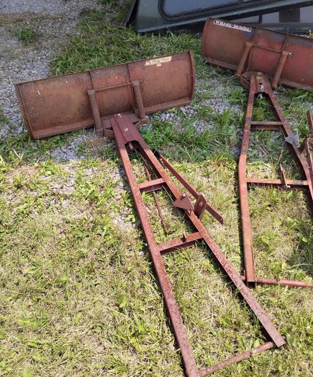

SamHit 15 #1 Posted July 23 I have a 312-8 and a C-175. I have the option to purchase a plow from someone who has two similar but slightly different plows. Do I need one of them in particular? And do the two machines use the same plow? I’ll attach a photo of the plows Share this post Link to post Share on other sites
gwest_ca-(File Mod) 12,508 #2 Posted July 23 You need the one on the right. Here is a list of them. You also need the correct rear axle brackets. Dozer DNA of long tractor frame dozer blades 1966-1967 model BD-426 - Fits LONG frame tractors - Mounts ahead of the rear axle - replaced by 1968 model 6-1111 - Fits LONG frame tractors - Mounts ahead of the rear axle ---------------------------------------------------------------------------------------------------------------------- 1968 model 6-4111 - First to fit LONG & SHORT frame tractors and first to mount under the rear axle with a loose A-frame crossbar - Lift bracket behind crossmember - replaced by 1969 model [6-4112 + 6-9621] - First to have lift bracket ahead of crossmember 1970-73 model [6-4113 + 6-9622] 1973-74 model [6-4113 + 6-9623] 1974 model [6-4114 + 6-9624] 1974 model 6-2131 1975 model 6-2132 1976 model 6-2133 1976 model 66-42BC01 1977 model 76-42BC01 1978 model 86-42BC01 1979 model 96-42BC01 1980 model 06-42BC01 - (Last blade to have a loose A-frame crossbar #7701) 1981-1984 model 06-42BC02 (Up to here including this one they are 42" wide) and (First blade to have a welded-in rear A-frame crossbar) 1984-1989 model 06-48BC01 (They are now 48" wide) - replaced by the following 1990 model 06-48BC02 (Last blade to have 3 angle positions) 1991-1993 model 06-48BC03 (First blade to have 5 angle positions) 1993-2000 model 79350 - Up until now uses a wire to index pin (105-1502 cable kit adapts 2000 and older GT Classic-Series blades to fit 2002 and later tractors) 2001 model 79350 - Has cable to index pin (105-1502 cable kit adapts 2001 and older GT Classic-Series blades to fit 2002 and later tractors) 2002 2004-2009 2012 model 79364 - Has cable to index pin (105-1501 kit adapts 79364 blade to fit 2001 and older GT Classic-Series) 1 1 Share this post Link to post Share on other sites
Ed Kennell 47,585 #3 Posted July 23 Yes. the one on the right will work. You will also need the axle bracket to mount the plow. 1 1 Share this post Link to post Share on other sites
Brockport Bill 2,479 #4 Posted July 23 here is is some unsolicited advice from experience ----- after you get your plow ( which look rusty ) - you may want to consider some blade maintenance -- check the wear edge blade on bottom of blade to be sure it is in good condition other wise replace it - secondly, consider removing the rust from blade with grinder - wire wheel - sand paper etc --- and then paint it. The rust causes friction therefore the snow will not peel off and flow as well when on angle... the snow will also stick making it less efficient and heavier to lift - especially if you have manual lift - Also suggest to apply some type non stick product -- Non Stick spray -- or WD40 type product - Fluid Film etc -- or car wax etc -- Good luck ! Have fun - i have both the C175 and 312-8 you have - - either will plow great 2 Share this post Link to post Share on other sites

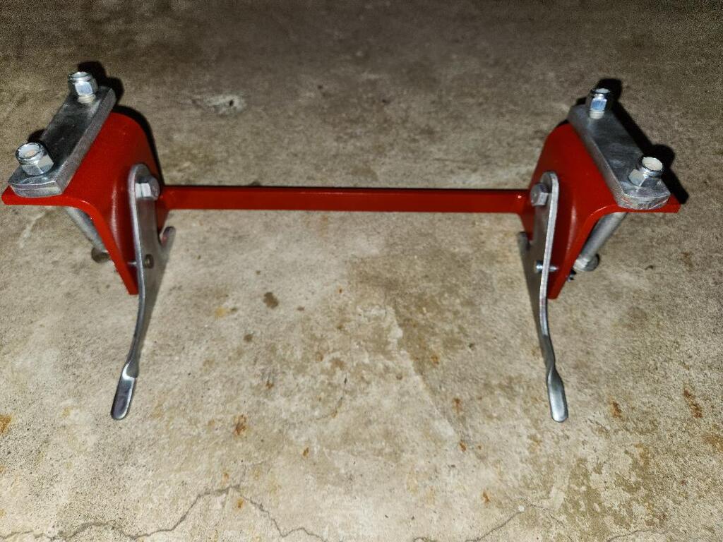

Brockport Bill 2,479 #5 Posted July 23 here is the axle bracket the above members mentioned that you need 1 Share this post Link to post Share on other sites
