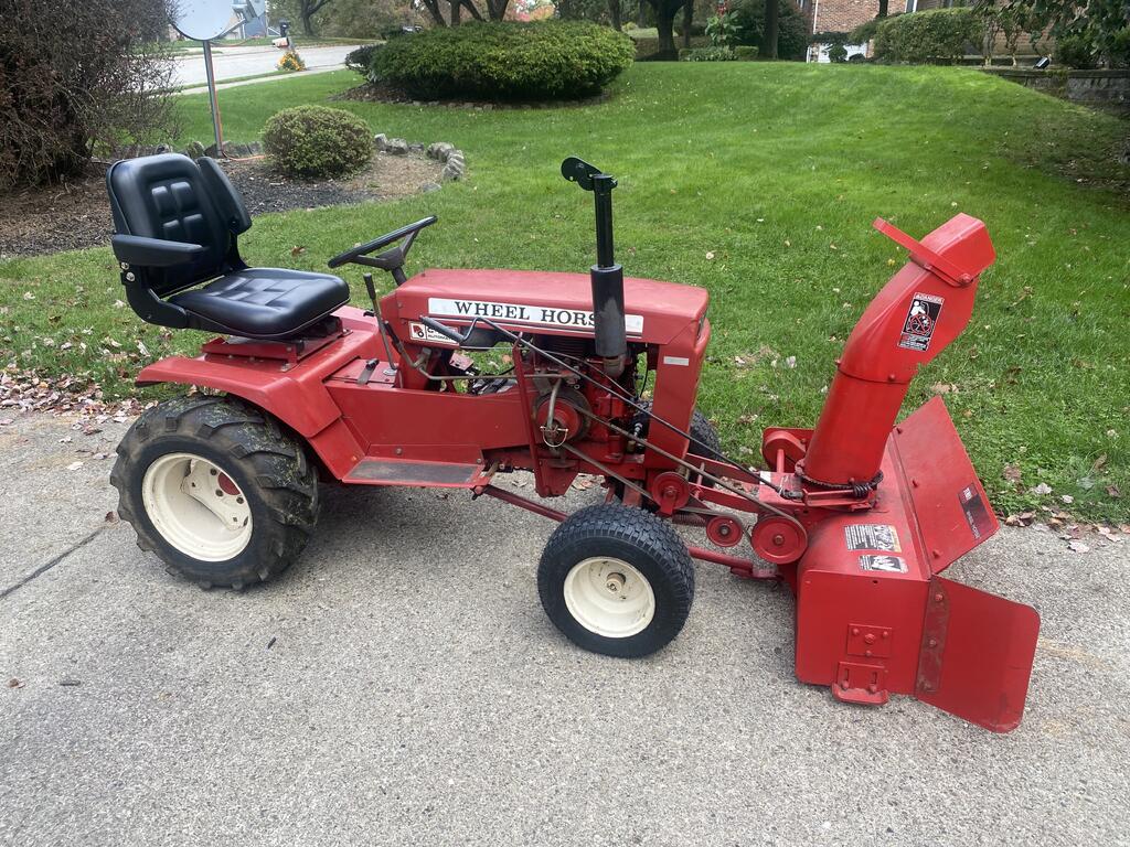

TonyBer 82 #1 Posted July 23 Help battery was weak / dead and used my truck battery to jump (vehicle NOT running). Now I get nothing...turning key does nothing...no sounds, noises, movement, etc. Is there an ignition fuse or something I may have sent to much power to and shorted? Could I have blown out the starter? There was no smoke, smell and no heat meaning no areas seemed to get hot. Starter is relatively new. Thoughts? Thanks in advance. 1 Share this post Link to post Share on other sites

squonk 48,119 #5 Posted July 23 That seat on the tractor is the best tractor seat you will ever come across! Share this post Link to post Share on other sites
