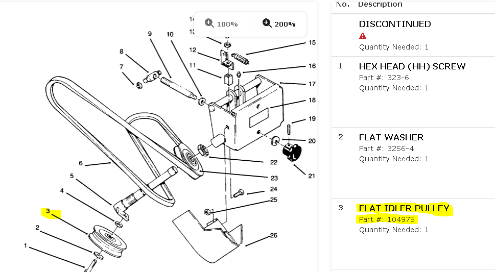

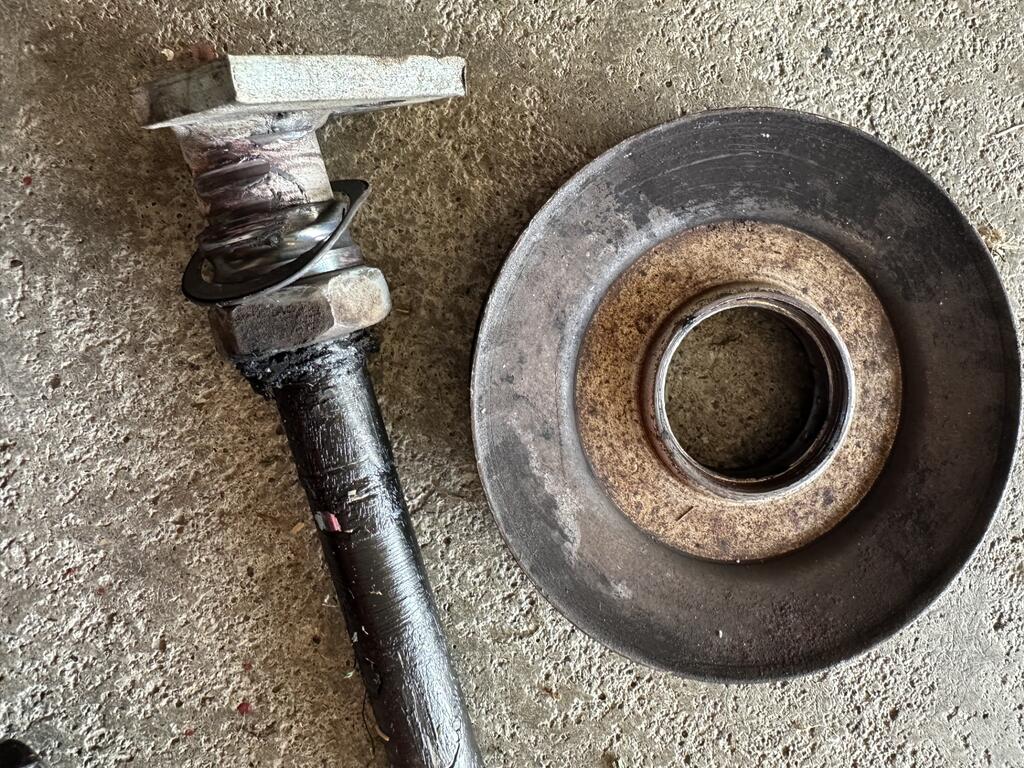

Hello,
Had a pulley in my Mule Drive self disassemble. I have a 520H and looked in the parts manual and the Mule Drive isn't in there, my mower deck PN is either "C560SC01" OR "10525" which I was also unable to find a parts manual for.
I would imagine I need to replace the shaft, as the race is pretty marred. The pulley itself doesn't seem to have damage but if I'm buying everything I might as well replace it.
A secondary question would be why it broke. I have noticed that my PTO will kick off while mowing a lot, especially when mowing in taller grass too fast. So I just turned in the PTO adjustment a turn (maybe every other week this year) until this broke this weak. What would be a good way to get the PTO adjustment and Mule adjustment where I'm aligned and tightened properly?
Thanks for the help.

One of the best features about Wheel Horse is interchangeability of implements and attachments. The manual below has the parts listed individually but yours appears to need a complete replacement. The mule drive on your 1990 60" mower is the same as other dives.
Place a Wanted ad in our classified section for a mule drive.
https://www.wheelhorseforum.com/classifieds/wanted/
Ed Kennell
The spring loaded mule drives used on the 520 are not as common as the regular mule drives.   You can place an ad in our classified wanted section or contact A to Z tractor parts
JoeM
Posted (edited)
I would venture to say you had a bearing going bad and dragging the belt.
The shaft should be okay as long as you can get the old race off. just clean up the burs so the new pulley slides on.

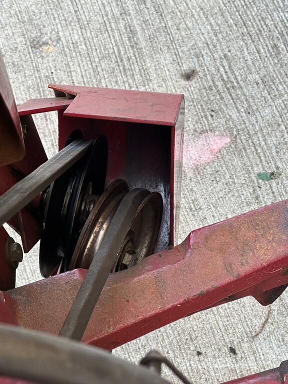

Got the new pulley in and installed and this just doesn't look right to me. Any ideas on what it could be? The belt is on the inner pto track.
8ntruck

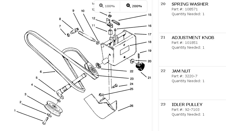

Looks like you have the bracket and shaft (#5 in the parts diagram) about 180 degrees out of position.  The way I read the parts diagram, the outer pulley should be ahead of the inner pulley when installed on the tractor.  Your picture shows that it is behind the inner pulley.
Disclaimer: I do not own a 520H nor have I worked on one.  I'm sure somebody with direct knowledge of a 520H will be along with comments.
  • Like 2

Hayden
That was exactly the problem.

Ed Kennell
1 hour ago, Ed Kennell said:
I
Yeah that, but what fixes the position of the shaft?   I am not seeing it on the schematic.
I think i see it now.   Looks like the guide block #11 and bracket #12 attach to a tapped hole in the shaft.   The hole is hidden by the belt on the schematic.

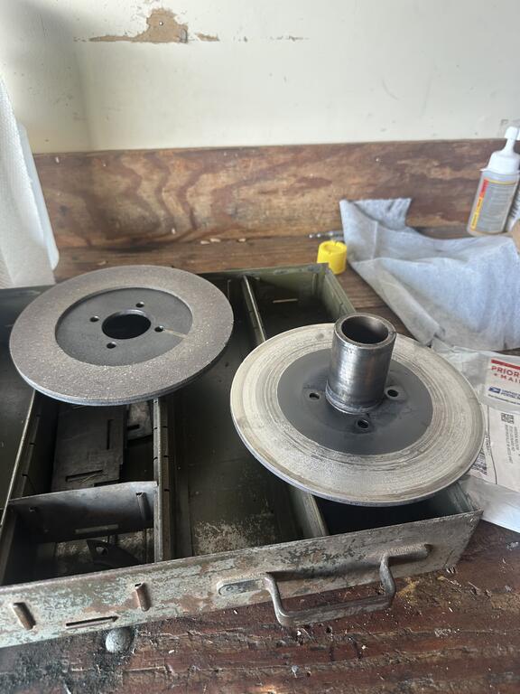

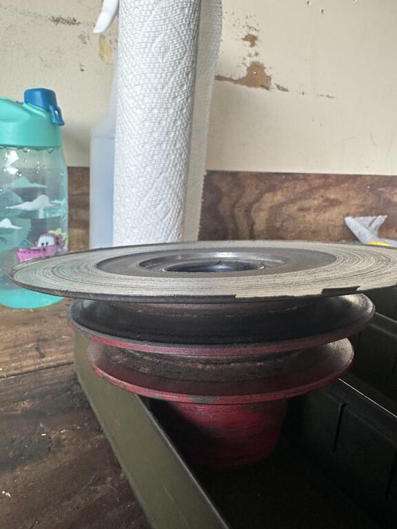

Well I found out a lot today. Ordered a new PTO clutch and went to go replace it. The Housing looks to be completely worn thin, almost all the way through and that it has been metal on metal for some time.
The plate on the right is the old one, so not a shred of clutch left. Makes me feel like an idiot.
Does anyone know where I can find one? The PN I found was Toro 103478-03, which is unavailable most places. A similar one on ebay is $300 :(
Any help would be appreciated!
That's about as wore as Ive ever seen one.
