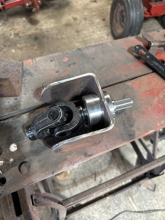

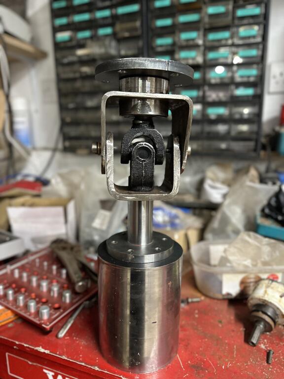

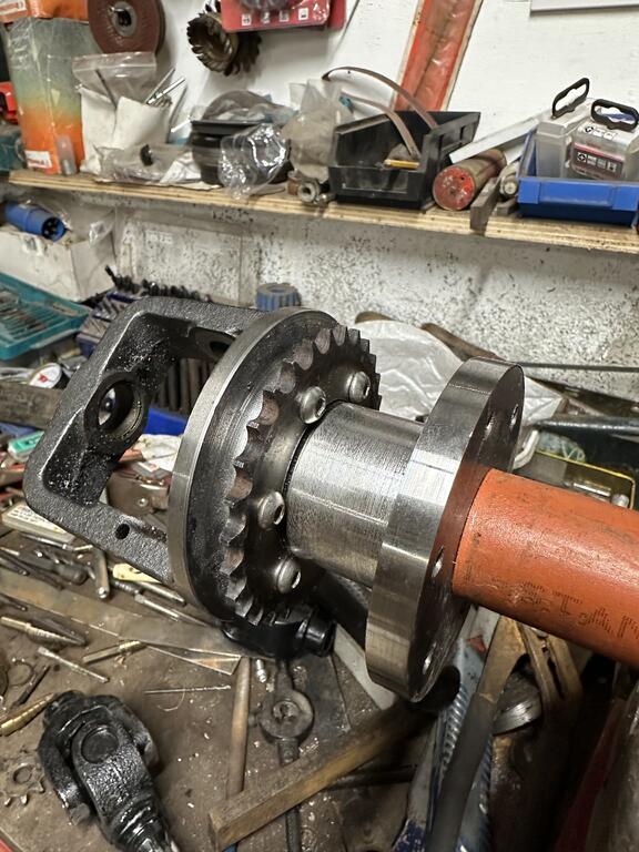

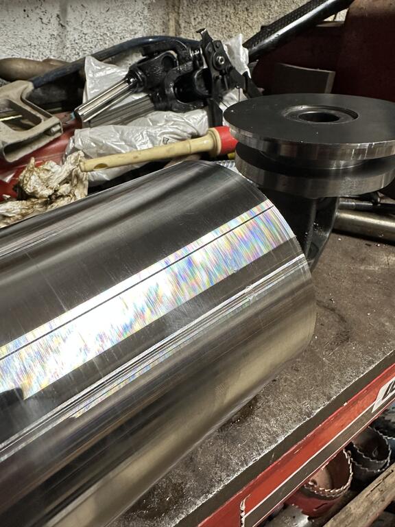

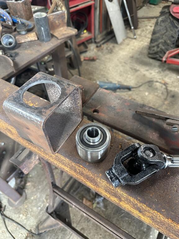

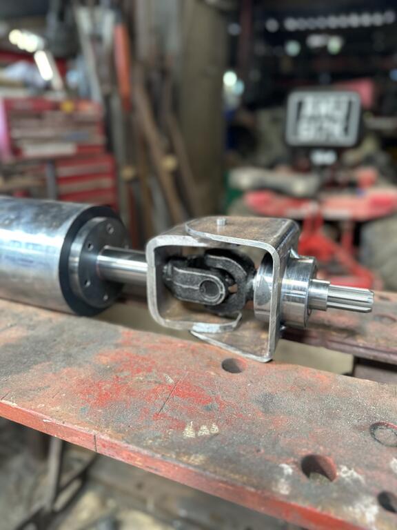

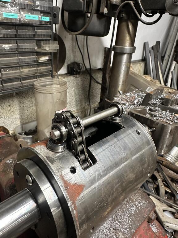

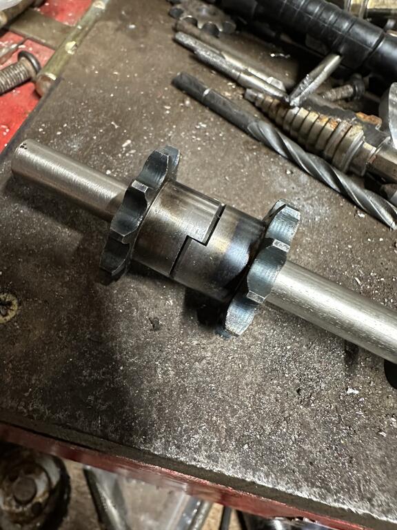

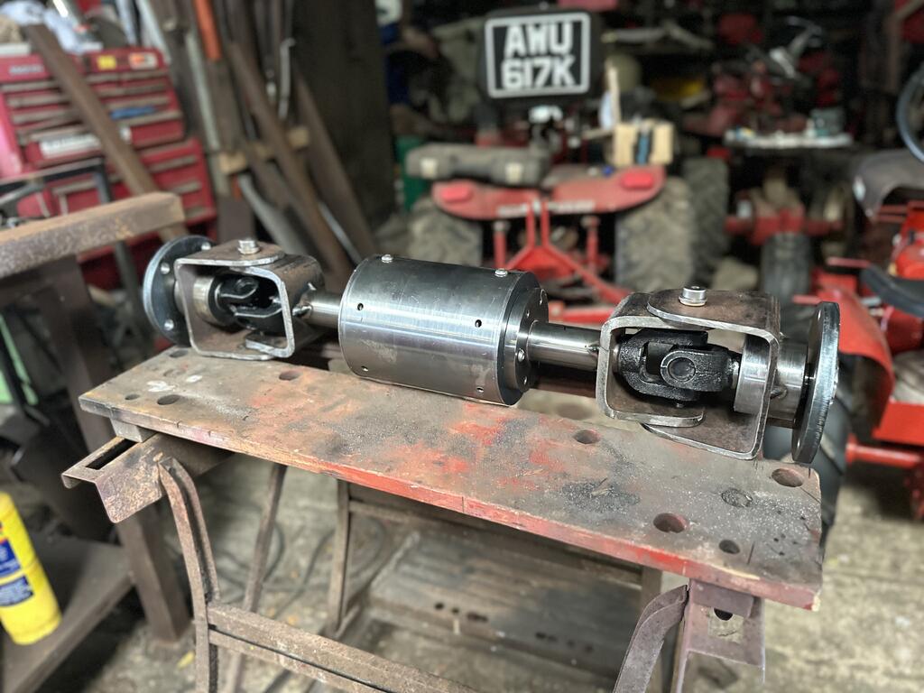

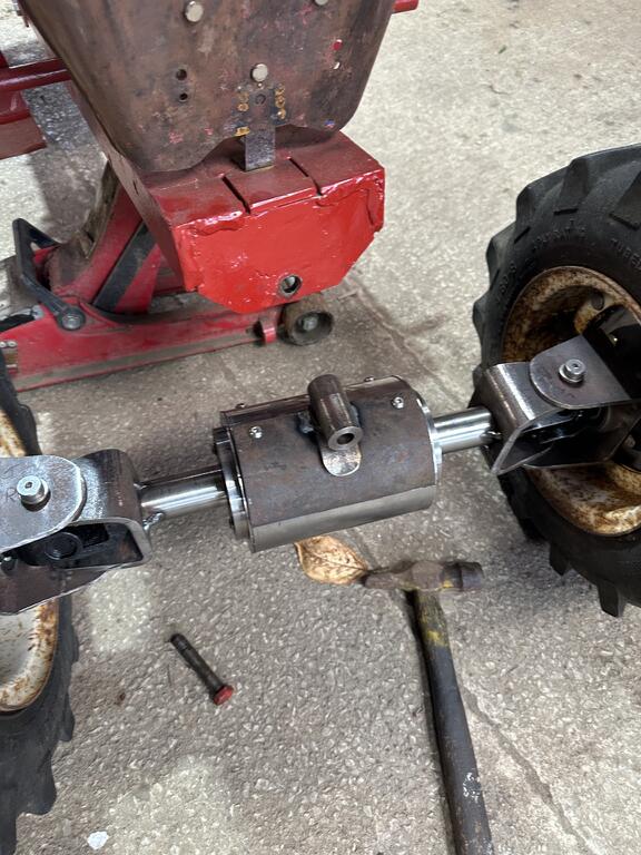

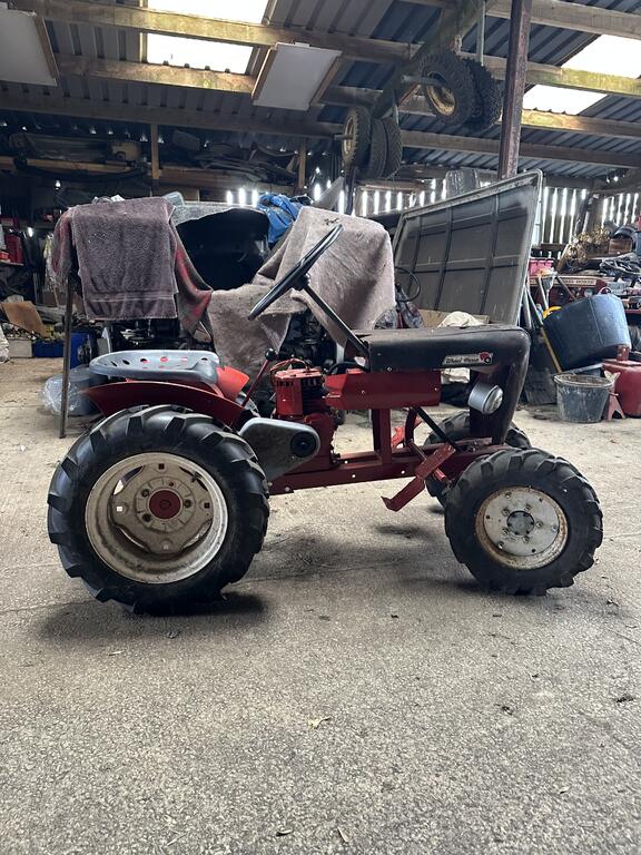

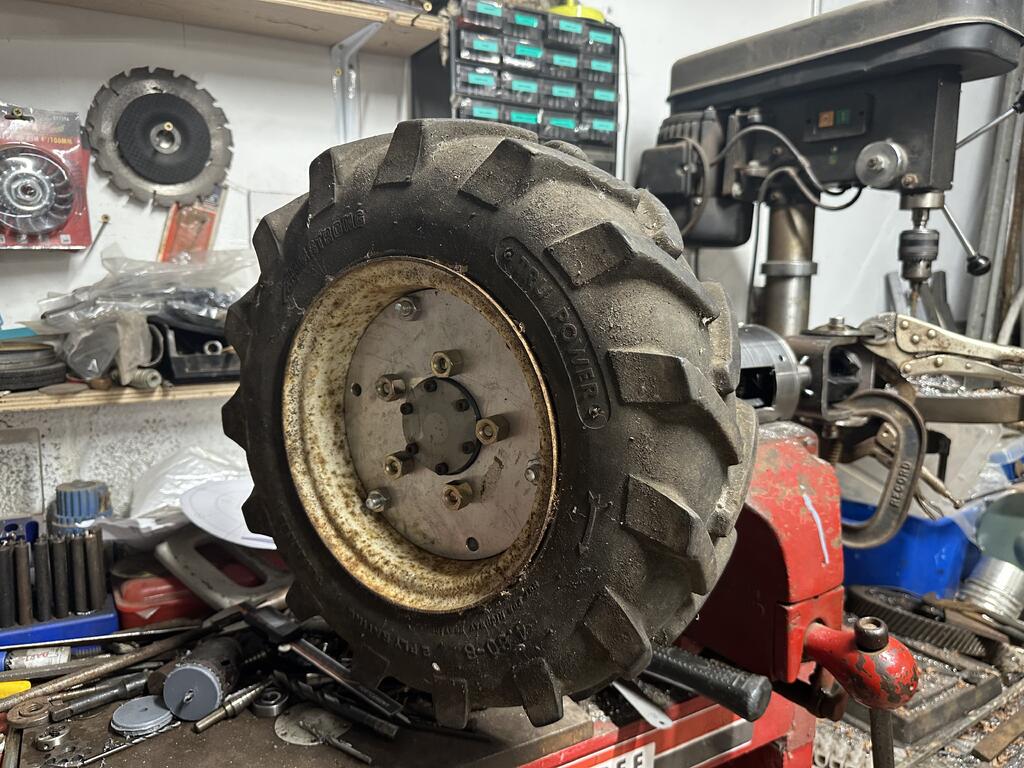

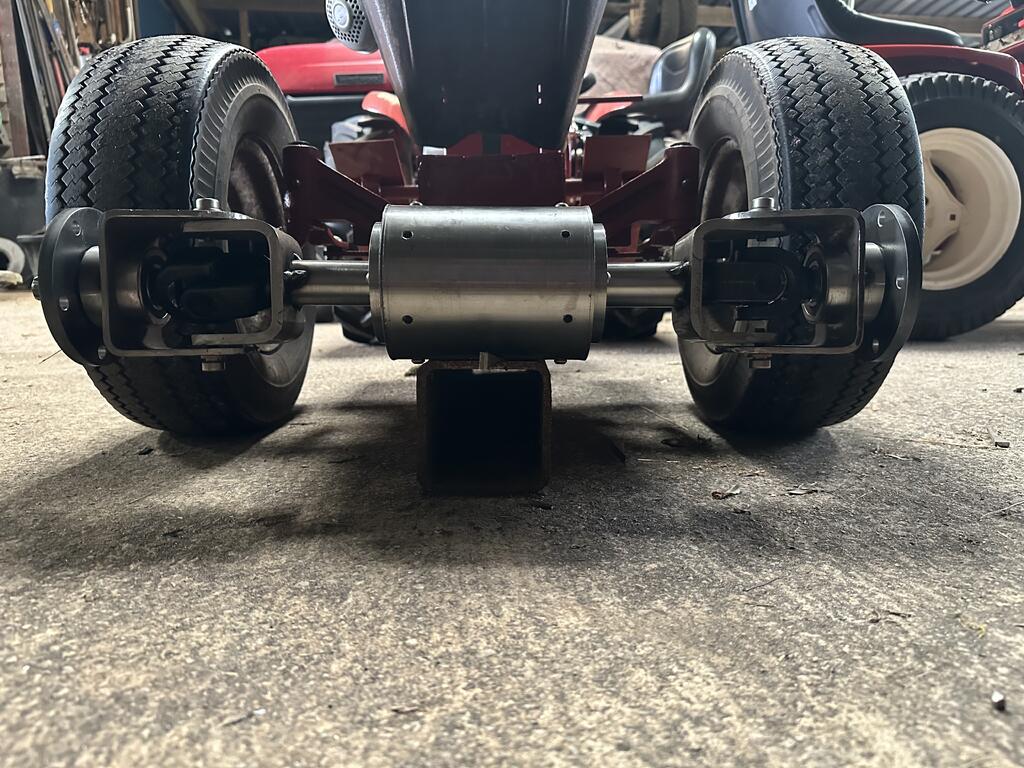

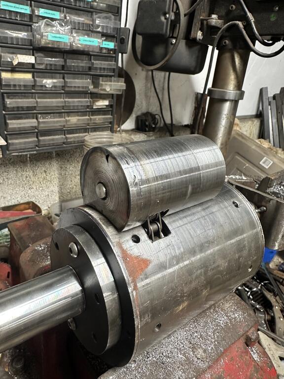

meadowfield 3,170 #1 Posted July 20 (edited) As I’ve always got so much time free and so many projects, the ideas as usual keep going round in my head. I’ve plans for quite a few designs and here is the next one that’s in design…. The little 400 is waiting for a hood and a paint job, in the meantime it might be getting an upgrade. hot on the heels of Ewan’s 704, I’ve a simpler idea to add 4 wheel drive to yet another Wheel Horse 😂 out comes the parts bucket, and the scrap pile is set to with an angle grinder, a welder and lathe! first stop a peerless transaxle diff with a sprocket added Then making a bearing carrier Shiny axle case Hub bearing and the start of the steering knuckle A finished swivel and UJ carrier, need to crack on with the other side! Edited July 20 by meadowfield 6 12 4 Share this post Link to post Share on other sites
ri702bill 12,837 #2 Posted July 20 Nice work. What keps the stub shaft located in the bearing sleeve? I do not see any snap rings... 1 Share this post Link to post Share on other sites

meadowfield 3,170 #6 Posted July 21 16 hours ago, ri702bill said: Nice work. What keps the stub shaft located in the bearing sleeve? I do not see any snap rings... I've a groove to cut when I make the drive hub and splines... 1 Share this post Link to post Share on other sites

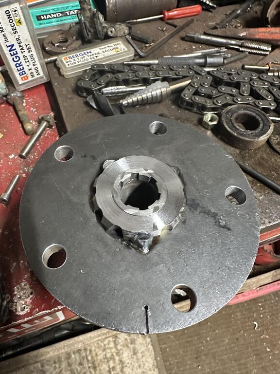

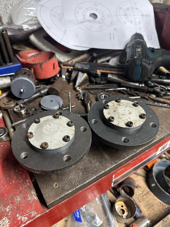

meadowfield 3,170 #7 Posted July 30 (edited) A little more progress…. drive flange complete - I made it the same PCD as my sons 4x4. (only tacked at the moment - just in case something needs to change) one side done Edited July 30 by meadowfield 9 1 Share this post Link to post Share on other sites

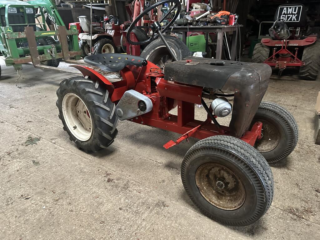

meadowfield 3,170 #8 Posted August 5 (edited) Axle just about done - well the hard bit both drive flanges, knuckles and drive shafts in. first offering - its the same track and pivot point as the suburban axle at 16" between centres. what it might look like Edited August 5 by meadowfield 1 8 1 Share this post Link to post Share on other sites

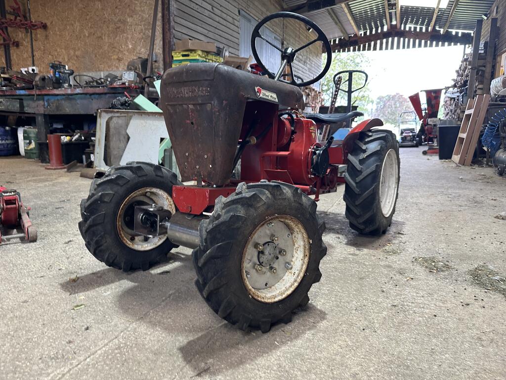

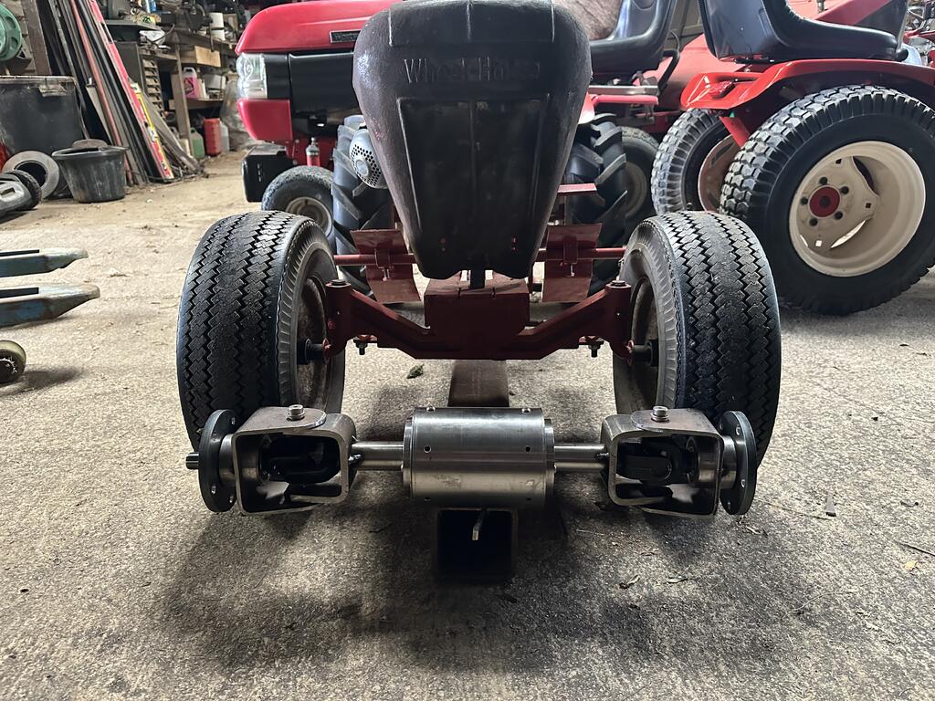

meadowfield 3,170 #9 Posted August 16 (edited) A bit more progress, hubs done, wheel adapters done and it bolted up in place. Looking good 😍 Edited August 16 by meadowfield 11 Share this post Link to post Share on other sites
wallfish 20,515 #10 Posted August 16 18 minutes ago, meadowfield said: and it bolted up in place. Looking good 😍 That does look good! 1 Share this post Link to post Share on other sites
adsm08 5,021 #11 Posted August 16 How are you planning to get power to the front? I see the drive sprocket, so I assume a chain drive of some sort. 1 Share this post Link to post Share on other sites
meadowfield 3,170 #12 Posted August 16 1 hour ago, adsm08 said: How are you planning to get power to the front? I see the drive sprocket, so I assume a chain drive of some sort. there’s an intermediate reduction at each end, I might do it all in chain! 2 Share this post Link to post Share on other sites
peter lena 10,018 #13 Posted August 16 @meadowfield WAIT, YOU CANNOT DO THAT ! its not in the book ! what are you thinking for power ? lovin it , pete Share this post Link to post Share on other sites
meadowfield 3,170 #14 Posted August 16 12 minutes ago, peter lena said: @meadowfield WAIT, YOU CANNOT DO THAT ! its not in the book ! what are you thinking for power ? lovin it , pete possibly a K161 or K181…. Might become a 1960 Suburban 800 4x4 4 Share this post Link to post Share on other sites

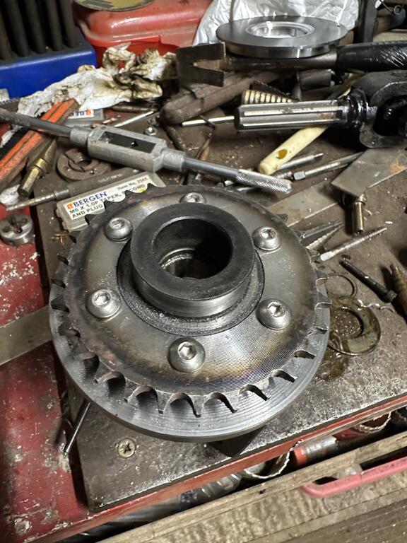

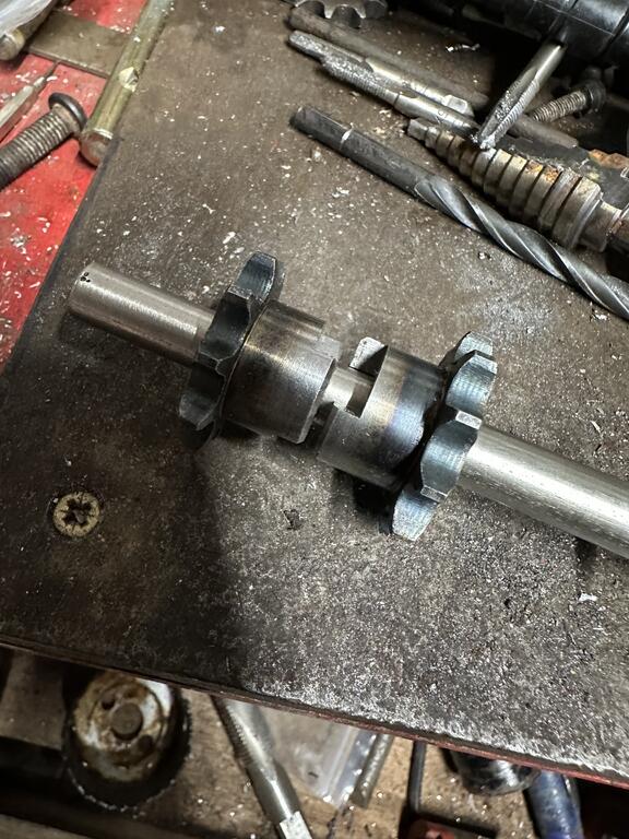

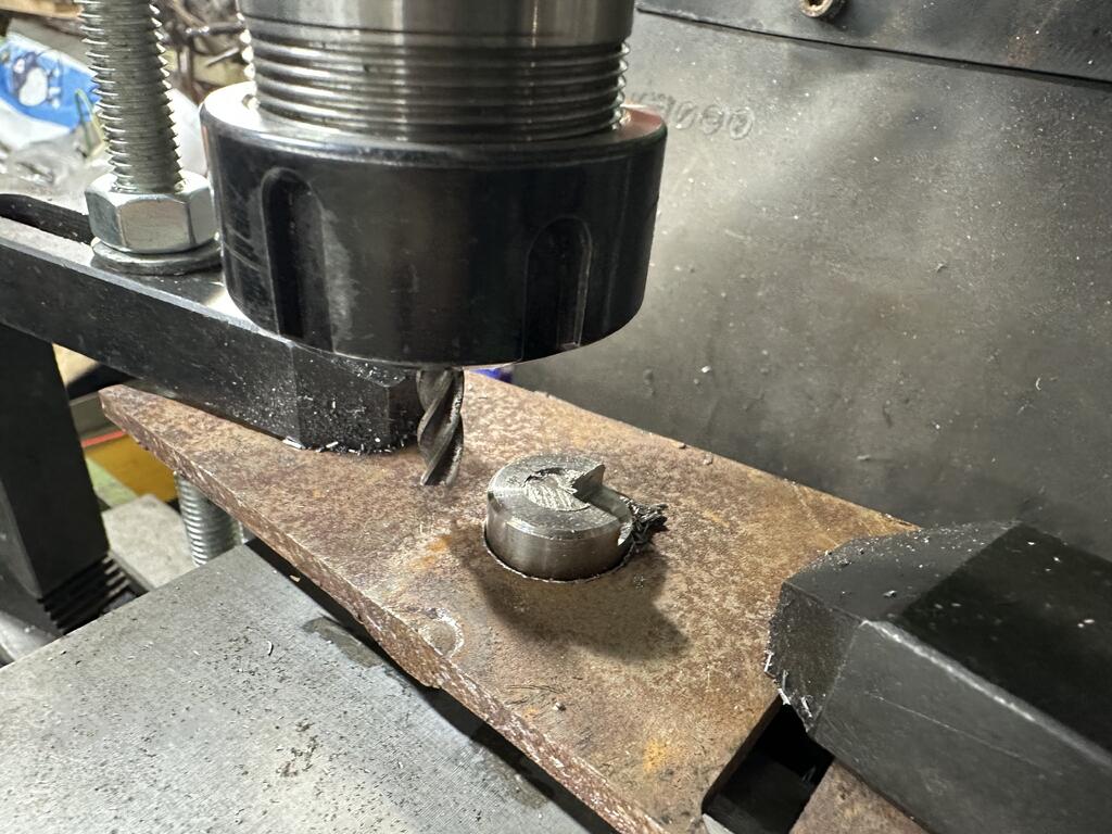

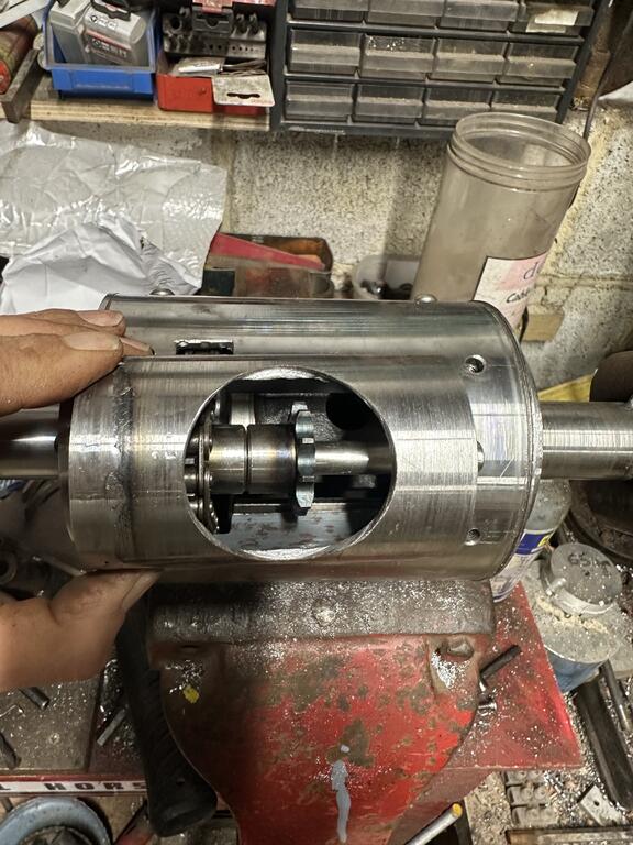

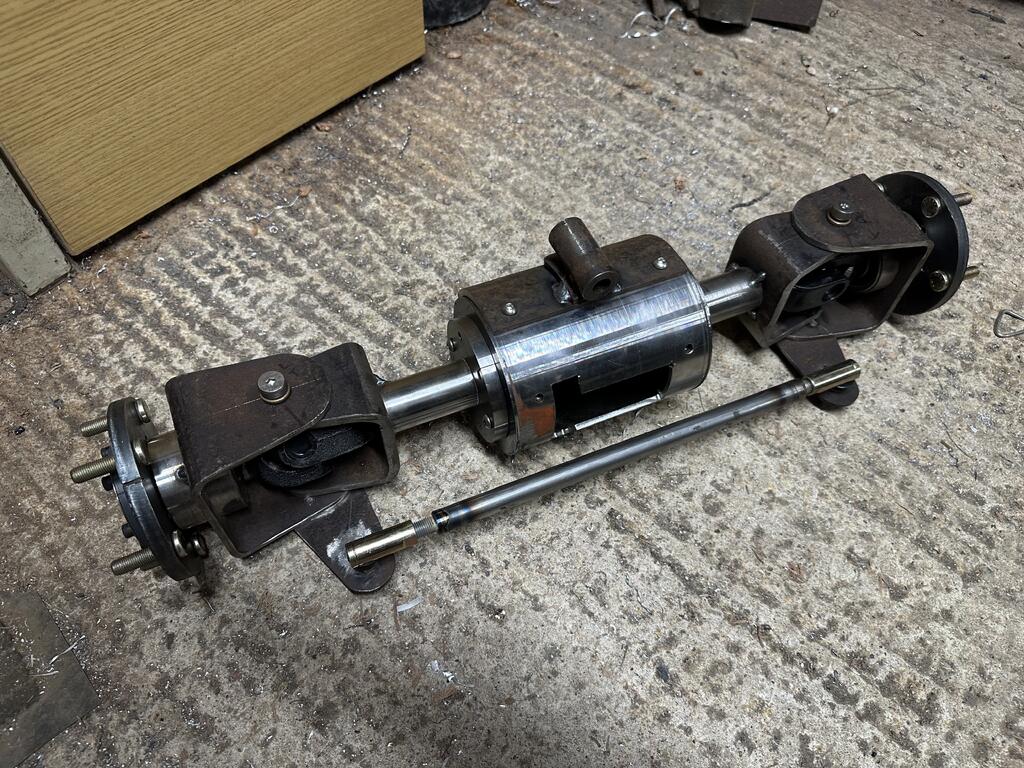

meadowfield 3,170 #16 Posted August 24 (edited) A bit more progress… Breaking out the drive First part of the intermediate drive and 4WD selector First view of the output My awesome son milling me the dog clutches on the gears out of gear in gear Axle with steering added - tie rod on the bottom as need to get the drive out, and a Suburban is a very low frame and pivot point. Edited August 24 by meadowfield 10 Share this post Link to post Share on other sites
AlexR 3,083 #17 Posted August 24 Incredible machining work!! 1 Share this post Link to post Share on other sites

peter lena 10,018 #21 Posted August 25 @meadowfield heim joints on steering rod ends ? very durable , also screw on , also use specific chain / cable lube lube , stays with it , like MACS CHAIN / CABEL LUBE , LOCAL AUTO [PARTS ? or similar , its also a great , creeping rustproofing . think your MINDSET , is on display here , always a WHAT IF ? phase , love that , rooting for you , stay at it , pete 1 Share this post Link to post Share on other sites

wallfish 20,515 #23 Posted August 26 On 8/24/2026 at 4:27 AM, meadowfield said: Axle with steering added Impressive. I'll take 2 of those please! 1 2 Share this post Link to post Share on other sites
meadowfield 3,170 #24 Posted August 26 7 hours ago, wallfish said: Impressive. I'll take 2 of those please! join the queue! 3 Share this post Link to post Share on other sites
