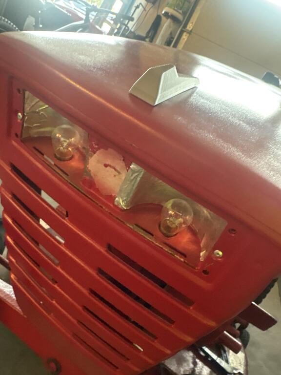

1968Commando 189 #1 Posted July 17 Are these headlights threaded? What screws or bolts do I need to hold the headlight lens on Share this post Link to post Share on other sites
Retired Wrencher 6,909 #2 Posted July 17 If you’re talking about the outer part or the lens screwed on it’s been a while if you go into your parts manual for the commando, you will see everything you need right down to what has everything together. We have a lot of manuals for us to use just take your time and find the one that fits your tractor. Share this post Link to post Share on other sites
gwest_ca-(File Mod) 12,429 #3 Posted July 17 Found one reference in a illustrated parts list. 6-32 thread by 3/8" long 2 Share this post Link to post Share on other sites
rjg854 13,285 #4 Posted July 17 I used the same screws you'd find in electrical covers for switches and outlets. They are the same thread, as long as someone else didn't try to use something else that boogered up the threads. Share this post Link to post Share on other sites
