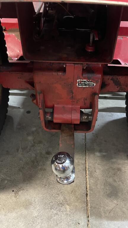

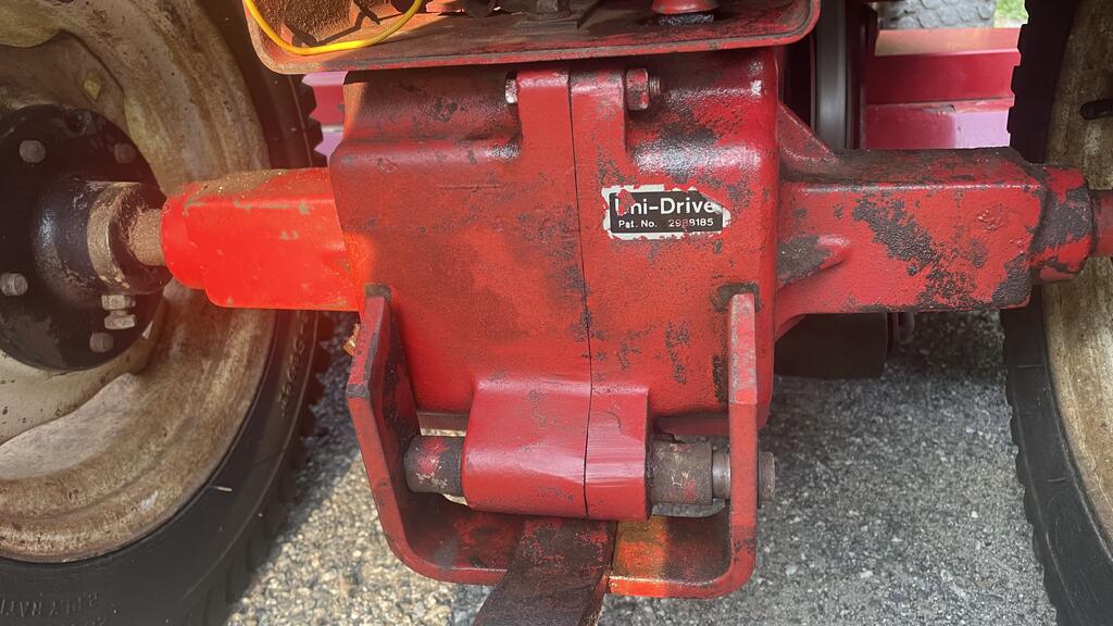

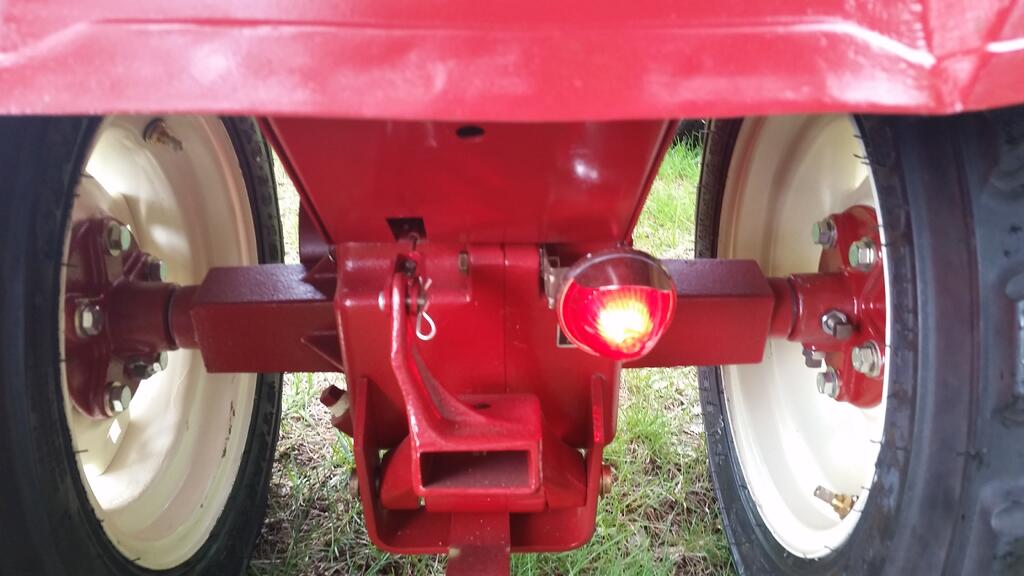

I only have a drawbar on both my WH’s. I’d like to have a clevis hitch or something similar to be able to use a plow or other implements even though I don’t have them yet. Trouble is I’m still fairly green to this whole scene so knowing what I need, options available or if it’s even feasible I do not know. I’ve searched a lot on here and see a lot of WH’s with lift cables or manual lifts and slot hitches and I gotta be honest I can’t figure out from pictures what I’d need or how it bolts up. Here’s a pic of the rear of the C160-8, as always any insight is certainly appreciated!

WHX??

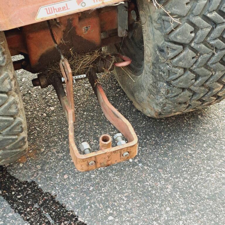

You need a slot hitch or a Brinly. Just remove the pin, take off the spacers and it will fit right in.

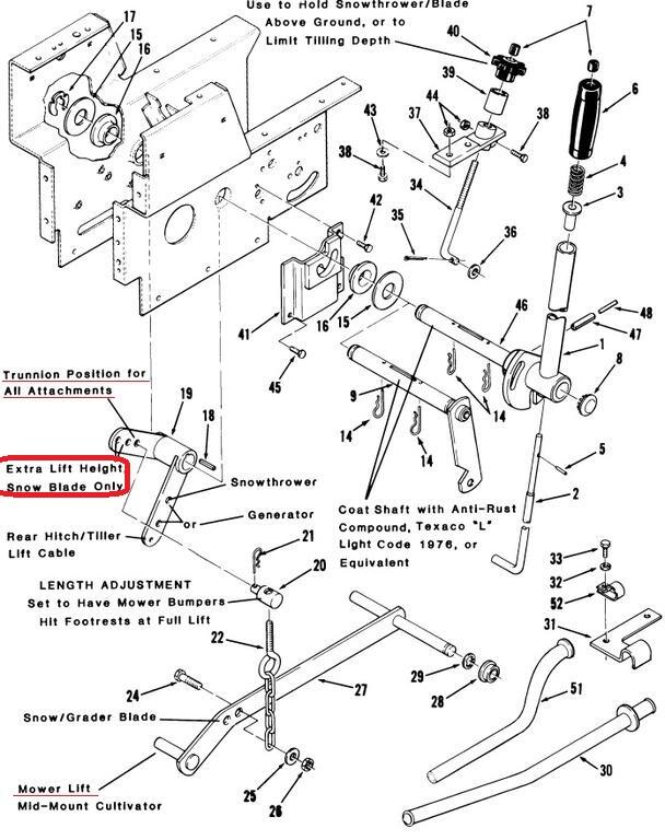

Looks like might need a lift cable or rockshaft depending on what you want to do. Not sure how/what is needed for a lift cable for a 160 but everything can be had at https://wheelhorsepartsandmore.com/ You may also have to lose the ball.
A Brinly is best for a  Brinly field plow.
Slot adapters can be had for a slot hitch.
I run a slot/draw bar combo on all my horses.

Others might be able to tell you for sure but it looks like you need a rockshaft to me

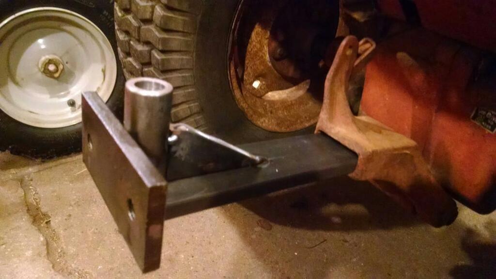

I made one of my sleeve hitches. Even making it back around 2018 I think it cost me around $60-70 in material to make one.
I also didn't need the rockshaft.
