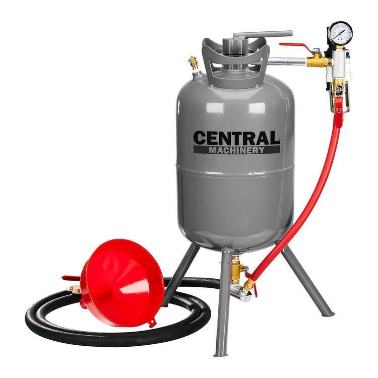

rmaynard 17,415 #2 Posted 5 hours ago This kind of blaster is okay, but there is a lot of waste. Placing a blanket or tarp behind your work helps catch your media. You must wear eye protection . Also, be careful to be sure that you turn off the air and bleed the tank before disconnecting any hose. I learned the hard way just today. I disconnected the pressure hose and there was still 120psi in the tank. I am not going to show how I sanded the back of my hand, just the bandage. 2 Share this post Link to post Share on other sites

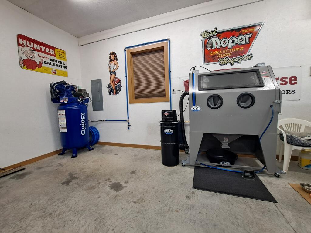

ri702bill 12,414 #4 Posted 5 hours ago (edited) we have 2 dedicated blasters. The tabletop unit is for fine work, and uses glass bead media. The larger floor cabinet is from Harbor Freight. Used for general sandblasting - we use coal slag from TSC in that one. Out of the box the HFT floor unit leaves a lot to be desired; we have done about a half dozen upgrades - well woth it. Most are available on YouTube. Edited 4 hours ago by ri702bill 1 Share this post Link to post Share on other sites
rmaynard 17,415 #5 Posted 4 hours ago 8 minutes ago, ri702bill said: .Out of the box the HFT floor unit leaves a lot to be desired; we have do about a half dozen upgrades - well woth it. Most are available on YouTube. Been there, done that. Some mods are better than others but they sure beat the out-of-the-box version. 1 Share this post Link to post Share on other sites

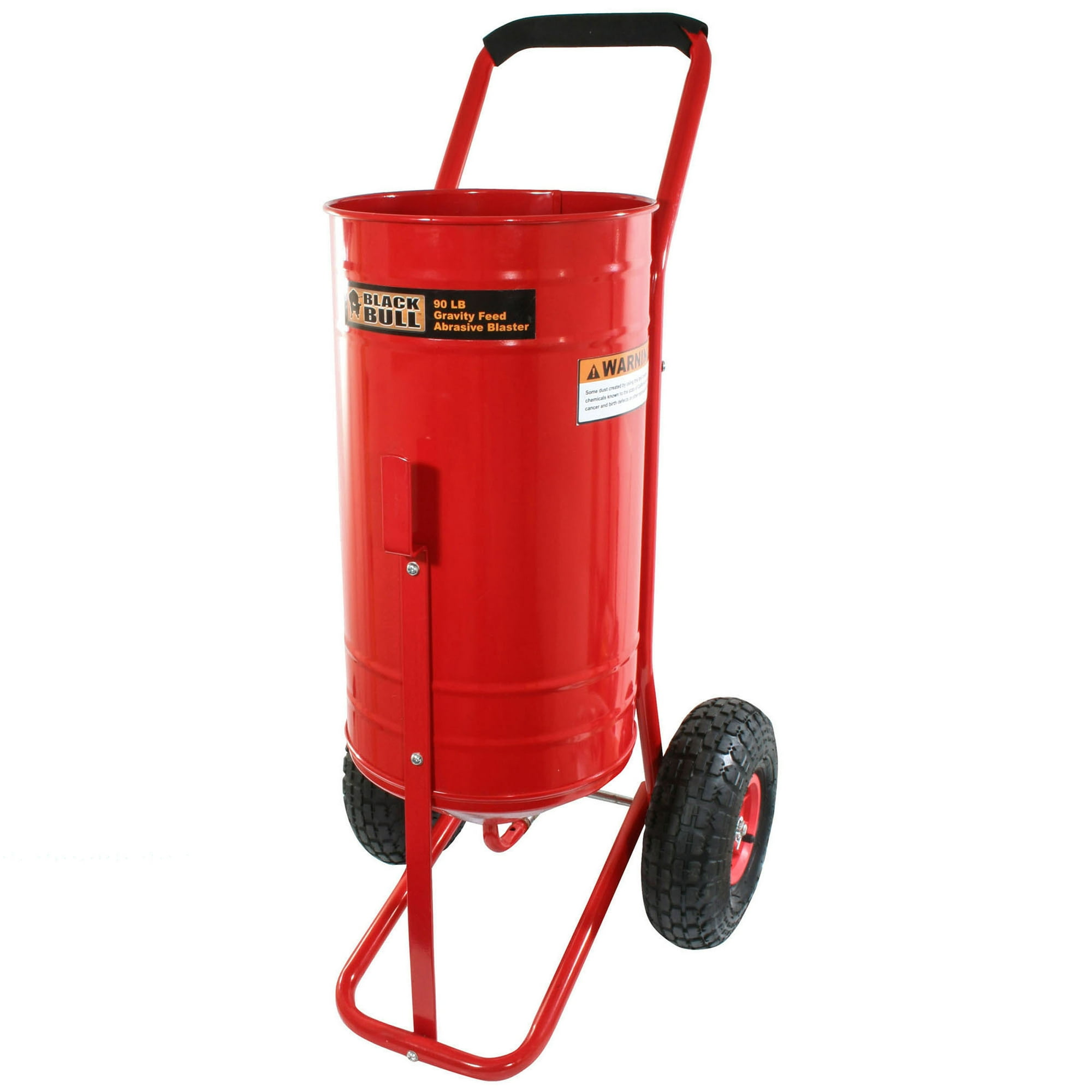

sqrlgtr 3,192 #7 Posted 4 hours ago I have this one and it works well but like mentioned above there is a lot of waste. I always thought a one-piece old shower would make a good way to catch the media while blasting but have never found one somebody was throwing out. Share this post Link to post Share on other sites

ri702bill 12,414 #9 Posted 3 hours ago 13 minutes ago, squonk said: An air compressor that can handle sandblasting is half the battle! Our 60 gallon 2HP Vertical can keep up with the glass bead unit, struggles to do about an 80% duty cycle on the larger one. The TP Tools gun was one of the cabinet upgrades. 1 Share this post Link to post Share on other sites
