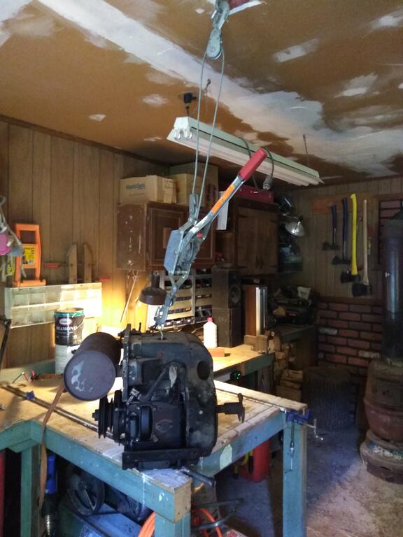

skippymud 2 #1 Posted July 12 Howdy Re: 1979 Kohler 10hp K241AQS, Spec 46740d, Serial 9883128 Re: Jacobsen garden tractor model 1000 with M/N 53201 & S/N 13722 Curious problem. Looking for feedback So I'm mowing the lawn at full RPM with PTO engaged, and suddenly the engine RPMs drop down to idle and stays there until I throttle down then throttle back up again which gives me full 3600 RPM but just for a short bit. Am I on-target by saying that the plastic Governor Gear is missing a tooth or teeth (P/N 47 042 02-S)? This would mean that I would have to pull the K241 - Ouch! Share this post Link to post Share on other sites

skippymud 2 #3 Posted July 12 Hello rmaynard Thanks for the feedback. I hear you on having to pull the engine for this. I've have had it on the table once to rebuild it some years ago. Heavy thing So if it is not the plastic governor gear, what else do you think it could it be? Share this post Link to post Share on other sites

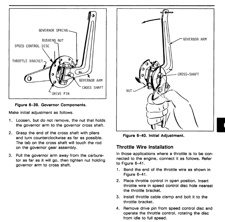

adsm08 5,006 #7 Posted July 18 On 7/13/2026 at 3:57 PM, rmaynard said: I'm just guessing, but it may be the external linkage or the cross-shaft slipping in the governor arm. Bob, which manual did this come from? I'm looking to check the governor adjustment on my own K241, but it doesn't look like this one. Share this post Link to post Share on other sites
wallfish 20,510 #8 Posted July 18 22 minutes ago, adsm08 said: Bob, which manual did this come from? I'm looking to check the governor adjustment on my own K241, but it doesn't look like this one. That illustration shows a smaller engine with the disk and spring behind the gov arm but the process is exactly the same for other K single cylinder engines. There are Kohler manuals for all of them in the files section. Share this post Link to post Share on other sites
adsm08 5,006 #9 Posted July 18 (edited) 12 hours ago, wallfish said: That illustration shows a smaller engine with the disk and spring behind the gov arm but the process is exactly the same for other K single cylinder engines. There are Kohler manuals for all of them in the files section. I was looking last night and didn't see anything about governor adjustments in any of the K241 documents. EDIT: My issue is not the governor. The throttle plate is wide open when this happens. Edited July 18 by adsm08 Share this post Link to post Share on other sites
wallfish 20,510 #10 Posted July 18 22 hours ago, adsm08 said: I'm looking to check the governor adjustment on my own K241, but it doesn't look like this one. Illustration 6-47 in this manual file below shows the same governor as a K241 Kohler K-Series SM TP-2379 LR.pdf 1 Share this post Link to post Share on other sites
adsm08 5,006 #11 Posted July 18 24 minutes ago, wallfish said: Illustration 6-47 in this manual file below shows the same governor as a K241 Kohler K-Series SM TP-2379 LR.pdf 6.35 MB · 0 downloads Well I determined this morning that the governor is holding the carb wide open when the engine slows down. So it's not the governor. Share this post Link to post Share on other sites
