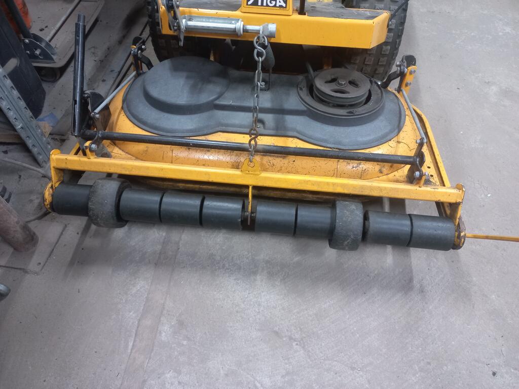

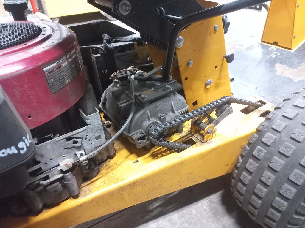

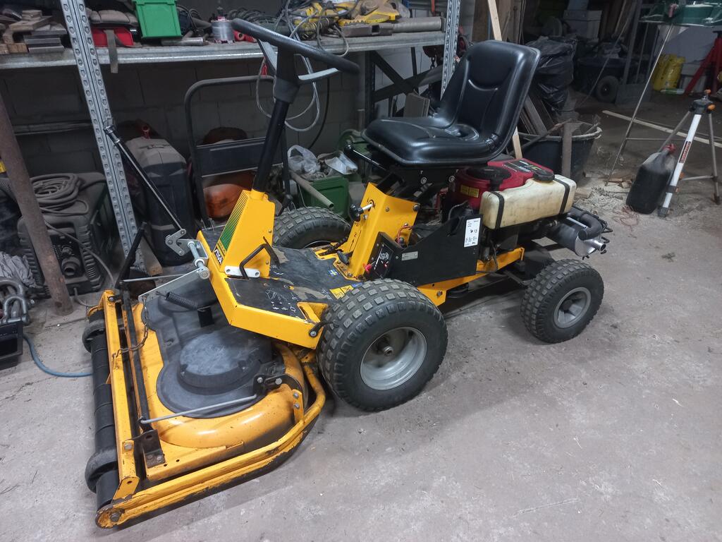

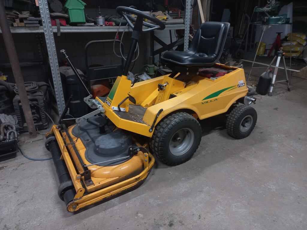

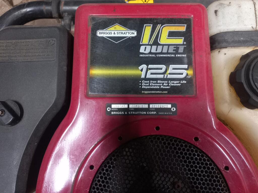

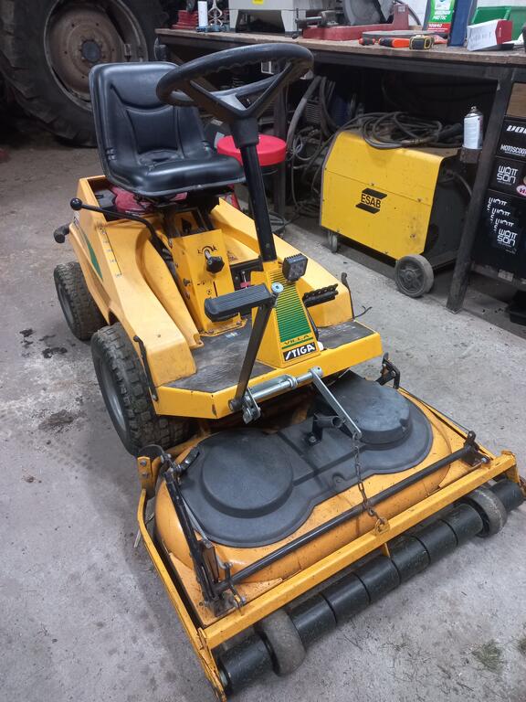

sjoemie himself 3,268 #1 Posted July 11 Hi all, So I know this might not be everyones' cup of tea but here we are. Since we moved houses and went from 700m2 (7500 sq/ft) to 10.000+m2 (~2.5 acre) we were in desperate need of some more serious mowing capacity. Since me ol' 512D is not in running order and/or even has a mowing deck I was on the lookout for something else. Since the budget is tight because we're renovating I set my goals on a sub 1000 bucks mower. Also it had to be a frontmower rather than a tractor for ease of use and the mowing deck had to be in good shape. After a looong time I found this 'beauty': Stiga Villa classic with 3 year old mowing deck for €400,-/~$450,-. Knowing that a new bare mowing deck alone costs about 300,- I did not hesitate. Not much to look at but does the job. Easy acces and simple construction. Simple gearbox and chaindrive, 1 reverse, 5 forward gears. Good ol' B&S 12,5 HP (Quiet I CANNOT agree with) Since buying it I changed the oil, sparkplug aircleaner(s) and added a new seat. After mowing two times it threw a belt so I replaced that aswell. Funny story about the front wheels and axle on the mowing deck.. they are almost always worn out, as were these. Although the wheels being plastic they had ground down the 16mm (5/8") shaft to about 10mm (~3/8"). So bought a set of new wheels which cost about $15 each and thought of buying a new axle. I mean how much could a piece of 5/8" x 3,5ft round bar possibly cost, right? Well, Stiga wanted $110,- for it Luckily our local 'tractor supply' sells C45 axle steel or 'silver steel' round stock by the metre which cost a whopping $6,50! Bought that, cut it to length, drilled and tapped an M8 hole on each end and re-assembled everything. Back to mowing again! Note: this was the before situation. Don't know why the wheels were'nt installed symmetrical here. 2 1 Share this post Link to post Share on other sites
T-Mo-(Moderator) 4,980 #2 Posted July 12 Interesting little machine. Those front rollers on the deck will probably be a deterrent, since they will be pushing the grass down where you won't get as good of a cut. 2 Share this post Link to post Share on other sites
sjoemie himself 3,268 #3 Posted July 12 10 hours ago, T-Mo said: Those front rollers on the deck Yeah I thought about leaving just the wheels and removing the rollers but we do have quite a few mole-hills (probably not the right word) around and it does a neat job of flattening them like this. So I think I'm gonna leave them on. Coming fall winter I'm probably replacing (the bearings of) the right spindle since it's a bit noisy and get the deck sandblasted and powdercoated for longer service life. Share this post Link to post Share on other sites

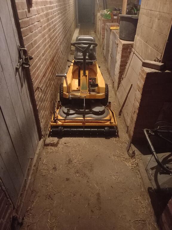

sjoemie himself 3,268 #4 Posted September 1 Well.. it was going well until it wasn't Was mowing and I stopped short of an immovable object, or objects I should say, a.k.a. pile of paving stones, went to grab reverse.. nothing.. put it in forward, slow creep.. no bueno. Turned the mower off and took a look underneath.. nothing too out of the ordinary. Only thing I could see was that the drivebelt for the deck had somehow twisted itself and now the flat side is running, or trying to run in the groove of the pulley but that shouldn't affect drive. Ran out of daylight today and have the day off tomorrow so I'll take a look at it when the suns out again. Parked it in the former stables for now. 2 Share this post Link to post Share on other sites

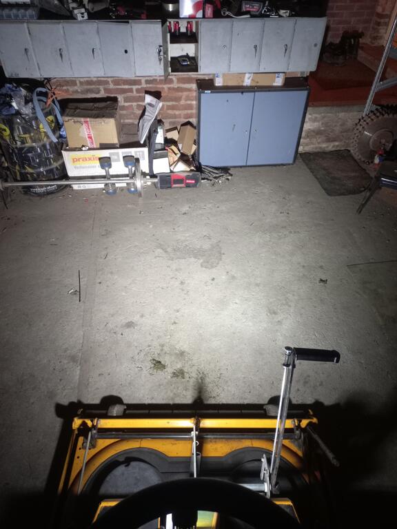

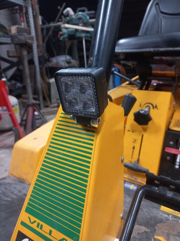

sjoemie himself 3,268 #5 Posted September 18 Update and fix: took a closer look at the mower and this time I noticed not only the belt from the mower deck twisted but the drive belt for driving also came off the pulley. It was riding on the engine shaft thus provided some driving capability.. put the belt back on, un-twisted the mowerdeck belt and it was good to go again. Mowed like a champ.. until.. I ran out of daylight Now I know mowing in the dark isn't the best option soo.. I added a light today. Not sure how useful this will really be but I guess we'll find out. Can you spot it? All 2" by 2" but also 1200lm. Small but mighty. Not bad for $10,- 4 Share this post Link to post Share on other sites
Handy Don 17,649 #6 Posted September 19 1200 well-focused lumens is a pretty serious light! 1 Share this post Link to post Share on other sites
sjoemie himself 3,268 #7 Posted September 24 Yes it is. I find it's always a bit of a gamble with lighting.. every lightsource is classified along lumens instead of watts these days. With incandescant bulbs brand A and brand B would produce very similar light as long as the wattage is the same. With LED and the lumens it's a different story.. Things like focal point, color temperature, wattage and lumens all have to be taken into account. On the plus side, if you've still got old school switches and wiring that work, you can have way more light on the same machine than what was there previously. 3 Share this post Link to post Share on other sites
