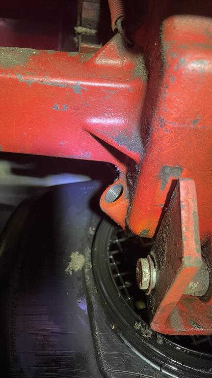

Fj40z 241 #1 Posted July 11 Sorry for the very basic question but I just drained the transmission on the C160. Should I fill from the top or with the small fill plug on the bottom left side? Also, if I do the kerosene flush should I add a full 2 quarts of kerosene before I briefly run it through the gears? Thanks!! Share this post Link to post Share on other sites
Fj40z 241 #2 Posted July 11 Plug in question. Seems straight forward but it just doesn’t look like the enough can be added utilizing this lower plug. Share this post Link to post Share on other sites
WHX?? 58,346 #3 Posted July 11 Just fill to the top of the plug it will be enough. 80/90 weight. No need to flush unless what comes out is milky. Take a pic of what comes out and we'll tell you if it needs flushing. Many of us like to jack the front up as high as safely possible. Another cup or so will come out "over the hump". 3 2 Share this post Link to post Share on other sites
ri702bill 13,303 #4 Posted July 11 (edited) If easily accessable, remove the shifter & boot and fill thru the hole on top. A good excuse to see if the boot needs to be replaced. That angled fill on the side is a carryover from the old 4 speed design that held 1-1/2 quarts.. You need to fill higher than that. Two quarts. As mentioned above - look at what comes out... not uncommon to see a milky mix of oil & water. Extreme cases - loose bearing needles, chips of gear teeth... Edited July 11 by ri702bill 2 2 Share this post Link to post Share on other sites
ebinmaine 81,116 #5 Posted July 11 (edited) 7 hours ago, WHX?? said: Just fill to the top of the plug it will be enough. 80/90 weight. Going by factory spec that's challenging for a 6 or 8 speed. That side fill will barely allow 1.5 qts. The fill quantity is 2 qts. Can the tractor be lifted from the left side >>safely<< enough to get the full amount in? Edited July 11 by ebinmaine 1 Share this post Link to post Share on other sites
sqrlgtr 4,172 #6 Posted July 11 11 hours ago, Fj40z said: Sorry for the very basic question but I just drained the transmission on the C160. Should I fill from the top or with the small fill plug on the bottom left side? Also, if I do the kerosene flush should I add a full 2 quarts of kerosene before I briefly run it through the gears? Thanks!! I thought all C160's had a dip stick but I may be wrong, if so, just go by marks on dip stick and fill through the dip stick hole. If no dip stick, I always try and fill through the shifter hole. If you can get at least 1 1/2 quart's in through the side plug, I wouldn't worry too much about it. I have had WH's that have had little to no oil or full of water that PO's have run like that for years . 1 Share this post Link to post Share on other sites
peter lena 10,105 #7 Posted July 11 @Fj40z always use , hi mileage atf fluid on my trans flushes , local , cul de sac nearby , use every gear / range , picture that fluid cleaning / showering fluid , put some miles / time on it , flushing it down to drainage area , also raise front end to enhance drainage , , like a new shift boot . lightly greased on the underside ? to enhance sliding over irregularities on top of trans , like a big tie wrap on shifter stick , to hold it in best staying place . regularly check over basics after any usage , engine oil / condition , trans check , top off tank , add sta bil fuel storage , fuel filters always clean clear , no fuel hose break down . regular for me , no issues , pete 1 Share this post Link to post Share on other sites
Fj40z 241 #8 Posted July 11 Thanks for all the helpful input gentlemen! I kept scratching my head at how on earth that fill plug being as low as it was would allow 2 quarts. It didn’t look like the dip stick would be getting down to that level at the full mark. I got it all finished up, I filled as much as I could in the fill plug on the lower left. I may have gotten about a quart in that way. I then went in with the rest through the dip stick hole. Would be such a breeze if I had the typical quart gear oil bottles, but I have a 5 gallon bucket of gear oil with a pump lid on it. Using that setup and having to be careful not to put too much in too fast was very time consuming. Pumping very slowly while allowing air to escape out the same was aggravating but not difficult. The oil that came out was not milky at all and pretty dang clean so I skipped the flush process. 2 1 Share this post Link to post Share on other sites
